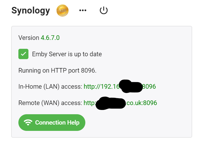

dao2009 3 Posted January 27, 2022 Posted January 27, 2022 Ok, searched google and this forum and I just can't see what I'm doing wrong: I'm trying to use https: to access EMBY from outside my network. I have a domain name from google - lets call it example.co.uk I have a Let's Encrypt cert - valid and recognised by google as being active on their dashboard I have ddns pointing to my home ip address I have converted my certificate to the required .pfx file format In ENBY: I have local ip address set I have http: port set to 8096 I have https: port set to 8920 I have external domain set (to example.co.uk0 I have custom SSL certificate path set correctly I have .pfx password set correctly In my router: I have port forward set up correctly pointing to my internal ip Now, from any external browser when I connect to EMBY and view the server dashboard settings I see In-Home (LAN) access: http:// internal ip:8096 Remote (WAN) access: http://example.co.uk:8096 My question is why wont it recognise the https://example.co.uk:8920 address? I can't for the life of me see where I've gone wrong Any help would be appreciated

dao2009 3 Posted January 27, 2022 Author Posted January 27, 2022 Ok, had someone access my computer and send me some screenshots.. Here they are I have secure connection mode set to required for all remote connections and restarted the EMBY server several times. My example.co.uk:8096 address works outside my network without a problem. At this point I'm thinking it's something to do with google but I'm not 100% sure
Solution Happy2Play 9801 Posted January 27, 2022 Solution Posted January 27, 2022 If your WAN does not populate HTTPS then there is a certificate issue, please restart Emby and post a server log.
dao2009 3 Posted January 27, 2022 Author Posted January 27, 2022 OK thanks guys... @Happy2Play: As you suggested it was the certificate. I scrapped the current certificate and re-did it, re-converted it and re-installed it and it now works. File must have gotten corrupted somewhere along the line. Never thought to re-do the cert. 1
