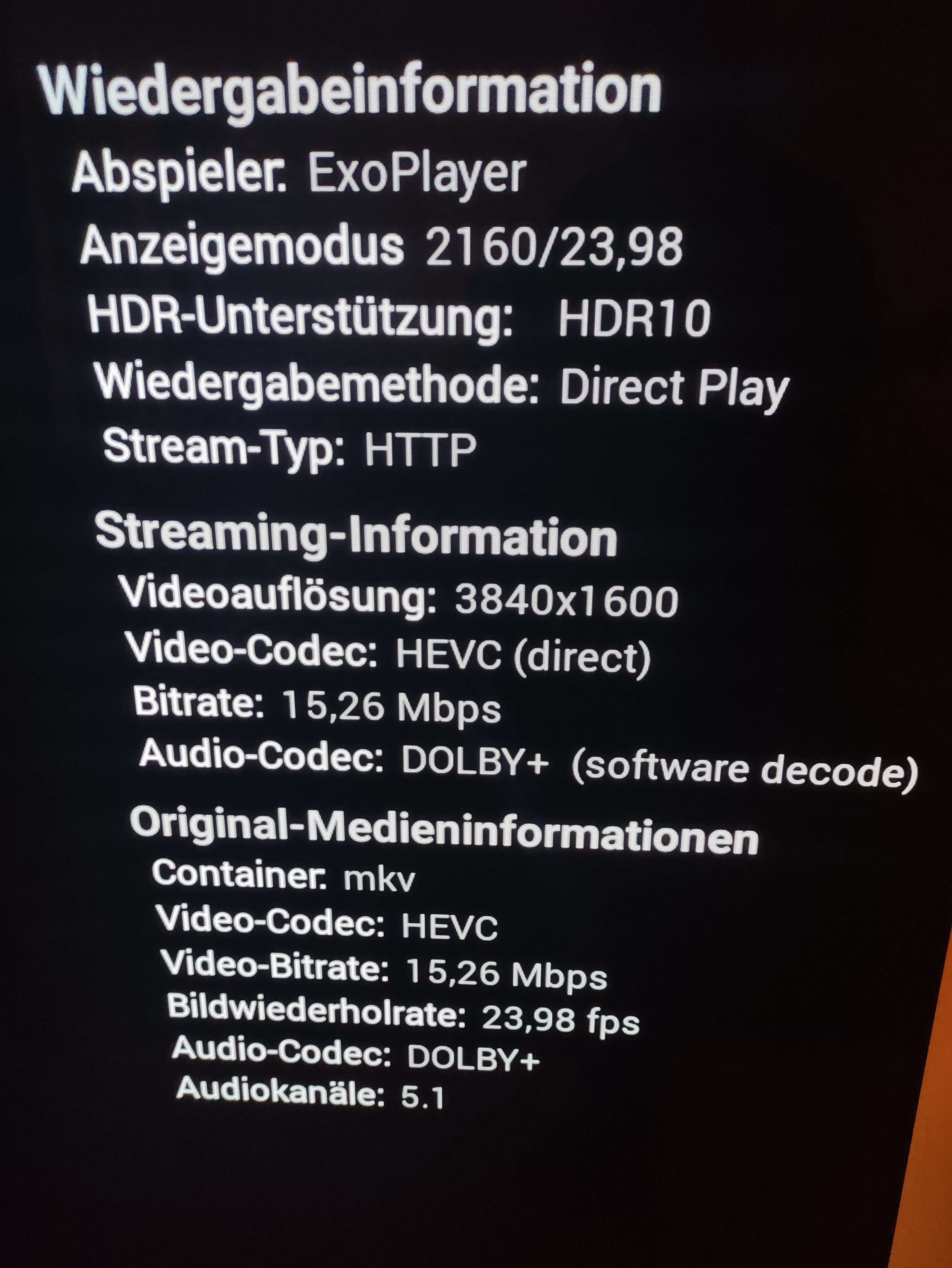

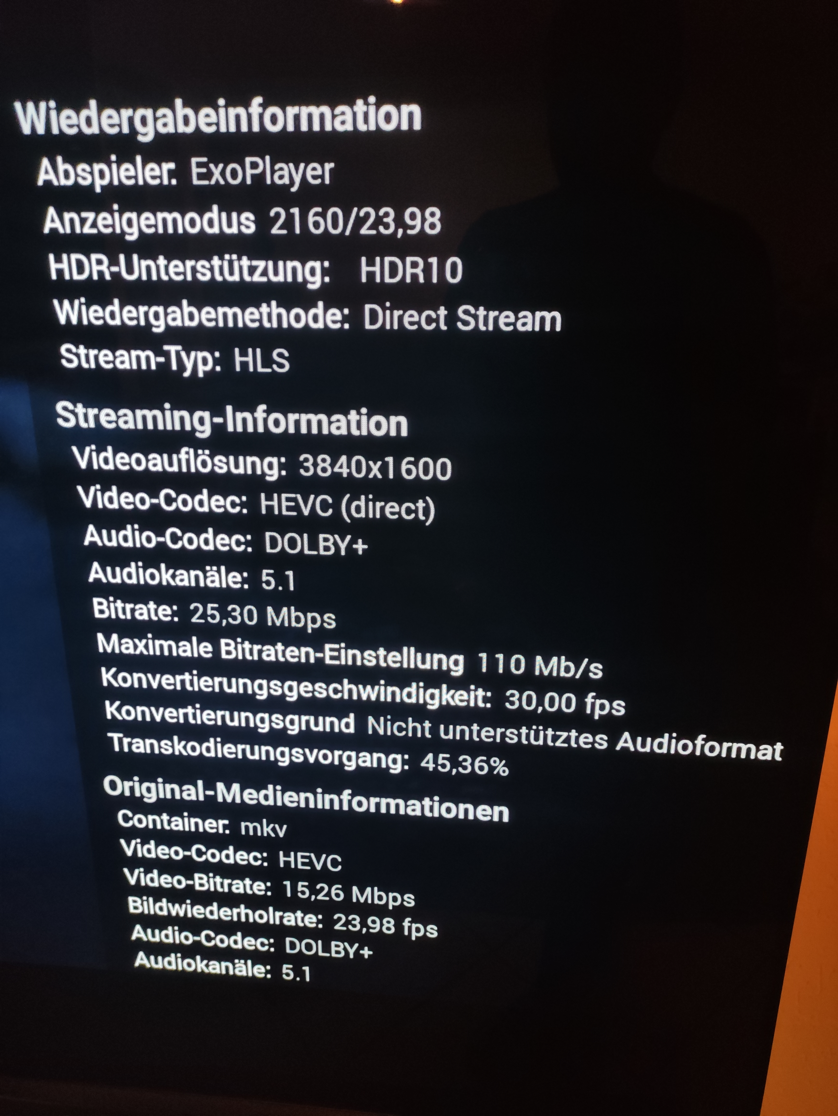

goenngoenn 2 Posted January 27, 2022 Author Posted January 27, 2022 (edited) 1 hour ago, ebr said: Can I please see an ffmpeg log example of that? Sure! First of all I noticed that when I leave Audio on Auto in the Emby Client settings it won't transcode at all and Play Dolby+ in Direct Play. Although my shield then outputs pcm to my soundbar. If I choose 'transcode not supported Codecs to dolby digital' it transcodes it to something, see 2nd picture but my shield still outputs pcm to my soundbar. The ffmpeg log is in the spoiler. Spoiler 2022-01-27 17:20:41.224 Operating System: Linux version 5.10.63-v7l+ (dom@buildbot) (arm-linux-gnueabihf-gcc-8 (Ubuntu/Linaro 8.4.0-3ubuntu1) 8.4.0, GNU ld (GNU Binutils for Ubuntu) 2.34) #145 OS/Process: arm/arm Emby Server version: 4.6.7.0 Operating system: Unix 5.10.63.7 Command Line: /app/emby/EmbyServer.dll -programdata /config -ffdetect /app/emby/ffdetect -ffmpeg /app/emby/ffmpeg -ffprobe /app/emby/ffprobe -restartexitcode 3 App: AndroidTv 2.0.48g SHIELD http://192.168.178.50:8096/emby/videos/8075/hls1/main/231.ts?DeviceId=a1fd381602c9cc23&MediaSourceId=19a04b45f3cd16c2391c40a0701253f6&PlaySessionId=786de54df3134abb945678602037c6ec&api_key=66d322ba4e9c446f89f25d0c4c0511a3&VideoCodec=h264,mpeg2video,hevc,h265&AudioCodec=aac_latm,mp4a_latm,ac3,dts,dca,dtshd,aac,mp3&VideoBitrate=109616000&AudioBitrate=384000&MaxHeight=2176&AudioStreamIndex=1&SubtitleStreamIndex=10&SubtitleMethod=Hls&CopyTimestamps=true&SegmentContainer=ts&MinSegments=2&AllowInterlacedVideoStreamCopy=True&BreakOnNonKeyFrames=True&ManifestSubtitles=vtt&h264-profile=high,main,baseline,constrainedbaseline,high10&h264-level=52&hevc-profile=Main,Main10&aac_latm-audiochannels=8&mp4a_latm-audiochannels=8&ac3-audiochannels=8&dts-audiochannels=8&dca-audiochannels=8&dtshd-audiochannels=8&aac-audiochannels=2&mp3-audiochannels=8&TranscodeReasons=AudioCodecNotSupported {"Protocol":"File","Id":"19a04b45f3cd16c2391c40a0701253f6","Path":"/data/movies/xy.mkv","Type":"Default","Container":"mkv","Size":11805454663,"Name":"xy","IsRemote":false,"RunTimeTicks":61869440000,"SupportsTranscoding":true,"SupportsDirectStream":true,"SupportsDirectPlay":true,"IsInfiniteStream":false,"RequiresOpening":false,"RequiresClosing":false,"RequiresLooping":false,"SupportsProbing":false,"MediaStreams":[{"Codec":"hevc","ColorTransfer":"smpte2084","ColorPrimaries":"bt2020","ColorSpace":"bt2020nc","TimeBase":"1/1000","CodecTimeBase":"1001/24000","VideoRange":"HDR10","DisplayTitle":"4K HEVC HDR10","IsInterlaced":false,"BitRate":15264989,"BitDepth":10,"RefFrames":1,"IsDefault":true,"IsForced":false,"Height":1600,"Width":3840,"AverageFrameRate":23.976025,"RealFrameRate":23.976025,"Profile":"Main 10","Type":"Video","AspectRatio":"2.40:1","Index":0,"IsExternal":false,"IsTextSubtitleStream":false,"SupportsExternalStream":false,"Protocol":"File","PixelFormat":"yuv420p10le","Level":150,"IsAnamorphic":false},{"Codec":"eac3","Language":"eng","TimeBase":"1/1000","CodecTimeBase":"1/48000","Title":"DDP 5.1","DisplayTitle":"English EAC3 6 ch (Default)","DisplayLanguage":"English","IsInterlaced":false,"Channels":6,"SampleRate":48000,"IsDefault":true,"IsForced":false,"Type":"Audio","Index":1,"IsExternal":false,"IsTextSubtitleStream":false,"SupportsExternalStream":false,"Protocol":"File"},{"Codec":"subrip","Language":"eng","TimeBase":"1/1000","CodecTimeBase":"0/1","Title":"FORCED","DisplayTitle":"English (Default Forced SUBRIP)","DisplayLanguage":"English","IsInterlaced":false,"IsDefault":true,"IsForced":true,"Type":"Subtitle","Index":2,"IsExternal":false,"IsTextSubtitleStream":true,"SupportsExternalStream":true,"Protocol":"File"},{"Codec":"subrip","Language":"eng","TimeBase":"1/1000","CodecTimeBase":"0/1","DisplayTitle":"English (SUBRIP)","DisplayLanguage":"English","IsInterlaced":false,"IsDefault":false,"IsForced":false,"Type":"Subtitle","Index":3,"IsExternal":false,"IsTextSubtitleStream":true,"SupportsExternalStream":true,"Protocol":"File"},{"Codec":"subrip","Language":"eng","TimeBase":"1/1000","CodecTimeBase":"0/1","Title":"SDH","DisplayTitle":"English (SUBRIP)","DisplayLanguage":"English","IsInterlaced":false,"IsDefault":false,"IsForced":false,"Type":"Subtitle","Index":4,"IsExternal":false,"IsTextSubtitleStream":true,"SupportsExternalStream":true,"Protocol":"File"},{"Codec":"mjpeg","ColorSpace":"bt470bg","TimeBase":"1/90000","CodecTimeBase":"0/1","IsInterlaced":false,"BitDepth":8,"RefFrames":1,"IsDefault":false,"IsForced":false,"Height":176,"Width":120,"RealFrameRate":90000,"Profile":"Baseline","Type":"EmbeddedImage","AspectRatio":"15:22","Index":5,"IsExternal":false,"IsTextSubtitleStream":false,"SupportsExternalStream":false,"Protocol":"File","PixelFormat":"yuvj444p","Level":-99},{"Codec":"mjpeg","ColorSpace":"bt470bg","TimeBase":"1/90000","CodecTimeBase":"0/1","IsInterlaced":false,"BitDepth":8,"RefFrames":1,"IsDefault":false,"IsForced":false,"Height":120,"Width":213,"RealFrameRate":90000,"Profile":"Baseline","Type":"EmbeddedImage","AspectRatio":"71:40","Index":6,"IsExternal":false,"IsTextSubtitleStream":false,"SupportsExternalStream":false,"Protocol":"File","PixelFormat":"yuvj444p","Level":-99},{"Codec":"mjpeg","ColorSpace":"bt470bg","TimeBase":"1/90000","CodecTimeBase":"0/1","IsInterlaced":false,"BitDepth":8,"RefFrames":1,"IsDefault":false,"IsForced":false,"Height":882,"Width":600,"RealFrameRate":90000,"Profile":"Baseline","Type":"EmbeddedImage","AspectRatio":"100:147","Index":7,"IsExternal":false,"IsTextSubtitleStream":false,"SupportsExternalStream":false,"Protocol":"File","PixelFormat":"yuvj444p","Level":-99},{"Codec":"mjpeg","ColorSpace":"bt470bg","TimeBase":"1/90000","CodecTimeBase":"0/1","IsInterlaced":false,"BitDepth":8,"RefFrames":1,"IsDefault":false,"IsForced":false,"Height":600,"Width":1067,"RealFrameRate":90000,"Profile":"Baseline","Type":"EmbeddedImage","AspectRatio":"1067:600","Index":8,"IsExternal":false,"IsTextSubtitleStream":false,"SupportsExternalStream":false,"Protocol":"File","PixelFormat":"yuvj444p","Level":-99},{"Codec":"srt","Language":"ger","DisplayTitle":"German (SRT)","DisplayLanguage":"German","IsInterlaced":false,"IsDefault":false,"IsForced":false,"Type":"Subtitle","Index":9,"IsExternal":true,"IsTextSubtitleStream":true,"SupportsExternalStream":true,"Path":"/data/movies/10plus.DDP5.1-SWTYBLZ.de.srt","Protocol":"File"},{"Codec":"srt","Language":"eng","DisplayTitle":"English (SRT)","DisplayLanguage":"English","IsInterlaced":false,"IsDefault":false,"IsForced":false,"Type":"Subtitle","Index":10,"IsExternal":true,"IsTextSubtitleStream":true,"SupportsExternalStream":true,"Path":"/data/movies/s.DDP5.1-SWTYBLZ.en.srt","Protocol":"File"}],"Formats":[],"Bitrate":15264989,"RequiredHttpHeaders":{},"ReadAtNativeFramerate":false} >>>>>> User policy for admin EnablePlaybackRemuxing: True EnableVideoPlaybackTranscoding: False EnableAudioPlaybackTranscoding: False >>>>>> Processing Plan Info Name CanDoInHardware WillDoInHardware Reason Info Copy video stream >> False False Software Codec Info VideoInput >> False False Not a hardware decoder Info VideoOutput >> False False Not a hardware encoder Info Copy video stream >> False False Software Codec >>>>>> Projected Processing Formats Info Previous HW-Context Format SW-Format Size Next Info hevc >> - yuv420p10 yuv420p10 3840x1600 >> /app/emby/ffmpeg -loglevel +timing -y -print_graphs_file "/config/logs/ffmpeg-directstream-bf362b90-99e7-45ab-b682-3dad3ac972a8_1graph.txt" -copyts -start_at_zero -f matroska,webm -ss 00:23:06.000 -noaccurate_seek -c:v:0 hevc -c:v:1 mjpeg -c:v:2 mjpeg -c:v:3 mjpeg -c:v:4 mjpeg -i "/data/DL.x265.10bit.HDR10plus.DDP5.1-SWTYBLZ.mkv" -map 0:0 -map 0:1 -sn -c:v:0 copy -c:a:0 copy -metadata:s:a:0 language=eng -disposition:a:0 default -copypriorss:a:0 0 -max_delay 5000000 -avoid_negative_ts disabled -f segment -map_metadata -1 -map_chapters -1 -segment_format mpegts -segment_list "/config/transcoding-temp/5ECEF5.m3u8" -segment_list_type m3u8 -segment_time 6 -segment_time_delta -00:23:06.000 -segment_start_number 231 -break_non_keyframes 1 -individual_header_trailer 0 -write_header_trailer 0 -segment_write_temp 1 "/config/transcoding-temp/5ECEF5_%d.ts" -map 0:2 -map 0:0 -an -c:v:0 copy -c:s:0 webvtt -max_delay 5000000 -avoid_negative_ts disabled -f segment -map_metadata -1 -map_chapters -1 -segment_format webvtt -segment_list "/config/transcoding-temp/5ECEF5_s2.m3u8" -segment_list_type m3u8 -segment_time 6 -segment_start_number 231 -break_non_keyframes 1 -individual_header_trailer 1 -write_header_trailer 0 -write_empty_segments 1 -segment_write_temp 1 -min_frame_time 00:23:06.000 "/config/transcoding-temp/5ECEF5_s2_%d.vtt" -map 0:3 -map 0:0 -an -c:v:0 copy -c:s:0 webvtt -max_delay 5000000 -avoid_negative_ts disabled -f segment -map_metadata -1 -map_chapters -1 -segment_format webvtt -segment_list "/config/transcoding-temp/5ECEF5_s3.m3u8" -segment_list_type m3u8 -segment_time 6 -segment_start_number 231 -break_non_keyframes 1 -individual_header_trailer 1 -write_header_trailer 0 -write_empty_segments 1 -segment_write_temp 1 -min_frame_time 00:23:06.000 "/config/transcoding-temp/5ECEF5_s3_%d.vtt" -map 0:4 -map 0:0 -an -c:v:0 copy -c:s:0 webvtt -max_delay 5000000 -avoid_negative_ts disabled -f segment -map_metadata -1 -map_chapters -1 -segment_format webvtt -segment_list "/config/transcoding-temp/5ECEF5_s4.m3u8" -segment_list_type m3u8 -segment_time 6 -segment_start_number 231 -break_non_keyframes 1 -individual_header_trailer 1 -write_header_trailer 0 -write_empty_segments 1 -segment_write_temp 1 -min_frame_time 00:23:06.000 "/config/transcoding-temp/5ECEF5_s4_%d.vtt" 17:20:41.264 ffmpeg version 4.3.0-emby_2021_02_27 Copyright (c) 2000-2021 the FFmpeg developers and softworkz for Emby LLC 17:20:41.265 built with gcc 8.3.0 (crosstool-NG 1.24.0) 17:20:41.265 Execution Date: 2022-01-27 17:20:41 17:20:41.367 Guessed Channel Layout for Input Stream #0.1 : 5.1 17:20:41.368 Input #0, matroska,webm, from '/data/movies/DDP5.1-SWTYBLZ.mkv': 17:20:41.368 Metadata: 17:20:41.368 title : 17:20:41.368 encoder : libebml v1.4.1 + libmatroska v1.6.2 17:20:41.369 creation_time : 2021-02-16T13:11:24.000000Z 17:20:41.369 Duration: 01:43:06.94, start: 0.000000, bitrate: 15264 kb/s 17:20:41.370 Stream #0:0: Video: hevc (Main 10), yuv420p10le(tv, bt2020nc/bt2020/smpte2084), 3840x1600 [SAR 1:1 DAR 12:5], Level 150, 23.98 fps, 23.98 tbr, 1k tbn, 23.98 tbc (default) 17:20:41.370 Metadata: 17:20:41.371 BPS-eng : 14622737 17:20:41.371 DURATION-eng : 01:43:06.931000000 17:20:41.371 NUMBER_OF_FRAMES-eng: 148338 17:20:41.371 NUMBER_OF_BYTES-eng: 11308733305 17:20:41.371 Stream #0:1(eng): Audio: eac3, 48000 Hz, 5.1, fltp (default) 17:20:41.372 Metadata: 17:20:41.372 title : DDP 5.1 17:20:41.372 BPS-eng : 640000 17:20:41.372 DURATION-eng : 01:43:06.944000000 17:20:41.372 NUMBER_OF_FRAMES-eng: 193342 17:20:41.373 NUMBER_OF_BYTES-eng: 494955520 17:20:41.373 Stream #0:2(eng): Subtitle: subrip (default) (forced) 17:20:41.373 Metadata: 17:20:41.374 title : FORCED 17:20:41.374 BPS-eng : 0 17:20:41.374 DURATION-eng : 00:43:44.927000000 17:20:41.374 NUMBER_OF_FRAMES-eng: 7 17:20:41.374 NUMBER_OF_BYTES-eng: 172 17:20:41.375 Stream #0:3(eng): Subtitle: subrip 17:20:41.375 Metadata: 17:20:41.375 BPS-eng : 19 17:20:41.375 DURATION-eng : 01:29:38.895000000 17:20:41.375 NUMBER_OF_FRAMES-eng: 515 17:20:41.375 NUMBER_OF_BYTES-eng: 12882 17:20:41.376 Stream #0:4(eng): Subtitle: subrip 17:20:41.376 Metadata: 17:20:41.376 title : SDH 17:20:41.376 BPS-eng : 25 17:20:41.376 DURATION-eng : 01:42:05.728000000 17:20:41.377 NUMBER_OF_FRAMES-eng: 986 17:20:41.377 NUMBER_OF_BYTES-eng: 19624 17:20:41.377 Stream #0:5: Video: mjpeg (Baseline), yuvj444p(pc, bt470bg/unknown/unknown), 120x176, 90k tbr, 90k tbn, 90k tbc (attached pic) 17:20:41.377 Metadata: 17:20:41.377 filename : small_cover.jpg 17:20:41.377 mimetype : image/jpeg 17:20:41.377 Stream #0:6: Video: mjpeg (Baseline), yuvj444p(pc, bt470bg/unknown/unknown), 213x120, 90k tbr, 90k tbn, 90k tbc (attached pic) 17:20:41.378 Metadata: 17:20:41.378 filename : small_cover_land.jpg 17:20:41.378 mimetype : image/jpeg 17:20:41.378 Stream #0:7: Video: mjpeg (Baseline), yuvj444p(pc, bt470bg/unknown/unknown), 600x882, 90k tbr, 90k tbn, 90k tbc (attached pic) 17:20:41.378 Metadata: 17:20:41.378 filename : cover.jpg 17:20:41.378 mimetype : image/jpeg 17:20:41.378 Stream #0:8: Video: mjpeg (Baseline), yuvj444p(pc, bt470bg/unknown/unknown), 1067x600, 90k tbr, 90k tbn, 90k tbc (attached pic) 17:20:41.378 Metadata: 17:20:41.378 filename : cover_land.jpg 17:20:41.378 mimetype : image/jpeg 17:20:41.379 Output #0, segment, to '/config/transcoding-temp/5ECEF5_%d.ts': 17:20:41.380 Metadata: 17:20:41.380 encoder : Lavf58.35.100 17:20:41.380 Stream #0:0: Video: hevc (Main 10), yuv420p10le(tv, bt2020nc/bt2020/smpte2084), 3840x1600 [SAR 1:1 DAR 12:5], q=2-31, Level 150, 23.98 fps, 23.98 tbr, 90k tbn, 23.98 tbc (default) 17:20:41.380 Stream #0:1(eng): Audio: eac3, 48000 Hz, 5.1, fltp (default) 17:20:41.381 Output #1, segment, to '/config/transcoding-temp/5ECEF5_s2_%d.vtt': 17:20:41.381 Metadata: 17:20:41.381 encoder : Lavf58.35.100 17:20:41.381 Stream #1:0: Subtitle: webvtt (default) (forced) 17:20:41.381 Metadata: 17:20:41.381 encoder : Lavc58.62.100 webvtt 17:20:41.382 Stream #1:1: Video: hevc (Main 10), yuv420p10le(tv, bt2020nc/bt2020/smpte2084), 3840x1600 [SAR 1:1 DAR 12:5], q=2-31, Level 150, 23.98 fps, 23.98 tbr, 23.98 tbn, 23.98 tbc (default) 17:20:41.384 Output #2, segment, to '/config/transcoding-temp/5ECEF5_s3_%d.vtt': 17:20:41.384 Metadata: 17:20:41.384 encoder : Lavf58.35.100 17:20:41.384 Stream #2:0: Subtitle: webvtt 17:20:41.384 Metadata: 17:20:41.384 encoder : Lavc58.62.100 webvtt 17:20:41.384 Stream #2:1: Video: hevc (Main 10), yuv420p10le(tv, bt2020nc/bt2020/smpte2084), 3840x1600 [SAR 1:1 DAR 12:5], q=2-31, Level 150, 23.98 fps, 23.98 tbr, 23.98 tbn, 23.98 tbc (default) 17:20:41.385 Output #3, segment, to '/config/transcoding-temp/5ECEF5_s4_%d.vtt': 17:20:41.385 Metadata: 17:20:41.385 encoder : Lavf58.35.100 17:20:41.385 Stream #3:0: Subtitle: webvtt 17:20:41.385 Metadata: 17:20:41.385 encoder : Lavc58.62.100 webvtt 17:20:41.385 Stream #3:1: Video: hevc (Main 10), yuv420p10le(tv, bt2020nc/bt2020/smpte2084), 3840x1600 [SAR 1:1 DAR 12:5], q=2-31, Level 150, 23.98 fps, 23.98 tbr, 23.98 tbn, 23.98 tbc (default) 17:20:41.385 Stream mapping: 17:20:41.385 Stream #0:0 -> #0:0 (copy) 17:20:41.385 Stream #0:1 -> #0:1 (copy) 17:20:41.385 Stream #0:2 -> #1:0 (subrip (srt) -> webvtt (native)) 17:20:41.385 Stream #0:0 -> #1:1 (copy) 17:20:41.385 Stream #0:3 -> #2:0 (subrip (srt) -> webvtt (native)) 17:20:41.385 Stream #0:0 -> #2:1 (copy) 17:20:41.385 Stream #0:4 -> #3:0 (subrip (srt) -> webvtt (native)) 17:20:41.385 Stream #0:0 -> #3:1 (copy) 17:20:41.385 Press [q] to stop, [?] for help 17:20:41.537 [segment @ 0xdf27f0] Opening '/config/transcoding-temp/5ECEF5.m3u8.tmp' for writing 17:20:41.539 SegmentComplete=video:0 Index=231 Start=0.000000 End=1391.890000 Duration=1391.890000 offset_pts=0 start_pts=0 Frames=156 filename=5ECEF5_231.ts 17:20:41.539 [segment @ 0xdf27f0] Opening '/config/transcoding-temp/5ECEF5_232.ts.tmp' for writing 17:20:41.648 [segment @ 0xe25290] Opening '/config/transcoding-temp/5ECEF5_s4.m3u8.tmp' for writing 17:20:41.649 SegmentComplete=video:1 Index=231 Start=0.000000 End=1391.890500 Duration=1391.890500 offset_pts=0 start_pts=0 Frames=156 filename=5ECEF5_s4_231.vtt 17:20:41.649 [segment @ 0xe25290] Opening '/config/transcoding-temp/5ECEF5_s4_232.vtt.tmp' for writing 17:20:41.712 [segment @ 0xdf27f0] Opening '/config/transcoding-temp/5ECEF5.m3u8.tmp' for writing 17:20:43.265 SegmentComplete=video:0 Index=232 Start=1392.057000 End=1398.021000 Duration=5.964000 offset_pts=0 start_pts=1392057000 Frames=147 filename=5ECEF5_232.ts 17:20:43.265 [segment @ 0xdf27f0] Opening '/config/transcoding-temp/5ECEF5_233.ts.tmp' for writing 17:20:43.266 [segment @ 0xe25290] Opening '/config/transcoding-temp/5ECEF5_s4.m3u8.tmp' for writing 17:20:43.745 SegmentComplete=video:1 Index=232 Start=1392.057333 End=1398.021625 Duration=5.964292 offset_pts=0 start_pts=1392057333 Frames=147 filename=5ECEF5_s4_232.vtt 17:20:43.745 [segment @ 0xe25290] Opening '/config/transcoding-temp/5ECEF5_s4_233.vtt.tmp' for writing 17:20:43.746 frame= 305 fps=129 q=-1.0 size= 24502kB time=00:23:18.11 bitrate=N/A throttle=off speed= 0x 17:20:44.085 [segment @ 0xe1ddb0] Opening '/config/transcoding-temp/5ECEF5_s2.m3u8.tmp' for writing 17:20:44.088 SegmentComplete=video:1 Index=231 Start=0.000000 End=1391.890500 Duration=1391.890500 offset_pts=0 start_pts=0 Frames=156 filename=5ECEF5_s2_231.vtt 17:20:44.088 [segment @ 0xe1ddb0] Opening '/config/transcoding-temp/5ECEF5_s2_232.vtt.tmp' for writing 17:20:44.088 [segment @ 0xe21800] Opening '/config/transcoding-temp/5ECEF5_s3.m3u8.tmp' for writing 17:20:44.089 SegmentComplete=video:1 Index=231 Start=0.000000 End=1391.890500 Duration=1391.890500 offset_pts=0 start_pts=0 Frames=156 filename=5ECEF5_s3_231.vtt 17:20:44.089 [segment @ 0xe21800] Opening '/config/transcoding-temp/5ECEF5_s3_232.vtt.tmp' for writing 17:20:44.255 frame= 427 fps=149 q=-1.0 size= 33739kB time=00:23:23.20 bitrate=54321.2kbits/s throttle=off speed=1.77x 17:20:44.485 [segment @ 0xdf27f0] Opening '/config/transcoding-temp/5ECEF5.m3u8.tmp' for writing 17:20:45.819 SegmentComplete=video:0 Index=233 Start=1398.105000 End=1403.985000 Duration=5.880000 offset_pts=0 start_pts=1398105000 Frames=143 filename=5ECEF5_233.ts 17:20:45.819 [segment @ 0xdf27f0] Opening '/config/transcoding-temp/5ECEF5_234.ts.tmp' for writing 17:20:45.821 frame= 448 fps=101 q=-1.0 size= 35474kB time=00:23:24.12 bitrate=48305.2kbits/s throttle=off speed=1.36x 17:20:46.384 frame= 451 fps= 90 q=-1.0 size= 36189kB time=00:23:24.19 bitrate=48760.2kbits/s throttle=off speed=1.22x 17:20:49.754 frame= 460 fps= 55 q=-1.0 size= 36829kB time=00:23:24.70 bitrate=45767.9kbits/s throttle=off speed=0.788x 17:20:50.314 frame= 479 fps= 54 q=-1.0 size= 38079kB time=00:23:25.31 bitrate=43325.0kbits/s throttle=off speed=0.806x 17:20:50.834 frame= 528 fps= 56 q=-1.0 size= 42114kB time=00:23:27.32 bitrate=37434.5kbits/s throttle=off speed=0.975x 17:20:50.916 [segment @ 0xe25290] Opening '/config/transcoding-temp/5ECEF5_s4.m3u8.tmp' for writing 17:20:51.212 SegmentComplete=video:1 Index=233 Start=1398.105042 End=1403.985917 Duration=5.880875 offset_pts=0 start_pts=1398105042 Frames=143 filename=5ECEF5_s4_233.vtt 17:20:51.212 [segment @ 0xe25290] Opening '/config/transcoding-temp/5ECEF5_s4_234.vtt.tmp' for writing 17:20:51.250 [segment @ 0xe1ddb0] Opening '/config/transcoding-temp/5ECEF5_s2.m3u8.tmp' for writing 17:20:52.859 SegmentComplete=video:1 Index=232 Start=1392.057333 End=1398.021625 Duration=5.964292 offset_pts=0 start_pts=1392057333 Frames=147 filename=5ECEF5_s2_232.vtt 17:20:52.860 [segment @ 0xe1ddb0] Opening '/config/transcoding-temp/5ECEF5_s2_233.vtt.tmp' for writing 17:20:52.860 [segment @ 0xe21800] Opening '/config/transcoding-temp/5ECEF5_s3.m3u8.tmp' for writing 17:20:53.007 SegmentComplete=video:1 Index=232 Start=1392.057333 End=1398.021625 Duration=5.964292 offset_pts=0 start_pts=1392057333 Frames=147 filename=5ECEF5_s3_232.vtt 17:20:53.007 [segment @ 0xe21800] Opening '/config/transcoding-temp/5ECEF5_s3_233.vtt.tmp' for writing 17:20:53.008 frame= 545 fps= 47 q=-1.0 size= 43855kB time=00:23:28.06 bitrate=36099.2kbits/s throttle=off speed=0.856x 17:20:53.467 [segment @ 0xdf27f0] Opening '/config/transcoding-temp/5ECEF5.m3u8.tmp' for writing 17:20:53.951 SegmentComplete=video:0 Index=234 Start=1404.028000 End=1409.866000 Duration=5.838000 offset_pts=0 start_pts=1404028000 Frames=141 filename=5ECEF5_234.ts 17:20:53.951 [segment @ 0xdf27f0] Opening '/config/transcoding-temp/5ECEF5_235.ts.tmp' for writing 17:20:53.951 frame= 589 fps= 47 q=-1.0 size= 47181kB time=00:23:30.11 bitrate=32209.0kbits/s throttle=off speed=0.955x 17:20:54.461 frame= 632 fps= 48 q=-1.0 size= 50814kB time=00:23:31.87 bitrate=30251.9kbits/s throttle=off speed=1.05x 17:20:54.984 frame= 679 fps= 50 q=-1.0 size= 54096kB time=00:23:33.88 bitrate=28090.3kbits/s throttle=off speed=1.16x 17:20:55.274 [segment @ 0xe1ddb0] Opening '/config/transcoding-temp/5ECEF5_s2.m3u8.tmp' for writing 17:20:55.584 SegmentComplete=video:1 Index=233 Start=1398.105042 End=1403.985917 Duration=5.880875 offset_pts=0 start_pts=1398105042 Frames=143 filename=5ECEF5_s2_233.vtt 17:20:55.584 [segment @ 0xe1ddb0] Opening '/config/transcoding-temp/5ECEF5_s2_234.vtt.tmp' for writing 17:20:55.585 [segment @ 0xe21800] Opening '/config/transcoding-temp/5ECEF5_s3.m3u8.tmp' for writing 17:20:56.703 SegmentComplete=video:1 Index=233 Start=1398.105042 End=1403.985917 Duration=5.880875 offset_pts=0 start_pts=1398105042 Frames=143 filename=5ECEF5_s3_233.vtt 17:20:56.703 [segment @ 0xe21800] Opening '/config/transcoding-temp/5ECEF5_s3_234.vtt.tmp' for writing 17:20:56.705 frame= 688 fps= 45 q=-1.0 size= 54893kB time=00:23:34.11 bitrate=28105.0kbits/s throttle=off speed=1.04x 17:20:57.215 frame= 706 fps= 45 q=-1.0 size= 56501kB time=00:23:34.78 bitrate=27762.6kbits/s throttle=off speed=1.05x 17:20:57.827 frame= 711 fps= 43 q=-1.0 size= 56844kB time=00:23:35.00 bitrate=27560.5kbits/s throttle=off speed=1.03x 17:20:57.844 [segment @ 0xdf27f0] Opening '/config/transcoding-temp/5ECEF5.m3u8.tmp' for writing 17:20:58.456 SegmentComplete=video:0 Index=235 Start=1410.034000 End=1415.997000 Duration=5.963000 offset_pts=0 start_pts=1410034000 Frames=147 filename=5ECEF5_235.ts 17:20:58.456 [segment @ 0xdf27f0] Opening '/config/transcoding-temp/5ECEF5_236.ts.tmp' for writing 17:20:58.458 frame= 736 fps= 43 q=-1.0 size= 58549kB time=00:23:36.12 bitrate=26622.5kbits/s throttle=off speed=1.06x 17:21:00.727 frame= 777 fps= 40 q=-1.0 size= 62058kB time=00:23:37.85 bitrate=25748.4kbits/s throttle=off speed=1.02x 17:21:02.102 frame= 793 fps= 38 q=-1.0 size= 63254kB time=00:23:38.62 bitrate=25262.1kbits/s throttle=off speed=0.99x 17:21:02.225 [segment @ 0xe25290] Opening '/config/transcoding-temp/5ECEF5_s4.m3u8.tmp' for writing 17:21:03.056 SegmentComplete=video:1 Index=234 Start=1404.027625 End=1409.866792 Duration=5.839167 offset_pts=0 start_pts=1404027625 Frames=141 filename=5ECEF5_s4_234.vtt 17:21:03.056 [segment @ 0xe25290] Opening '/config/transcoding-temp/5ECEF5_s4_235.vtt.tmp' for writing 17:21:03.060 [segment @ 0xe25290] Opening '/config/transcoding-temp/5ECEF5_s4.m3u8.tmp' for writing 17:21:03.890 SegmentComplete=video:1 Index=235 Start=1410.033625 End=1415.997917 Duration=5.964292 offset_pts=0 start_pts=1410033625 Frames=147 filename=5ECEF5_s4_235.vtt 17:21:03.890 [segment @ 0xe25290] Opening '/config/transcoding-temp/5ECEF5_s4_236.vtt.tmp' for writing 17:21:03.892 frame= 803 fps= 36 q=-1.0 size= 63724kB time=00:23:38.88 bitrate=25136.0kbits/s throttle=off speed=0.923x 17:21:07.228 frame= 820 fps= 32 q=-1.0 size= 65590kB time=00:23:39.61 bitrate=24986.5kbits/s throttle=off speed=0.832x 17:21:07.296 [segment @ 0xe1ddb0] Opening '/config/transcoding-temp/5ECEF5_s2.m3u8.tmp' for writing 17:21:08.762 SegmentComplete=video:1 Index=234 Start=1404.027625 End=1409.866792 Duration=5.839167 offset_pts=0 start_pts=1404027625 Frames=141 filename=5ECEF5_s2_234.vtt 17:21:08.762 [segment @ 0xe1ddb0] Opening '/config/transcoding-temp/5ECEF5_s2_235.vtt.tmp' for writing 17:21:08.762 [segment @ 0xe21800] Opening '/config/transcoding-temp/5ECEF5_s3.m3u8.tmp' for writing 17:21:08.762 SegmentComplete=video:1 Index=234 Start=1404.027625 End=1409.866792 Duration=5.839167 offset_pts=0 start_pts=1404027625 Frames=141 filename=5ECEF5_s3_234.vtt 17:21:08.762 [segment @ 0xe21800] Opening '/config/transcoding-temp/5ECEF5_s3_235.vtt.tmp' for writing 17:21:08.804 frame= 829 fps= 30 q=-1.0 size= 66153kB time=00:23:39.87 bitrate=24904.6kbits/s throttle=off speed=0.795x 17:21:08.865 [segment @ 0xe21800] Opening '/config/transcoding-temp/5ECEF5_s3.m3u8.tmp' for writing 17:21:09.557 SegmentComplete=video:1 Index=235 Start=1410.033625 End=1415.997917 Duration=5.964292 offset_pts=0 start_pts=1410033625 Frames=147 filename=5ECEF5_s3_235.vtt 17:21:09.558 [segment @ 0xe21800] Opening '/config/transcoding-temp/5ECEF5_s3_236.vtt.tmp' for writing 17:21:09.561 frame= 833 fps= 30 q=-1.0 size= 66413kB time=00:23:40.12 bitrate=24711.8kbits/s throttle=off speed=0.781x 17:21:09.622 [segment @ 0xdf27f0] Opening '/config/transcoding-temp/5ECEF5.m3u8.tmp' for writing 17:21:09.624 SegmentComplete=video:0 Index=236 Start=1416.123000 End=1421.920000 Duration=5.797000 offset_pts=0 start_pts=1416123000 Frames=142 filename=5ECEF5_236.ts 17:21:09.624 [segment @ 0xdf27f0] Opening '/config/transcoding-temp/5ECEF5_237.ts.tmp' for writing 17:21:12.981 frame= 901 fps= 29 q=-1.0 size= 71501kB time=00:23:43.07 bitrate=23467.0kbits/s throttle=off speed=0.79x 17:21:13.454 [segment @ 0xe21800] Opening '/config/transcoding-temp/5ECEF5_s3.m3u8.tmp' for writing 17:21:14.778 SegmentComplete=video:1 Index=236 Start=1416.123042 End=1421.920500 Duration=5.797458 offset_pts=0 start_pts=1416123042 Frames=142 filename=5ECEF5_s3_236.vtt 17:21:14.778 [segment @ 0xe21800] Opening '/config/transcoding-temp/5ECEF5_s3_237.vtt.tmp' for writing 17:21:14.779 [segment @ 0xe25290] Opening '/config/transcoding-temp/5ECEF5_s4.m3u8.tmp' for writing 17:21:14.780 SegmentComplete=video:1 Index=236 Start=1416.123042 End=1421.920500 Duration=5.797458 offset_pts=0 start_pts=1416123042 Frames=142 filename=5ECEF5_s4_236.vtt 17:21:14.780 [segment @ 0xe25290] Opening '/config/transcoding-temp/5ECEF5_s4_237.vtt.tmp' for writing 17:21:14.781 frame= 919 fps= 28 q=-1.0 size= 73441kB time=00:23:43.87 bitrate=23355.1kbits/s throttle=off speed=0.771x 17:21:15.481 frame= 948 fps= 28 q=-1.0 size= 75734kB time=00:23:44.92 bitrate=23135.9kbits/s throttle=off speed=0.787x 17:21:15.885 [segment @ 0xe1ddb0] Opening '/config/transcoding-temp/5ECEF5_s2.m3u8.tmp' for writing 17:21:16.086 SegmentComplete=video:1 Index=235 Start=1410.033625 End=1415.997917 Duration=5.964292 offset_pts=0 start_pts=1410033625 Frames=147 filename=5ECEF5_s2_235.vtt 17:21:16.086 [segment @ 0xe1ddb0] Opening '/config/transcoding-temp/5ECEF5_s2_236.vtt.tmp' for writing 17:21:16.087 frame= 976 fps= 28 q=-1.0 size= 77813kB time=00:23:46.14 bitrate=22740.0kbits/s throttle=off speed=0.808x 17:21:16.644 frame= 1005 fps= 29 q=-1.0 size= 79779kB time=00:23:47.32 bitrate=22369.6kbits/s throttle=off speed=0.829x 17:21:17.265 frame= 1019 fps= 28 q=-1.0 size= 81087kB time=00:23:47.90 bitrate=22296.9kbits/s throttle=off speed=0.83x 17:21:17.415 [segment @ 0xdf27f0] Opening '/config/transcoding-temp/5ECEF5.m3u8.tmp' for writing 17:21:17.966 SegmentComplete=video:0 Index=237 Start=1422.004000 End=1428.009000 Duration=6.005000 offset_pts=0 start_pts=1422004000 Frames=146 filename=5ECEF5_237.ts 17:21:17.966 [segment @ 0xdf27f0] Opening '/config/transcoding-temp/5ECEF5_238.ts.tmp' for writing 17:21:17.969 frame= 1024 fps= 28 q=-1.0 size= 81593kB time=00:23:48.12 bitrate=22268.5kbits/s throttle=off speed=0.821x 17:21:18.654 frame= 1036 fps= 28 q=-1.0 size= 82839kB time=00:23:48.67 bitrate=22206.1kbits/s throttle=off speed=0.82x 17:21:19.184 frame= 1049 fps= 28 q=-1.0 size= 83907kB time=00:23:49.18 bitrate=22121.7kbits/s throttle=off speed=0.822x 17:21:21.082 frame= 1059 fps= 27 q=-1.0 size= 84409kB time=00:23:49.63 bitrate=21937.8kbits/s throttle=off speed=0.794x 17:21:21.797 frame= 1072 fps= 27 q=-1.0 size= 85498kB time=00:23:50.08 bitrate=21909.3kbits/s throttle=off speed=0.791x 17:21:21.798 [segment @ 0xe25290] Opening '/config/transcoding-temp/5ECEF5_s4.m3u8.tmp' for writing 17:21:22.142 SegmentComplete=video:1 Index=237 Start=1422.003917 End=1428.009917 Duration=6.006000 offset_pts=0 start_pts=1422003917 Frames=146 filename=5ECEF5_s4_237.vtt 17:21:22.142 [segment @ 0xe25290] Opening '/config/transcoding-temp/5ECEF5_s4_238.vtt.tmp' for writing 17:21:22.324 frame= 1097 fps= 27 q=-1.0 size= 87562kB time=00:23:51.07 bitrate=21763.0kbits/s throttle=off speed=0.805x 17:21:22.855 [segment @ 0xe21800] Opening '/config/transcoding-temp/5ECEF5_s3.m3u8.tmp' for writing 17:21:22.864 SegmentComplete=video:1 Index=237 Start=1422.003917 End=1428.009917 Duration=6.006000 offset_pts=0 start_pts=1422003917 Frames=146 filename=5ECEF5_s3_237.vtt 17:21:22.864 [segment @ 0xe21800] Opening '/config/transcoding-temp/5ECEF5_s3_238.vtt.tmp' for writing 17:21:22.865 frame= 1116 fps= 27 q=-1.0 size= 89067kB time=00:23:51.90 bitrate=21592.1kbits/s throttle=off speed=0.815x 17:21:22.867 [segment @ 0xe1ddb0] Opening '/config/transcoding-temp/5ECEF5_s2.m3u8.tmp' for writing 17:21:22.879 SegmentComplete=video:1 Index=236 Start=1416.123042 End=1421.920500 Duration=5.797458 offset_pts=0 start_pts=1416123042 Frames=142 filename=5ECEF5_s2_236.vtt 17:21:22.879 [segment @ 0xe1ddb0] Opening '/config/transcoding-temp/5ECEF5_s2_237.vtt.tmp' for writing 17:21:23.555 frame= 1142 fps= 27 q=-1.0 size= 91204kB time=00:23:53.02 bitrate=21400.7kbits/s throttle=off speed=0.828x 17:21:23.574 [segment @ 0xdf27f0] Opening '/config/transcoding-temp/5ECEF5.m3u8.tmp' for writing 17:21:26.398 SegmentComplete=video:0 Index=238 Start=1428.177000 End=1434.015000 Duration=5.838000 offset_pts=0 start_pts=1428177000 Frames=144 filename=5ECEF5_238.ts 17:21:26.398 [segment @ 0xdf27f0] Opening '/config/transcoding-temp/5ECEF5_239.ts.tmp' for writing 17:21:26.399 frame= 1168 fps= 26 q=-1.0 size= 93090kB time=00:23:54.14 bitrate=21164.3kbits/s throttle=off speed= 0.8x 17:21:26.925 frame= 1209 fps= 27 q=-1.0 size= 96612kB time=00:23:55.90 bitrate=20942.1kbits/s throttle=off speed=0.83x 17:21:27.065 [segment @ 0xe25290] Opening '/config/transcoding-temp/5ECEF5_s4.m3u8.tmp' for writing 17:21:27.087 SegmentComplete=video:1 Index=238 Start=1428.176750 End=1434.015917 Duration=5.839167 offset_pts=0 start_pts=1428176750 Frames=144 filename=5ECEF5_s4_238.vtt 17:21:27.087 [segment @ 0xe25290] Opening '/config/transcoding-temp/5ECEF5_s4_239.vtt.tmp' for writing 17:21:27.237 [segment @ 0xe1ddb0] Opening '/config/transcoding-temp/5ECEF5_s2.m3u8.tmp' for writing 17:21:27.659 SegmentComplete=video:1 Index=237 Start=1422.003917 End=1428.009917 Duration=6.006000 offset_pts=0 start_pts=1422003917 Frames=146 filename=5ECEF5_s2_237.vtt 17:21:27.659 [segment @ 0xe1ddb0] Opening '/config/transcoding-temp/5ECEF5_s2_238.vtt.tmp' for writing 17:21:27.660 frame= 1264 fps= 27 q=-1.0 size= 100822kB time=00:23:58.11 bitrate=20648.3kbits/s throttle=off speed=0.864x 17:21:27.684 [segment @ 0xe21800] Opening '/config/transcoding-temp/5ECEF5_s3.m3u8.tmp' for writing 17:21:28.645 SegmentComplete=video:1 Index=238 Start=1428.176750 End=1434.015917 Duration=5.839167 offset_pts=0 start_pts=1428176750 Frames=144 filename=5ECEF5_s3_238.vtt 17:21:28.645 [segment @ 0xe21800] Opening '/config/transcoding-temp/5ECEF5_s3_239.vtt.tmp' for writing 17:21:28.652 frame= 1292 fps= 27 q=-1.0 size= 103095kB time=00:23:59.32 bitrate=20491.0kbits/s throttle=off speed=0.872x 17:21:28.740 [segment @ 0xdf27f0] Opening '/config/transcoding-temp/5ECEF5.m3u8.tmp' for writing 17:21:29.180 SegmentComplete=video:0 Index=239 Start=1434.141000 End=1439.980000 Duration=5.839000 offset_pts=0 start_pts=1434141000 Frames=143 filename=5ECEF5_239.ts 17:21:29.180 [segment @ 0xdf27f0] Opening '/config/transcoding-temp/5ECEF5_240.ts.tmp' for writing 17:21:29.182 frame= 1311 fps= 27 q=-1.0 size= 104475kB time=00:24:00.16 bitrate=20354.4kbits/s throttle=off speed=0.88x 17:21:29.217 [segment @ 0xe25290] Opening '/config/transcoding-temp/5ECEF5_s4.m3u8.tmp' for writing 17:21:30.175 SegmentComplete=video:1 Index=239 Start=1434.141042 End=1439.980208 Duration=5.839167 offset_pts=0 start_pts=1434141042 Frames=143 filename=5ECEF5_s4_239.vtt 17:21:30.175 [segment @ 0xe25290] Opening '/config/transcoding-temp/5ECEF5_s4_240.vtt.tmp' for writing 17:21:30.176 frame= 1332 fps= 27 q=-1.0 size= 106377kB time=00:24:00.89 bitrate=20368.3kbits/s throttle=off speed=0.877x 17:21:30.734 frame= 1389 fps= 28 q=-1.0 size= 110597kB time=00:24:03.39 bitrate=20009.0kbits/s throttle=off speed=0.918x 17:21:31.014 [segment @ 0xe1ddb0] Opening '/config/transcoding-temp/5ECEF5_s2.m3u8.tmp' for writing 17:21:32.656 SegmentComplete=video:1 Index=238 Start=1428.176750 End=1434.015917 Duration=5.839167 offset_pts=0 start_pts=1428176750 Frames=144 filename=5ECEF5_s2_238.vtt 17:21:32.656 [segment @ 0xe1ddb0] Opening '/config/transcoding-temp/5ECEF5_s2_239.vtt.tmp' for writing 17:21:32.657 frame= 1408 fps= 27 q=-1.0 size= 112415kB time=00:24:04.09 bitrate=20026.5kbits/s throttle=off speed=0.897x 17:21:33.157 [q] command received. Exiting. 17:21:33.158 17:21:33.158 [segment @ 0xdf27f0] Opening '/config/transcoding-temp/5ECEF5.m3u8.tmp' for writing 17:21:33.170 SegmentComplete=video:0 Index=240 Start=1440.147000 End=1445.902000 Duration=5.755000 offset_pts=0 start_pts=1440147000 Frames=138 filename=5ECEF5_240.ts 17:21:33.172 [segment @ 0xe1ddb0] Opening '/config/transcoding-temp/5ECEF5_s2.m3u8.tmp' for writing 17:21:33.173 SegmentComplete=video:1 Index=239 Start=1434.141042 End=1439.980208 Duration=5.839167 offset_pts=0 start_pts=1434141042 Frames=143 filename=5ECEF5_s2_239.vtt 17:21:33.173 [segment @ 0xe1ddb0] Opening '/config/transcoding-temp/5ECEF5_s2_240.vtt.tmp' for writing 17:21:33.176 [segment @ 0xe1ddb0] Opening '/config/transcoding-temp/5ECEF5_s2.m3u8.tmp' for writing 17:21:33.181 SegmentComplete=video:1 Index=240 Start=1440.147042 End=1445.902792 Duration=5.755750 offset_pts=0 start_pts=1440147042 Frames=138 filename=5ECEF5_s2_240.vtt 17:21:33.181 [segment @ 0xe21800] Opening '/config/transcoding-temp/5ECEF5_s3.m3u8.tmp' for writing 17:21:33.182 SegmentComplete=video:1 Index=239 Start=1434.141042 End=1439.980208 Duration=5.839167 offset_pts=0 start_pts=1434141042 Frames=143 filename=5ECEF5_s3_239.vtt 17:21:33.182 [segment @ 0xe21800] Opening '/config/transcoding-temp/5ECEF5_s3_240.vtt.tmp' for writing 17:21:33.187 [segment @ 0xe21800] Opening '/config/transcoding-temp/5ECEF5_s3.m3u8.tmp' for writing 17:21:33.193 SegmentComplete=video:1 Index=240 Start=1440.147042 End=1445.902792 Duration=5.755750 offset_pts=0 start_pts=1440147042 Frames=138 filename=5ECEF5_s3_240.vtt 17:21:33.201 [segment @ 0xe25290] Opening '/config/transcoding-temp/5ECEF5_s4.m3u8.tmp' for writing 17:21:33.231 SegmentComplete=video:1 Index=240 Start=1440.147042 End=1445.902792 Duration=5.755750 offset_pts=0 start_pts=1440147042 Frames=138 filename=5ECEF5_s4_240.vtt 17:21:33.232 frame= 1447 fps= 28 q=-1.0 Lsize= 115575kB time=00:24:05.92 bitrate=19804.0kbits/s throttle=off speed=0.922x 17:21:33.232 video:443569kB audio:4682kB subtitle:0kB other streams:0kB global headers:0kB muxing overhead: unknown Last message repeated 1 times 17:21:33.232 EXIT 17:21:33.286 ======= ExtraData H4sIAAAAAAAAA+1aa2/bxhL9KwKB+82W9v0QcD84lpP43rgxbCdFWxTCSlrJbCiSICnHbpD/fmeXokxSlF9Nb9NC+ZJod2d25pyZsyttvgTHyXJp4lkw/BK8DqPCZnnjn7/8+vUgeBMlExO9T4swif10+c+PJlpZt+ZL8INZ2mAY3AUHgR+9LLIwXsBIka1s8PVgsyKF8WK8yEx6nY/nYWS3LAbTJJ6Hi0GULPLBfL5M7eJwFmZ2WuRFZs3ycDKngkw0OtTaykPGzeRwIhQ5pDMzo2aqJTFqjP0W/eK2qO8+TdK7In80yLwwWTE2xfh3myU7VjtcTuN0VZQAjOxydWszj501xSqza19LU2RJ/skcfLaTJfhaz17dpW62MjsIdqP769dqq9N4Zm+DIVp/PM+SIpkm0fam10WRbu3VtHl0xyfQPd/CppltHdJt1BEaEjpEor7MTKerzBR2nFv7actibqJ8Df2lr4UK+2ky68L+2t5Mt2D4GM5sUpk8jnt+tCo2y4c+goPgzM5C89/QtU3p7xFHB+WqMmi34hjcTddRvj35eBysV/jx+8iPkyjJrjIT53O3e5Av08ISpFg1d56FS5OFbptgUhBEUDVzmZqp3YyO42lU7XFh4oXfd3QBQ+fhrY1eJxkwVwYGttXH4G51wwhKsfN6EkPOMQy+C4sisuuPHqLTGMQigv1mG4RehcUF8AjLMe+dTcJi4AoARvNzm/k9gyHmfmRk0+IaPkFZX9j56wxQgXRwhVn4u/NCFUO3WCAXydGNzczC+pXVJlgrhfCAI+SXXFgTPTR/lKcgKDAZJm6WDLiDIku8Ig2DMxPGPZ/1O3vjQoUs3Ceohtgskyy9DqebVO+7suS3XmeeDaD0KlzaVyb3oSCIg7Ayjvr4AJdjp/nIzs0qAgKc1LgBIKQO7lEUXZmFLy03e3IL8McmWs9/df20syesmdKtnjhazcIX90QZZL0lvLtHW8Kv6m6Jk6NjF6RfUbXEOvDjaxPHNgInAgA3yzSqOL7MmFojWDKCW4xUYW0xMqgMX0bHVVj4qhmNznu8j13VQIutjO8yC8r1xxjLV5Ms3Jbzy9WkcBt/O9oqj48yVy3sJu/yw6uL0/PgflnF4CaR0/yNO53D6QaBDWekxVktpjZtaICfT1n5uWLs9fuL45PRnrA/QBj9xoRV3ttNtmfopQyx/xNDVVNdjt5+645a/gbfAr7/m9zZf85P3rSvclXsrVsZk2iyaF/JLp90JfuNMZbWb2QfYnedCechsPHAhax29SKsfvVSD928MIGLlxQdlyrtLlO+YlrXKT4kpHGfctUUhbGtXajg29v9Sc2feHfqqE+Nnlyg+wr8e1YgwfQWk65r/a4KlHjI0LMqUOwrcF+BOysQvnfeKkWeo4EIDTGTz6pBua/BfQ3uPoeRkLei89eN3UUo5LA0eXoVqu++CvOs+Btd3S+uuu7tPoUHLu1696X9eV+WFh6MnXC7vPdo4/aPdy+G+5HvOiXcMPghc403mJnCDJbJTWjzwRkkDet6b1dONXruZ9sewQKlvaOzn3/o/Xjy6nD0rndLBO9hNAmL3tvRBUZptMp7o9E5DB5e/nj106t3P1ee+qWnvvPU9576zlO/9NR3nvreU3/jqe889Tee+stPN4EL9/2q2Dx1nHU/dOR2sbTxdq2cPfrAcf9IULoYz0uR3XpcAAGHGOqvCmuDKMy3l1cPSYX7/RwKD0YPC7tMB/zk+OQ17y/pSu1yNi5c8FsB7LAoQAS3FotdK8czGxVma/0hpqrTpnyNilfLicexaUUorttMoIY/jeMkHn+yd/PyIHnstQsaMLwJZysTja+tgf4cA2JwVmxvtn5/uTf9nIWFfbZVlVhp7SjZEeNT36GW5taBarafH/3v/XAm1Z+YbpJwNo7tAg7JG9h+G6BZmJtJ5M/wB566qnqvLVqadLy0hXFd3cFve+n02qT+lbVrqdO6sut2P/Ot30+b/dYyelSa6y9px0kcw/3Bzi6TFSjcqVNmNHRH+nPvZy7Vbm84eO5jwT1ou7CN1gL8bye/NZSByTTJQ+dtm+W1qreeh9MsTLKu10pfjvfK/bC4jP8166+l6i+Ty892clMU30ouxzn5SxTz+1G/tuXLxK+0AlyLu/E6xyf8h4SnKmZNYMJ47CHoxvr+8X0vst+FyBL/RXLHHXzdyruu4ZXdo2G84Ma9W8hfdCw8WUBz4jS0ErB/jIjSvYjuRXQvon+SiNK9iLbk5h8pomwvonsR3YvonySibC+iLbnZiKhjqfyv8f6nZO+5+pf/dfo4Xb0FCUqyOw/wKfjBwRD3JeIYaX3gR0gwRH2MOENIaSQQ0koIl916OekrrZCQvLYcIYI051ogjIigTGNWs6CwgcCMNSwYIlgzxWAnLSiv78BgveRI6MYOTGuGMOOESiqwwDUD3pcYCaVly0BRIRQkobDWvLZe+A0kqa2vzUo3SyCHzlkFezGkJOuc1S5VjlrgcEQV5RANYVgArnVwMAITTVUTHSwZR4RJzSRSFNG6geMLCGCktYcb4gCCokSwerqYQMyY8NYWhAngnSJFBNaCqboFUIaJwky1LGBfCrhxzSluVAV2pAmkpWhYQF0hAiwAdQj+qpOGHWuYK94JJC45oow2soQR8EMVkIsVJN1I0xGnFFOiXTdQXhxzhwFRjaCVw14j2qRLgnNgS0LtgwFugF8SLGV3cRDkcOMAdSsEiZijETiFOiV1C8cm9J9kLTaJJFDT0GacMSLqeRKgEzE30x2DazclIchWUkITCE4ogTnTqOHRdxyWdQmoT3OnEELL7n4hwrUE4XzHNNCCBQEk27QQBNUH5DAw13UL5cPBCDclhhNCCVhp6pRAy7qJ9iKmaYN7AkXHQC4k1hikqb4HRR53rVVn0BR7njWl3dPETwvRbkH4ox284FnVG4p6DWREt1MCIAiH9KVSgjVE03HCNWK41QDIdYBWQKaAT3ULRxNVBLNm03IoHygXggkA19BB6piDWd6uf6fggmJQOVCguoFrMYigVd+QAZwJkAb0hdBcNDJ3ZEJHEN3uMeVEkSMtIJOGhS6bCLVOGAapQTNwAX9hWW8ihjxWknaTybxiYsEbWgKgC1cUCs4VTZshMOItUFNKICioWEnhkOMOhDqUzCkmdb3aShPCQlCvEmgWsrGHIxhSwt1SwhybQu3qcia83oJ9o+AhQImVk0Yn7s0IHXfQ+LJdTwokAfqJQmakEaBjDsiRjZTgZJISVkrICESqsYMjDqjBpDNkjvy0boaMIQKkXW9jhqlQdbXl2CkLgNDNK3fnGugabx+dTGGHNgiLJgKuRf8Du9sxKEg4AAA= Edit: I just see, if I get that correctly, it transcodes dolby+ and streams..... dolby+? As seen in the 2nd image. Edited January 27, 2022 by goenngoenn Further notice
ebr 16337 Posted January 27, 2022 Posted January 27, 2022 It isn't transcoding anything because you turned those permissions off in the server. EnableVideoPlaybackTranscoding: False EnableAudioPlaybackTranscoding: False Please re-enable those and see if it works as expected. 1
goenngoenn 2 Posted January 27, 2022 Author Posted January 27, 2022 2 hours ago, ebr said: It isn't transcoding anything because you turned those permissions off in the server. EnableVideoPlaybackTranscoding: False EnableAudioPlaybackTranscoding: False Please re-enable those and see if it works as expected. OH my God I'm actually so retarded. I disabled it when I tried out some stuff with emby on my LG and dts. Thanks! Although I'm still asking myself why it's playing dolby+ when I disabled dolby+ in the shield menu and how it plays audio? Does the shield itself encode it to pcm or how does this work? (If I set it to auto and not to transcode it to dolby).
