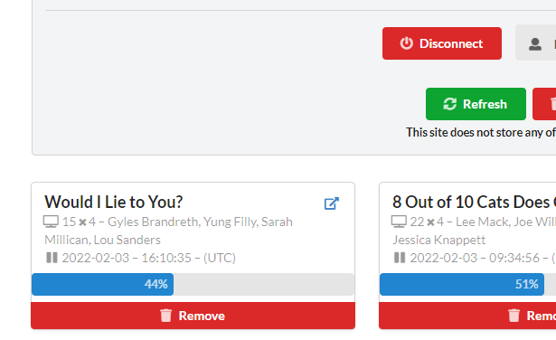

ginjaninja 605 Posted February 3, 2022 Posted February 3, 2022 (edited) i think i am in the same boat as @captainkanpai. embys trakt behaviour is not working well for me....for what seems like at least already watched shows (perhaps others too) I have been testing behaviour of continue watching ribbon by rewatching watched shows to 50%. i have a free trakt account my setttings are the plugin is scrobbling playback positions on media. and the import playstates task is definitely resetting playback positions in emby on media (under some conditions tbd)...despite trakt knowing the playback position (see above). for me the issue is limited to a particular library/path. (None of my tv libraries are excluded from trakt) media in one library has it playback position respected by the import playstates tasks (the test episode is watched on emby and trakt). media in another library has them wiped in emby...(test episodes have play back positions recorded in emby and trakt, but are not getting marked watched in trakt..need to investigate why) so when "import playstates from trakt.tv" is run, playback position perhaps isnt getting respected on content which is not watched... or perhaps the ids are mismatched somehow. there is more investigation to be done to narrow this down, but thought id report experience so far... Edited February 3, 2022 by ginjaninja
