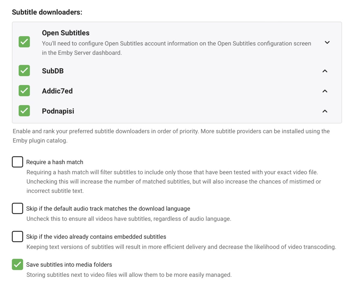

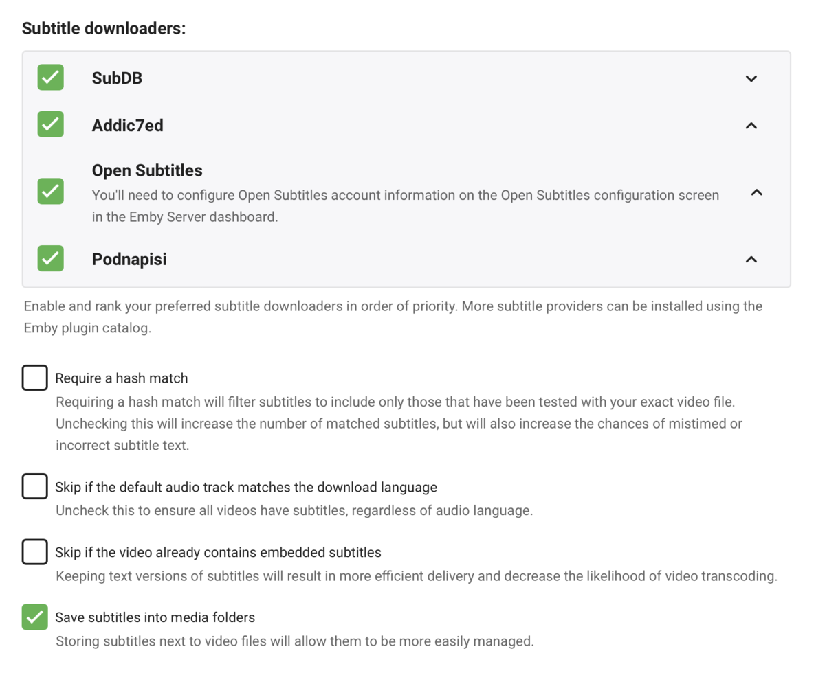

K22R8CT 25 Posted January 22, 2022 Posted January 22, 2022 (edited) Emby's subtitle matching doesn't work too well for me with Movies or TV. I'd say at least half the time I have to correct them using search to guess-and-check. My libraries are mostly popular, english-language stuff. I'm wondering if there are obvious tweaks I could make to providers, priority or anything else to improve it before I explore alternatives. These are my settings for Movies: and TV: Edited January 22, 2022 by Anon28109

Solution GrimReaper 4860 Posted January 23, 2022 Solution Posted January 23, 2022 2 hours ago, Anon28109 said: And I assume maximize implies increase (i.e. with Enable hash matching disabled (1) isn't already maximized.) Logic for subtitle downloads is Hash > Name > IMDB Id, with hash only being applicable to OpenSubtitles. If multiple matches are found, first one returned from provider is used. 2 hours ago, Anon28109 said: Without it are some providers more likely to give correct matches than others and if so, does their ordering on the library setup page affect which will be chosen? It does, same as with meta-providers, order of preference is respected. In your case, SubDB>Addic7ed>OpenSubtitles>Podnapisi will hardly ever return a hash-match (when not required) as it is likely that name-match (or IMDB Id-match subsequently) will be found on first two providers. So, Emby "guessing" which subtitle to grab is very dependent on your media naming and availability. As for which provider is more likely to return correct matches, I'd say same applies. 1
K22R8CT 25 Posted January 23, 2022 Author Posted January 23, 2022 10 hours ago, GrimReaper said: Logic for subtitle downloads is Hash > Name > IMDB Id, with hash only being applicable to OpenSubtitles. If multiple matches are found, first one returned from provider is used. It does, same as with meta-providers, order of preference is respected. In your case, SubDB>Addic7ed>OpenSubtitles>Podnapisi will hardly ever return a hash-match (when not required) as it is likely that name-match (or IMDB Id-match subsequently) will be found on first two providers. So, Emby "guessing" which subtitle to grab is very dependent on your media naming and availability. As for which provider is more likely to return correct matches, I'd say same applies. Thanks, this is helpful. So the logic is: Search 1st provider for hash match else name match else IMDB match, else Search 2nd provider for hash match else name match else IMDB match, else ... ? Wouldn't behavior be more intuitive if it were flipped, i.e.: Search all providers (in order) for hash match else Search all providers (in order) for name match else Search all providers (in order) for IMDB match
