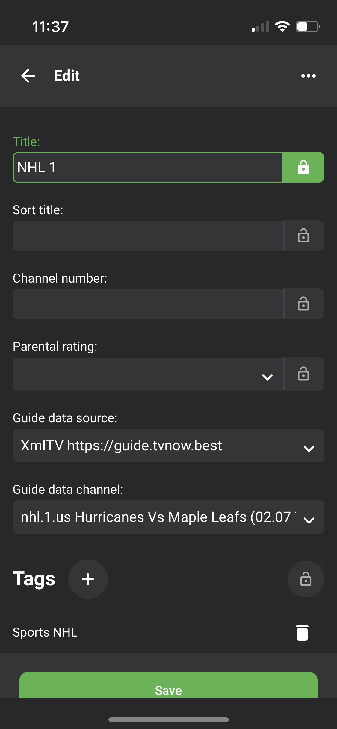

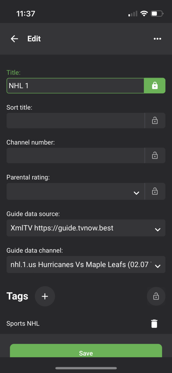

djerniehoule 23 Posted January 22, 2022 Author Posted January 22, 2022 I am curious, some of my channels like NCAA, ESPN, NFL, etc do not always show up in my guide... When they do I title them the way that I want, change the image, etc... but from time they go back to the default example NHL.US I change to NHL US and it'll go back the NHL.US - am I doing something wrong? Is there a way to stop this change? I am using Emby

djerniehoule 23 Posted January 23, 2022 Author Posted January 23, 2022 within the emby app itself, just clicking the channel and changing the meta name not the address

djerniehoule 23 Posted February 7, 2022 Author Posted February 7, 2022 When i first set up my emby account with Apollo I see channels that look like example: Nfl.nbc.us or whatever, i change in the metadata to NFL NBC 1 and after a while it may reset.

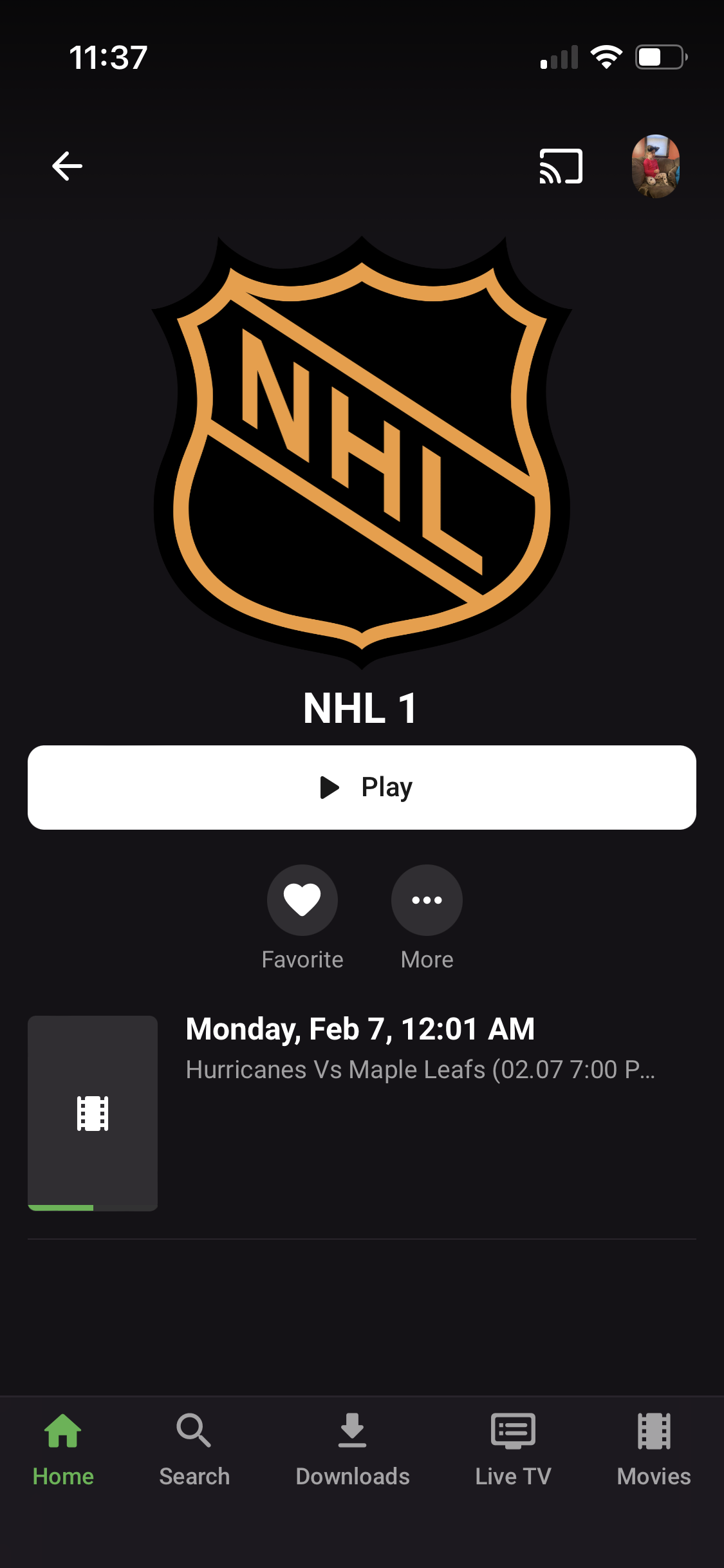

djerniehoule 23 Posted February 7, 2022 Author Posted February 7, 2022 that’s what they look like now, but after a while it’ll vanish or reappear as nhl.1.us
Luke 42186 Posted February 7, 2022 Posted February 7, 2022 5 minutes ago, djerniehoule said: that’s what they look like now, but after a while it’ll vanish or reappear as nhl.1.us No I mean please capture the contents of your actual m3u that you are importing into emby server, both now, and then again after it changes back. Thanks.
