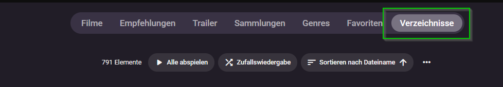

Luke 42289 Posted May 25, 2022 Posted May 25, 2022 6 hours ago, Jules0815 said: Hi again. Sorry I was kind of resigning on this :(. I don't think that it was added with a different name. Emby is now on newest version. Tried a rescan, still the same. We are now talking about 9 different movies which are not added to library. Strange thing is, series are working. I added the series "Night Sky" and it is added perfectly : /. What is also not working is removing a movie from library after I deleted it on fileserver and do a library scan. Attached you find an nfo of a movie which is not added. Thanks in advance. old.henry.true.legends.never.die.2021.german.dl.1080p.bluray.x264-lizardsquad.nfo 2.53 kB · 0 downloads Hi, do they show up in the Folders tab? Please attach the emby server log from when they were imported. Thanks.
Jules0815 2 Posted May 25, 2022 Author Posted May 25, 2022 2 hours ago, Luke said: Hi, do they show up in the Folders tab? Please attach the emby server log from when they were imported. Thanks. Hi Luke, what do you mean with folders tab? this one here? if yes, movies are also not there. logfile attached. Thx embyserver.txt
