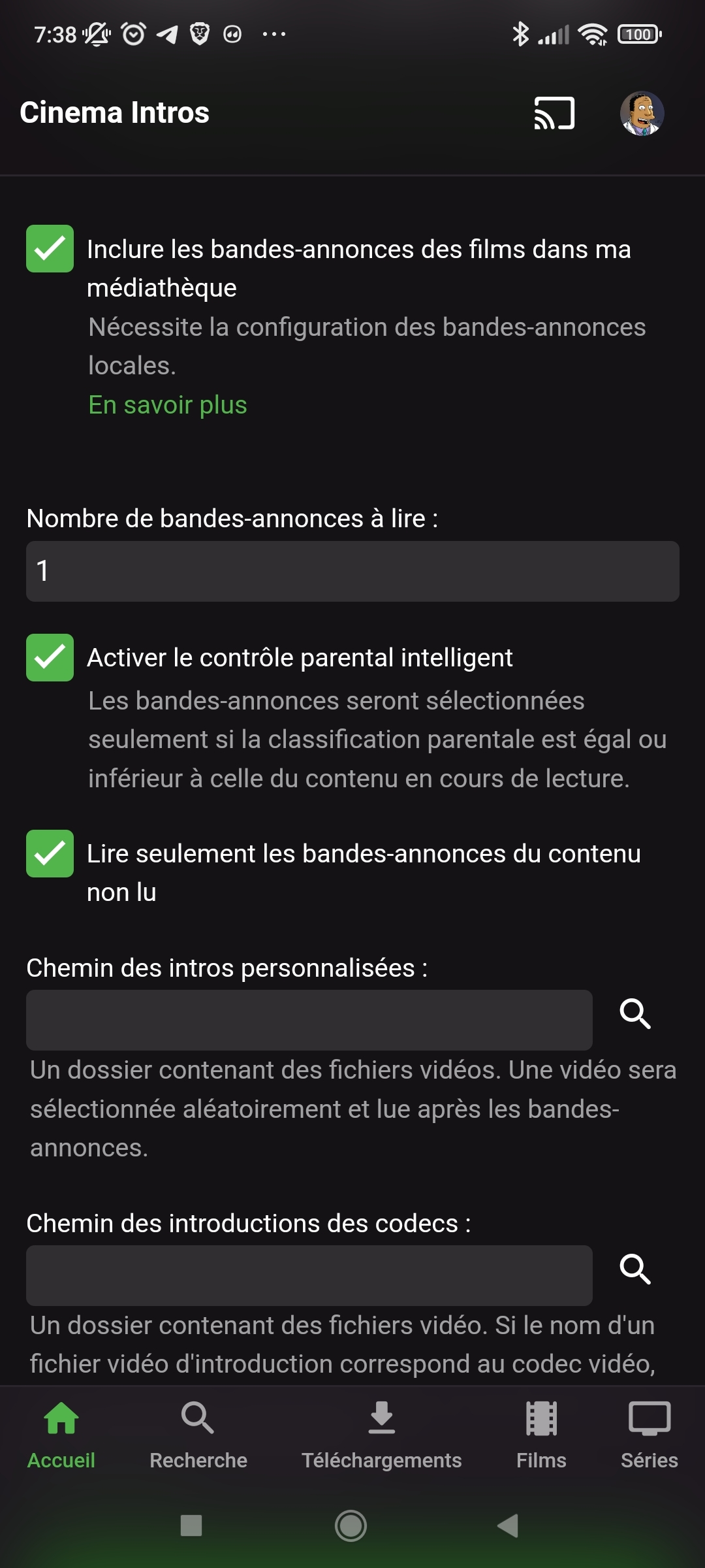

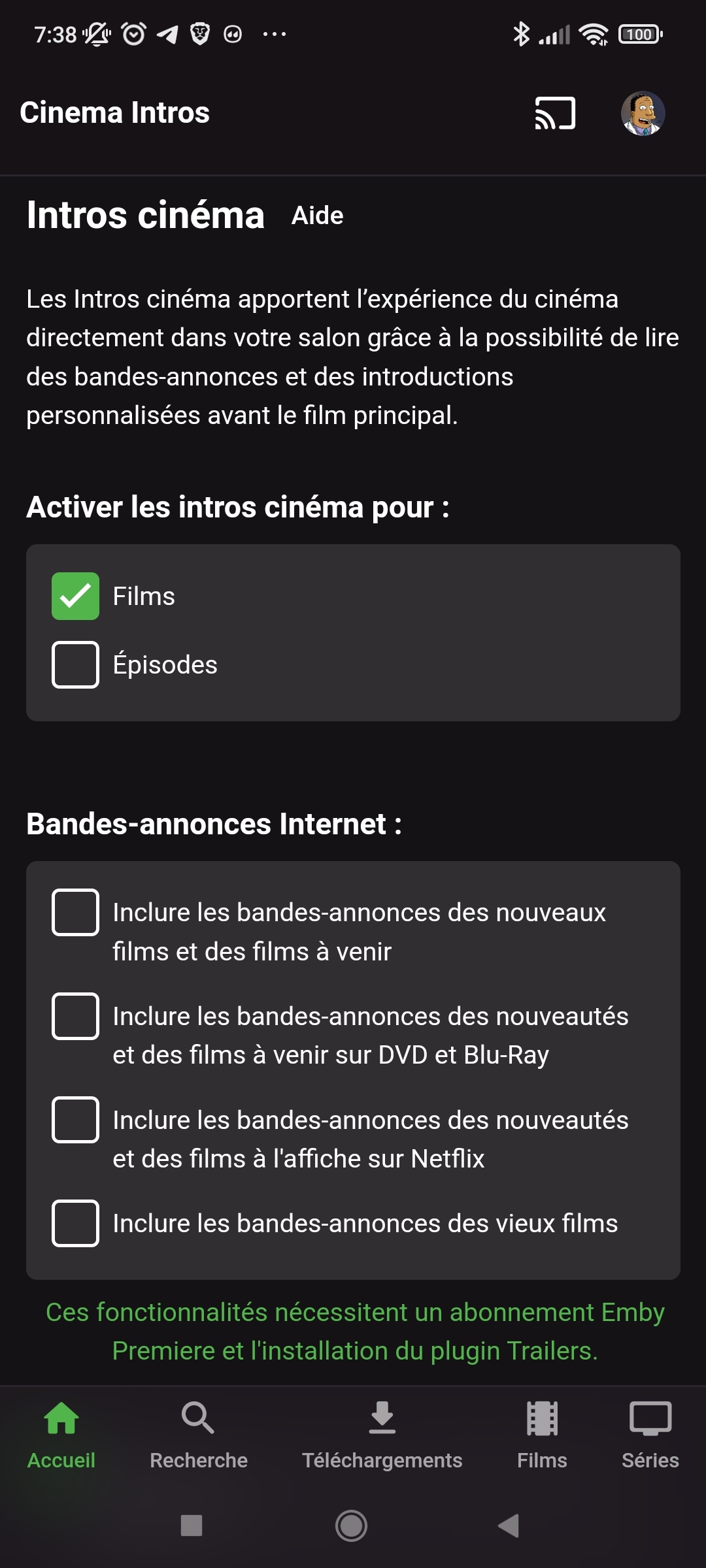

Sarakha63 18 Posted January 20, 2022 Author Posted January 20, 2022 (edited) @luke here is all the config. I'm only using local trailers. And the option im talking about is the last one checked on the second screenshot. Im not activating any online trailers as they are only english trailers. Most of the categories are stuck on 2017. And you mentionned lots of Times during those 5 last years that tmdb trailers with language selection will be implemented. And unfortunately Still today the trailer plugin is Still gathering info from a txt file on github which has not been updated for some categories for more than 5 years. And has only low res and only english trailers The issue im reporting here is not linked to online trailers but as you Can see on the screenshots to local trailers and more precisely to the last option checked which should ignore trailers from Seen movies and that is not the case. The trailer picker from the core still picks trailer for Seen movie altought the option is checked Edited January 20, 2022 by Sarakha63
Sarakha63 18 Posted January 20, 2022 Author Posted January 20, 2022 (edited) 5 minutes ago, Luke said: What local trailers do you have? i have a trailer in folder trailers in each folder of my movie.... but that works. trailers are seen by clicking on the trailer button and trailers are picked by the intro cinema... The issue is that : What is the aim of the option "Only play trailers for unseen content" -------> not picking trailers for movies marked as watched in the library and that is specifically the issue i'm reporting. Everything else is working well Edited January 20, 2022 by Sarakha63
Luke 42197 Posted January 20, 2022 Posted January 20, 2022 So that option applies to both the movie and the trailer. That means if you've seen the trailer, it will be excluded from future uses of it.
Sarakha63 18 Posted January 20, 2022 Author Posted January 20, 2022 3 minutes ago, Luke said: So that option applies to both the movie and the trailer. That means if you've seen the trailer, it will be excluded from future uses of it. Yes you said it "that applies to the movie and the trailer" and the issue i'm reporting is that it picks trailers for watched movie and it shouldn't as i have the option enabled...... so i make a synthesis as i'm thinking you didn't understand the issue : 1) I have the option "ONLY pick trailer for unseen content" CHECKED 2) It shouldnt pick trailers for a watched movie due to this option 3) It picks trailers of watched movie anyway ----------> this is the bug i'm reporting (not anything else)
