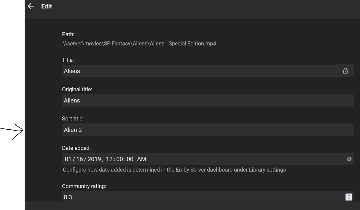

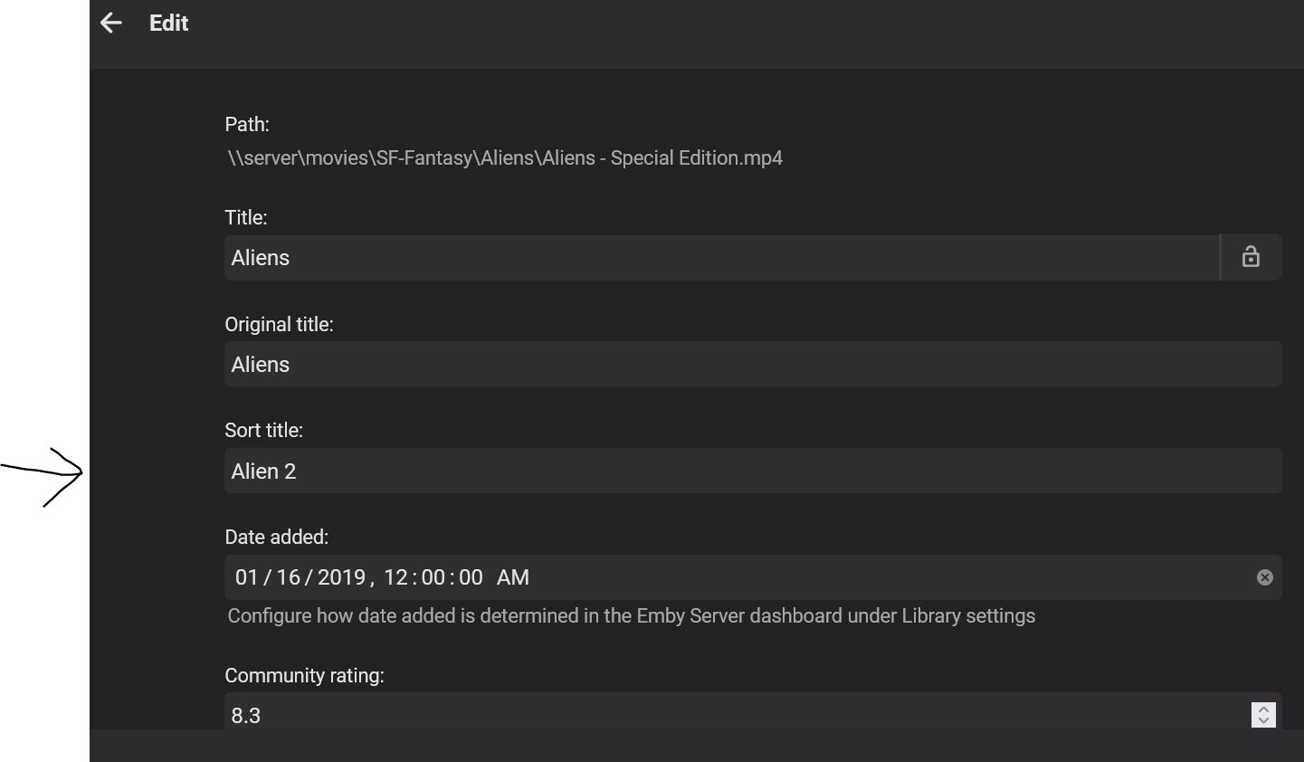

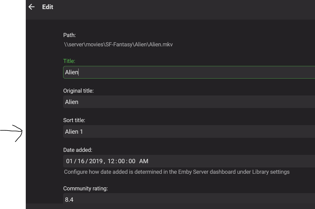

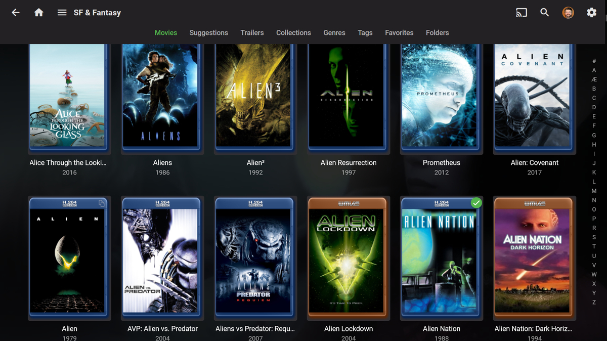

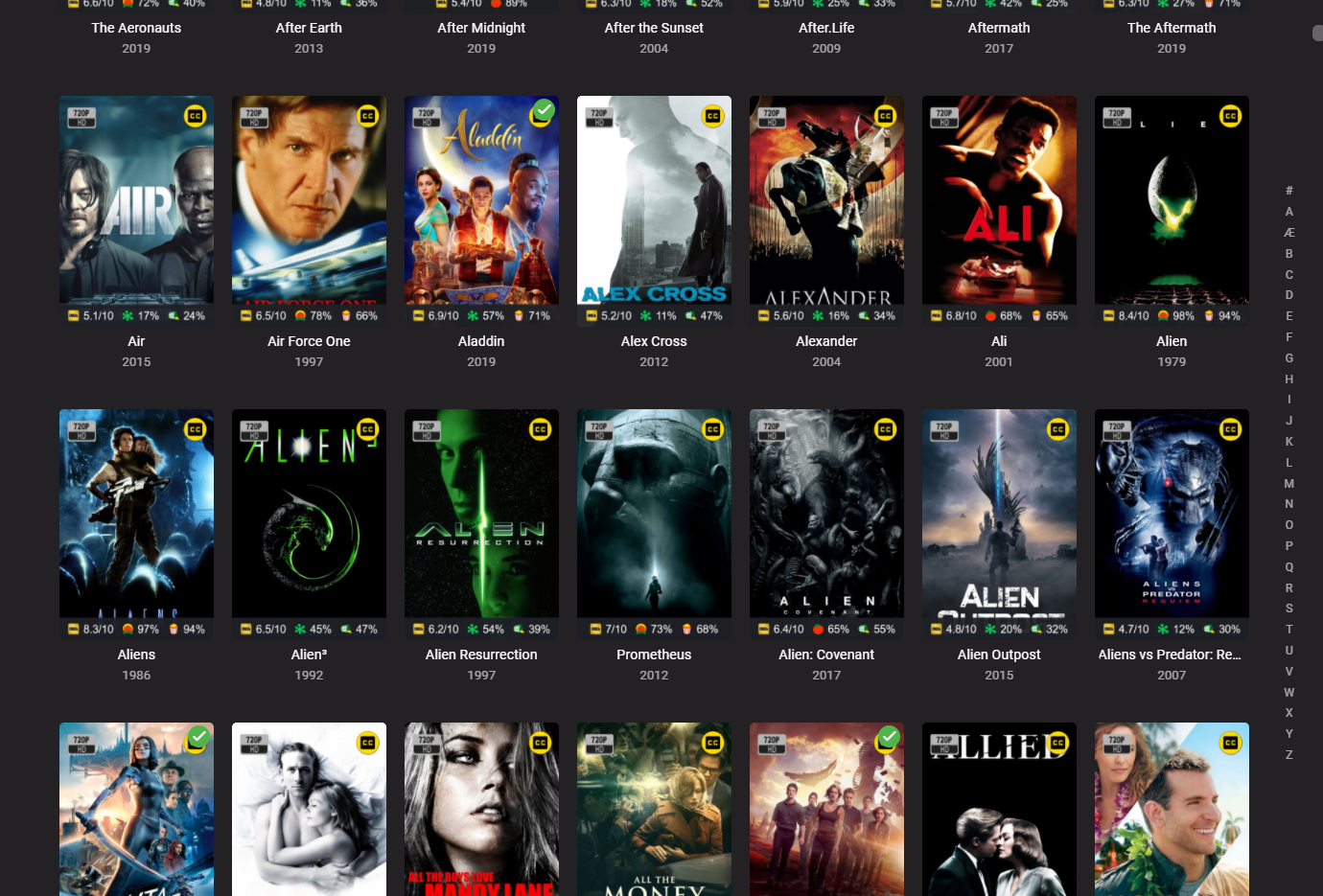

siredgar 6 Posted January 18, 2022 Posted January 18, 2022 (edited) Don't know when it started, but Emby doesn't appear to be sorting by Sort Title properly. For instance, I have the Alien movies. I have the first movie "Alien" sort title set to sort title "Alien 1", the next movie "Aliens" set to "Alien 2", then Alien 3, Alien 4, the Prometheus movies in there as Alien 5, and Alien Covenant as Alien 6.. However, it's not sorting properly. Looking at what I have set for sort titles, it's got them sorted in this order (showing the "Sort Title" fields below): Alien 2 Alien 3 Alien 4 Alien 5 Alien 6 Alien 1 I noticed it doing that on another series of movies as well. I've triple checked for funky characters, white space, etc. I've deleted, saved, and then re-added the sort title. I've double checked that it's supposed to be sorting by Title. I'm at a loss. Screen shots below: Edited January 18, 2022 by siredgar Clarity
Happy2Play 9802 Posted January 18, 2022 Posted January 18, 2022 Sorry but the last image does not show any media with A so we do not see how it is sorted. Tested in beta without issue. @siredgar

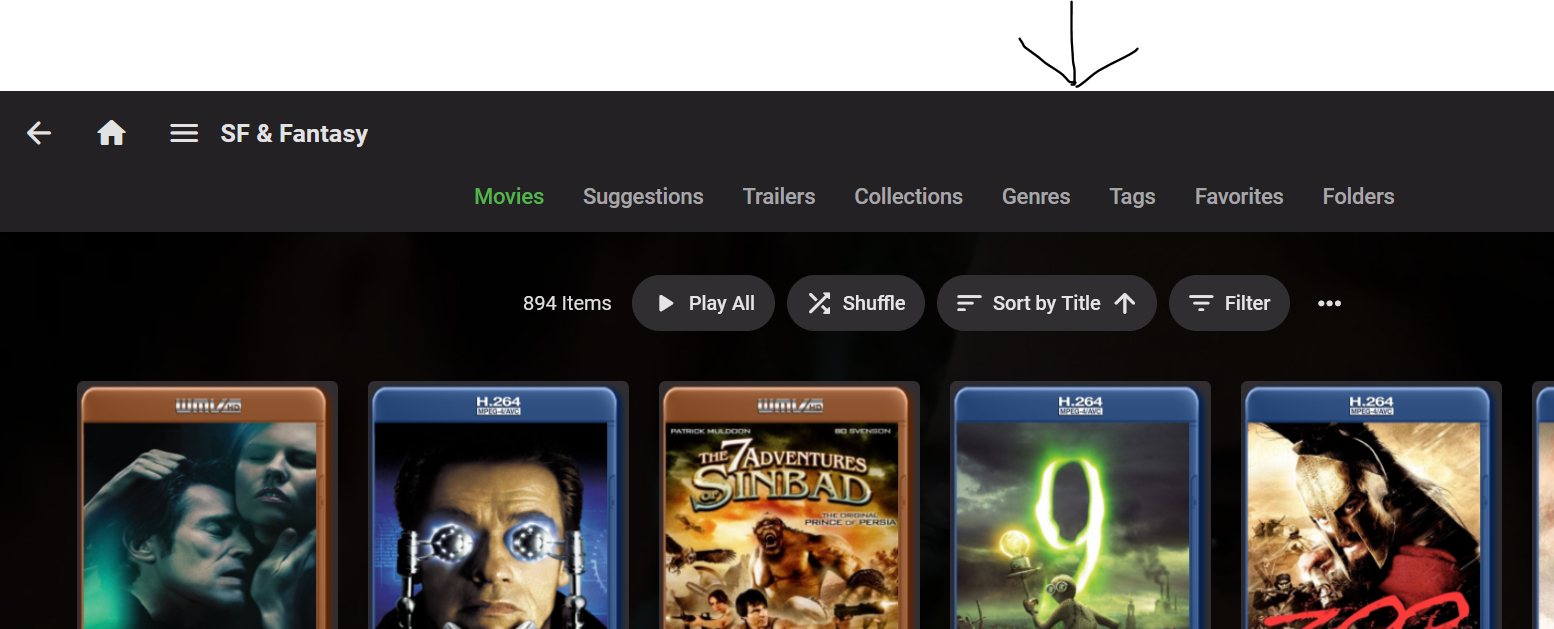

siredgar 6 Posted January 18, 2022 Author Posted January 18, 2022 The first image shows the series of Alien movies in the wrong sort order. The second and third image show the "Sort Title" metadata fields. The fourth image was only to show that I had it set to sort by title. The fifth image shows my version #. I'm sure it's an obscure error but it's one I'm having on more than one set of sort titles. Is there any log information or other data files I can share to show what's happening other than screen shots?
siredgar 6 Posted January 18, 2022 Author Posted January 18, 2022 Am I doing anything wrong in my metadata here?

siredgar 6 Posted January 18, 2022 Author Posted January 18, 2022 (Not trying to beat the topic to death but I can reproduce this on my system repeatedly) When I remove the Sort Title field on the Alien movie, it put it in its proper place before the other movies. When I put "Alien 1" back into the Sort Title, it put it at the end of the list of Alien movies again. Weird. 1
Solution siredgar 6 Posted January 18, 2022 Author Solution Posted January 18, 2022 Resolution: I deleted the Sort Title in every one of the Alien movies, then re-entered them as they were before. All titles sort properly now. Is it possible some garbage got into the sort titles somehow that wasn't visible? I had to do this resolution in two different sets of movies that weren't sorting by title properly. Some sort of corruption?
