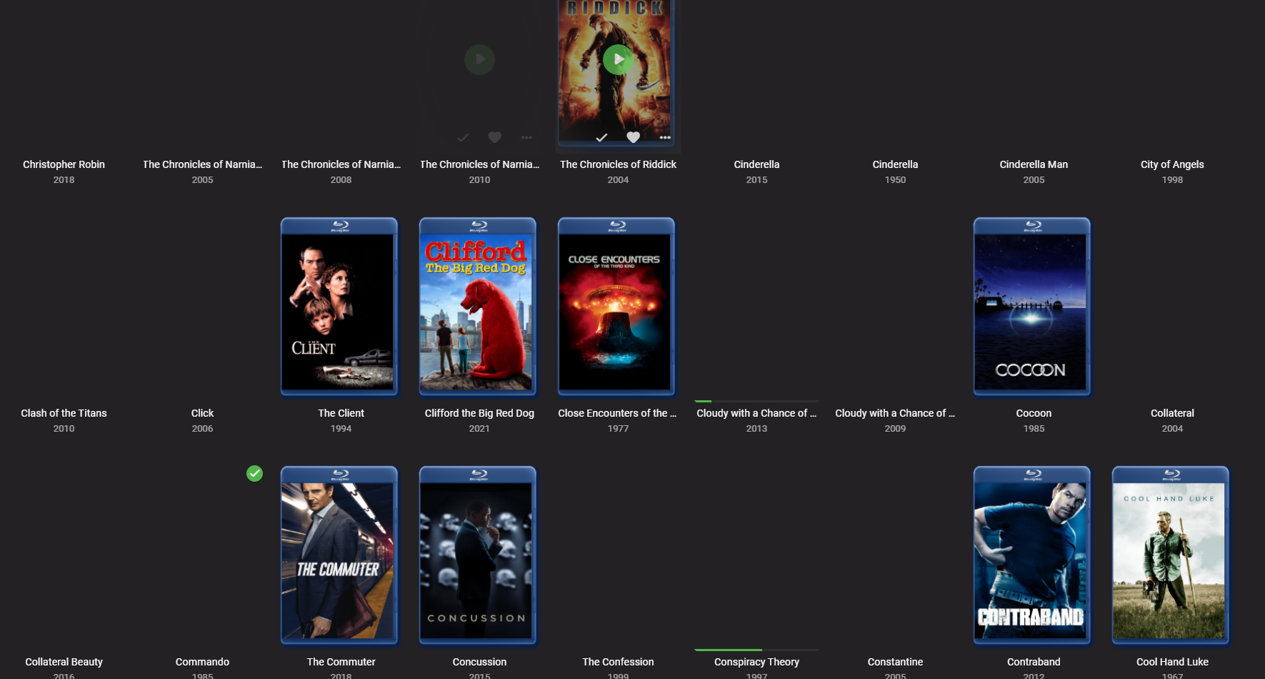

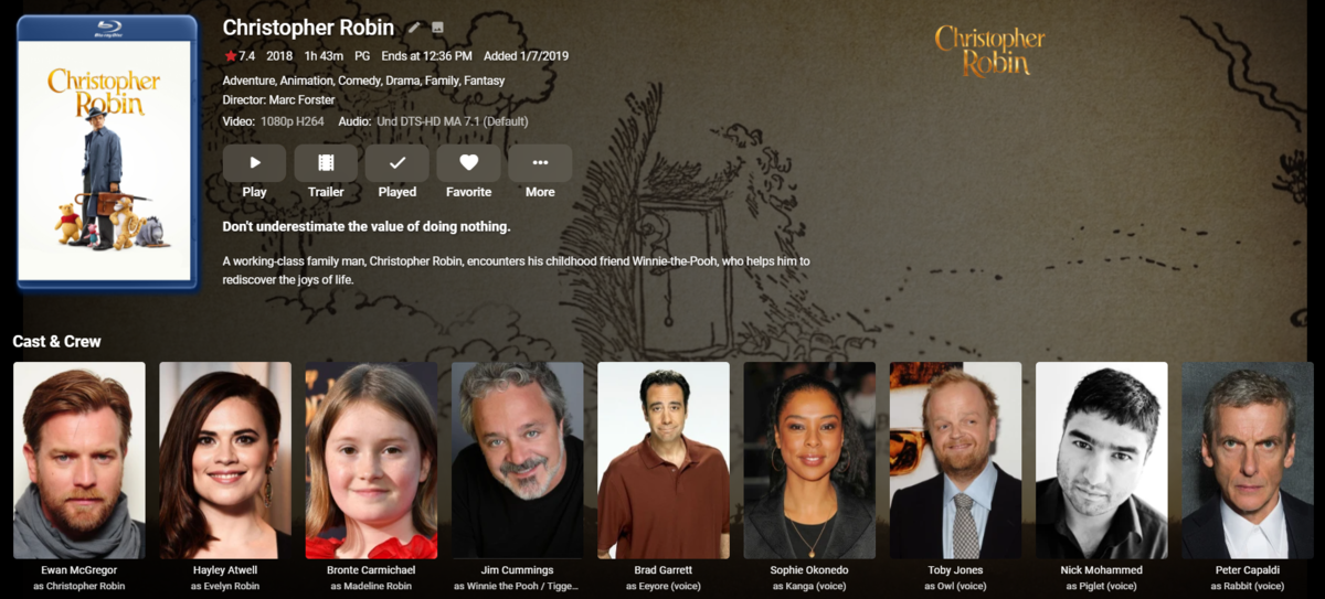

rs6516 4 Posted January 15, 2022 Posted January 15, 2022 Ok, just woke up to a new version of emby version 4.6.7.0 and new problems to go with it. half of all images simply won't load. I've checked multiple PC's, cleared cached images within the browser. I have verified they are in the movie folders. Just have a look at my library. It's not just the primary images, I've noticed thumbs missing as well. It's effecting every single aspect of emby, Movies, TV, Trailers, Podcasts, actors, you name it. my whole library looks like this. If I click on a movie to view it you can see the image will load correctly. In this example Christopher Robin is missing from the main screen, but when I click on it This is what I get. Everything looks correct. I've tried - scanning library - refresh metadata - refresh with replace images none of this has worked. The only thing I've found that works is to go in to each and every movie, TV series, etc and search for a new image and select something new. This is very tedious and there has got to be a better way. Can someone please help me out here?

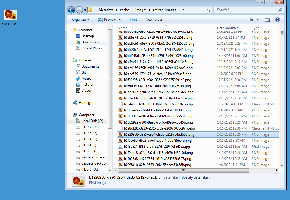

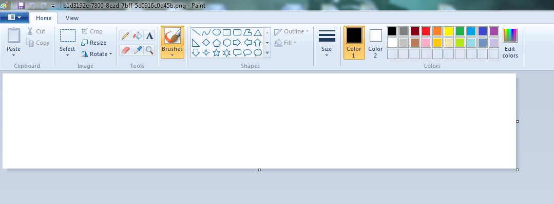

rs6516 4 Posted January 15, 2022 Author Posted January 15, 2022 Thanks, that didn't seem to work. I did notice this though. I'm in the resized cache folder and a lot of the png files are blank. I've opened them in paint and there is nothing there??? Could this be the issue? and if so how could this have happened? It's just so many files, I wouldn't think this is an issue with my SSD. The OS and all the programs are running just fine, no issues there, it's only emby. Should I delete the resized cache?

ebr 16309 Posted January 16, 2022 Posted January 16, 2022 19 hours ago, rs6516 said: Could this be the issue? Yes, as you found, that was the issue. The cached images were blank so that is what was showing. How it happened would be very hard to say at this point...
