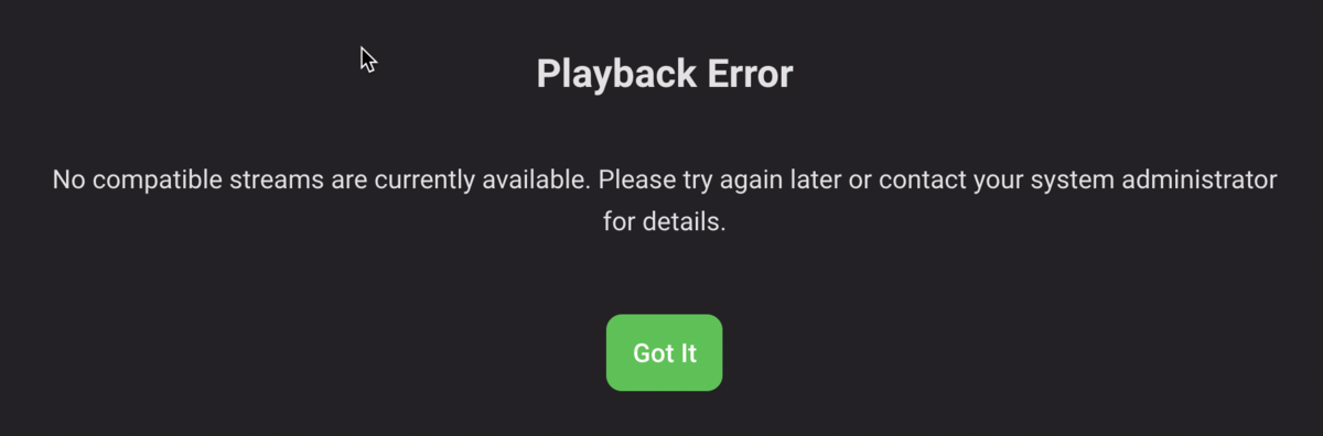

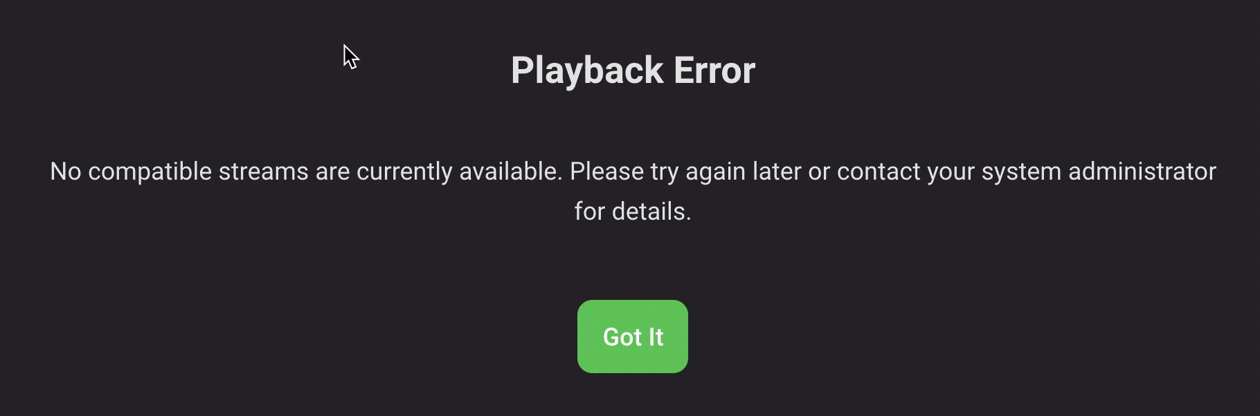

stillwater 0 Posted January 15, 2022 Posted January 15, 2022 (edited) All of sudden today, none of my videos can be played. They all getting same “No compatible streams are currently available …” error. Nothing has been changed. The server is on Windows 10 21H2 and Emby has current version. Tried web, Emby app iOS and iPadOS, same. Any help will be really appreciated. embyserver.txt Edited January 15, 2022 by stillwater added log file.
