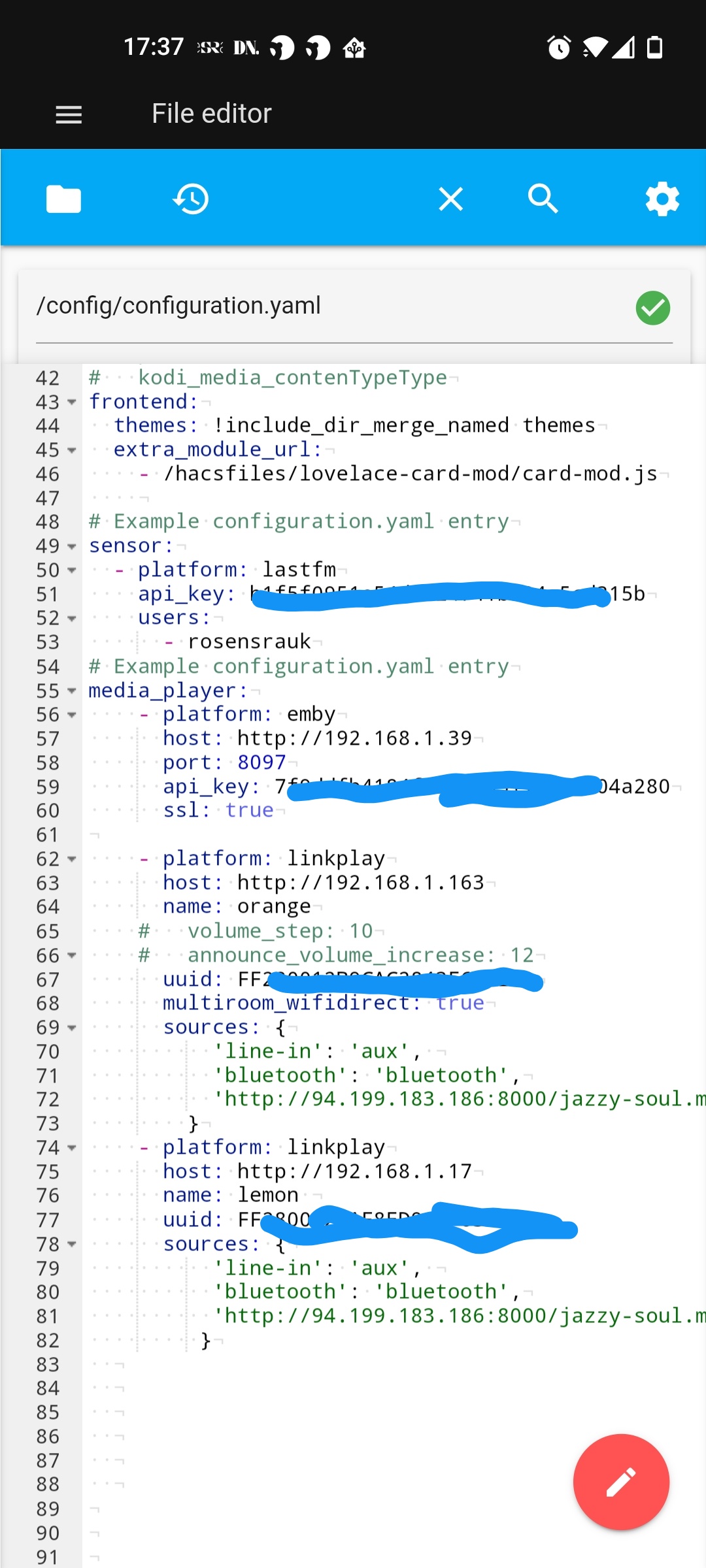

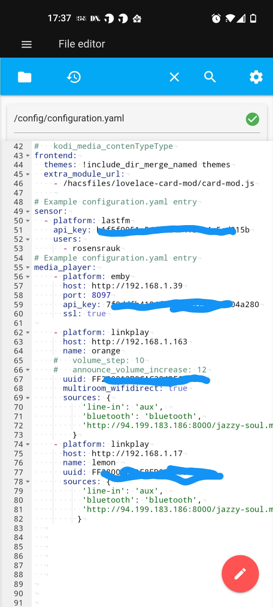

fritzo 0 Posted September 19, 2022 Posted September 19, 2022 Hi! I am having a very similar problem. It drives me nuts! Logger: pyemby.server Source: runner.py:119 First occurred: 17:14:44 (1 occurrences) Last logged: 17:14:44 Unable to register emby client.Logger: pyemby.server Source: runner.py:119 First occurred: 17:14:44 (10023 occurrences) Last logged: 17:14:44 Unable to register emby client. Logger: pyemby.server Source: /usr/local/lib/python3.10/site-packages/pyemby/server.py:252 First occurred: 17:14:44 (10048 occurrences) Last logged: 17:14:44 Error fetching Emby data: Cannot connect to host http:443 ssl:default [Name does not resolve]s I am able to ping, log in and scrobble through media from Home assistant. Everything actually works but I can't get rid of these error messages. I would appreciate some guidance, pointers or advice. My system: Home Assistant 2022.9.5 Supervisor 2022.09.1 Operating System 9.0 Frontend-version: 20220907.2 - latest
seanbuff 1353 Posted September 19, 2022 Posted September 19, 2022 6 hours ago, fritzo said: I would appreciate some guidance, pointers or advice. You're connecting with "ssl = true" So just get rid of the "http://" portion from your host string and just leave the IP in your configuration.yaml file.
fritzo 0 Posted September 20, 2022 Posted September 20, 2022 (edited) 21 hours ago, seanbuff said: You're connecting with "ssl = true" So just get rid of the "http://" portion from your host string and just leave the IP in your configuration.yaml file. Of course you are right, i forgot to remove http when changing http/https. A solution is still needed. The problem persists on both http and https. Edited September 20, 2022 by fritzo

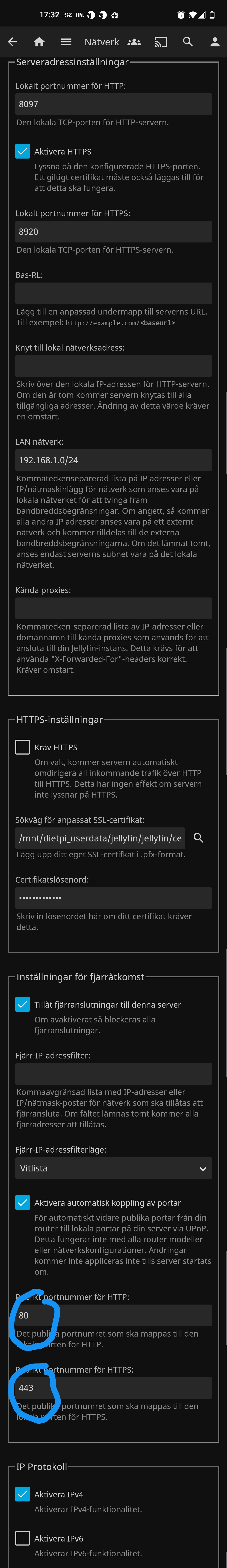

seanbuff 1353 Posted September 20, 2022 Posted September 20, 2022 3 hours ago, fritzo said: A solution is still needed. I'm sorry, I'm a little confused. Your config screens do not look like they are from Emby. Are you using Jellyfin as per your ssl certificate path? If so, then you should be using the native Jellyfin integration for HA and not Emby. Hope that helps.
