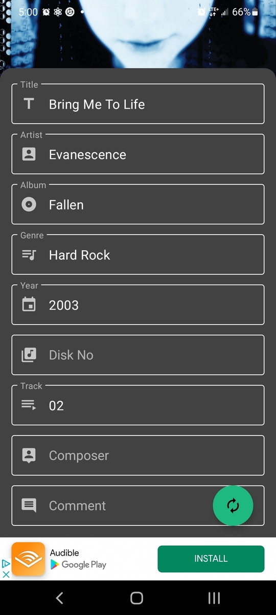

Happy2Play 9813 Posted January 13, 2022 Posted January 13, 2022 (edited) What embedded tags do the tracks have? @Styromaniac Edited January 13, 2022 by Happy2Play

Styromaniac 0 Posted January 14, 2022 Author Posted January 14, 2022 (edited) 1 hour ago, Luke said: Why exactly do you think it's not scanning into the library? It wouldn't show up in the library where I expected it to be. Maybe it lacked proper tags at the time. Edited January 14, 2022 by Styromaniac

Happy2Play 9813 Posted January 14, 2022 Posted January 14, 2022 5 minutes ago, Styromaniac said: Nope. We will probably need to see a server log for this album being added to your library. Can you run ffprobe against one of the tracks also and post the results. ffprobe -i "path_to_file" -show_streams -show_format -print_format json
Styromaniac 0 Posted January 14, 2022 Author Posted January 14, 2022 ffprobe version 4.2.4-1ubuntu0.1 Copyright (c) 2007-2020 the FFmpeg developers built with gcc 9 (Ubuntu 9.3.0-10ubuntu2) configuration: --prefix=/usr --extra-version=1ubuntu0.1 --toolchain=hardened --libdir=/usr/lib/x86_64-linux-gnu --incdir=/usr/include/x86_64-linux-gnu --arch=amd64 --enable-gpl --disable-stripping --enable-avresample --disable-filter=resample --enable-avisynth --enable-gnutls --enable-ladspa --enable-libaom --enable-libass --enable-libbluray --enable-libbs2b --enable-libcaca --enable-libcdio --enable-libcodec2 --enable-libflite --enable-libfontconfig --enable-libfreetype --enable-libfribidi --enable-libgme --enable-libgsm --enable-libjack --enable-libmp3lame --enable-libmysofa --enable-libopenjpeg --enable-libopenmpt --enable-libopus --enable-libpulse --enable-librsvg --enable-librubberband --enable-libshine --enable-libsnappy --enable-libsoxr --enable-libspeex --enable-libssh --enable-libtheora --enable-libtwolame --enable-libvidstab --enable-libvorbis --enable-libvpx --enable-libwavpack --enable-libwebp --enable-libx265 --enable-libxml2 --enable-libxvid --enable-libzmq --enable-libzvbi --enable-lv2 --enable-omx --enable-openal --enable-opencl --enable-opengl --enable-sdl2 --enable-libdc1394 --enable-libdrm --enable-libiec61883 --enable-nvenc --enable-chromaprint --enable-frei0r --enable-libx264 --enable-shared WARNING: library configuration mismatch avcodec configuration: --prefix=/usr --extra-version=1ubuntu0.1 --toolchain=hardened --libdir=/usr/lib/x86_64-linux-gnu --incdir=/usr/include/x86_64-linux-gnu --arch=amd64 --enable-gpl --disable-stripping --enable-avresample --disable-filter=resample --enable-avisynth --enable-gnutls --enable-ladspa --enable-libaom --enable-libass --enable-libbluray --enable-libbs2b --enable-libcaca --enable-libcdio --enable-libcodec2 --enable-libflite --enable-libfontconfig --enable-libfreetype --enable-libfribidi --enable-libgme --enable-libgsm --enable-libjack --enable-libmp3lame --enable-libmysofa --enable-libopenjpeg --enable-libopenmpt --enable-libopus --enable-libpulse --enable-librsvg --enable-librubberband --enable-libshine --enable-libsnappy --enable-libsoxr --enable-libspeex --enable-libssh --enable-libtheora --enable-libtwolame --enable-libvidstab --enable-libvorbis --enable-libvpx --enable-libwavpack --enable-libwebp --enable-libx265 --enable-libxml2 --enable-libxvid --enable-libzmq --enable-libzvbi --enable-lv2 --enable-omx --enable-openal --enable-opencl --enable-opengl --enable-sdl2 --enable-libdc1394 --enable-libdrm --enable-libiec61883 --enable-nvenc --enable-chromaprint --enable-frei0r --enable-libx264 --enable-shared --enable-version3 --disable-doc --disable-programs --enable-libaribb24 --enable-liblensfun --enable-libopencore_amrnb --enable-libopencore_amrwb --enable-libtesseract --enable-libvo_amrwbenc libavutil 56. 31.100 / 56. 31.100 libavcodec 58. 54.100 / 58. 54.100 libavformat 58. 29.100 / 58. 29.100 libavdevice 58. 8.100 / 58. 8.100 libavfilter 7. 57.100 / 7. 57.100 libavresample 4. 0. 0 / 4. 0. 0 libswscale 5. 5.100 / 5. 5.100 libswresample 3. 5.100 / 3. 5.100 libpostproc 55. 5.100 / 55. 5.100 { Input #0, flac, from '/home/styromaniac/Music/Evanescence/Fallen/01 - Going Under.flac': Metadata: TITLE : Going Under ARTIST : Evanescence album_artist : Evanescence ALBUM : Fallen DATE : 2003 track : 01 GENRE : Gothic Rock TOTALTRACKS : 12 Duration: 00:03:34.95, start: 0.000000, bitrate: 992 kb/s Stream #0:0: Audio: flac, 44100 Hz, stereo, s16 Stream #0:1: Video: mjpeg (Baseline), yuvj420p(pc, bt470bg/unknown/unknown), 1000x1000 [SAR 300:300 DAR 1:1], 90k tbr, 90k tbn, 90k tbc (attached pic) Metadata: comment : Cover (front) "streams": [ { "index": 0, "codec_name": "flac", "codec_long_name": "FLAC (Free Lossless Audio Codec)", "codec_type": "audio", "codec_time_base": "1/44100", "codec_tag_string": "[0][0][0][0]", "codec_tag": "0x0000", "sample_fmt": "s16", "sample_rate": "44100", "channels": 2, "channel_layout": "stereo", "bits_per_sample": 0, "r_frame_rate": "0/0", "avg_frame_rate": "0/0", "time_base": "1/44100", "start_pts": 0, "start_time": "0.000000", "duration_ts": 9479148, "duration": "214.946667", "bits_per_raw_sample": "16", "disposition": { "default": 0, "dub": 0, "original": 0, "comment": 0, "lyrics": 0, "karaoke": 0, "forced": 0, "hearing_impaired": 0, "visual_impaired": 0, "clean_effects": 0, "attached_pic": 0, "timed_thumbnails": 0 } }, { "index": 1, "codec_name": "mjpeg", "codec_long_name": "Motion JPEG", "profile": "Baseline", "codec_type": "video", "codec_time_base": "0/1", "codec_tag_string": "[0][0][0][0]", "codec_tag": "0x0000", "width": 1000, "height": 1000, "coded_width": 1000, "coded_height": 1000, "has_b_frames": 0, "sample_aspect_ratio": "1:1", "display_aspect_ratio": "1:1", "pix_fmt": "yuvj420p", "level": -99, "color_range": "pc", "color_space": "bt470bg", "chroma_location": "center", "refs": 1, "r_frame_rate": "90000/1", "avg_frame_rate": "0/0", "time_base": "1/90000", "start_pts": 0, "start_time": "0.000000", "duration_ts": 19345200, "duration": "214.946667", "bits_per_raw_sample": "8", "disposition": { "default": 0, "dub": 0, "original": 0, "comment": 0, "lyrics": 0, "karaoke": 0, "forced": 0, "hearing_impaired": 0, "visual_impaired": 0, "clean_effects": 0, "attached_pic": 1, "timed_thumbnails": 0 }, "tags": { "comment": "Cover (front)" } } ], "format": { "filename": "/home/styromaniac/Music/Evanescence/Fallen/01 - Going Under.flac", "nb_streams": 2, "nb_programs": 0, "format_name": "flac", "format_long_name": "raw FLAC", "start_time": "0.000000", "duration": "214.946667", "size": "26667488", "bit_rate": "992524", "probe_score": 100, "tags": { "TITLE": "Going Under", "ARTIST": "Evanescence", "album_artist": "Evanescence", "ALBUM": "Fallen", "DATE": "2003", "track": "01", "GENRE": "Gothic Rock", "TOTALTRACKS": "12" } } }
Happy2Play 9813 Posted January 14, 2022 Posted January 14, 2022 3 minutes ago, Styromaniac said: "tags": { "TITLE": "Going Under", "ARTIST": "Evanescence", "album_artist": "Evanescence", "ALBUM": "Fallen", "DATE": "2003", "track": "01", "GENRE": "Gothic Rock", "TOTALTRACKS": "12" } Everything looks good here. Unless there is something in the server log, I am not sure.
