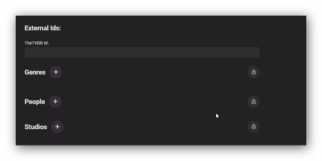

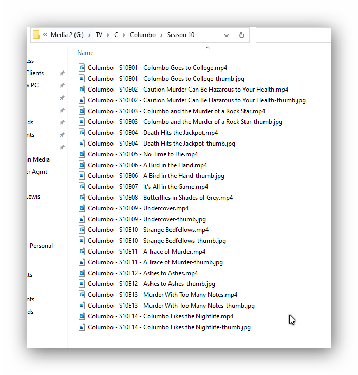

BruceDavid 4 Posted January 13, 2022 Posted January 13, 2022 Hi, I have season 10 of Columbo (see screenshot below). Emby is not picking-up all of the episodes. I think the reason is that there are various configurations as to the episodes for the season. The ordering that I am using was used by Wikipedia. IMDB breaks it down into seasons 10-13 and The TVDB stops at season 10 but with only a few episodes. So, is there a way that I can manually add the episodes to Emby? Thanks.
seanbuff 1353 Posted January 13, 2022 Posted January 13, 2022 You can try using TheMovieDB as your source for this one, they seem to have the complete Season 10 as per your file structure https://www.themoviedb.org/tv/873-columbo/season/10 1
BruceDavid 4 Posted January 13, 2022 Author Posted January 13, 2022 Thanks. But, how do I do that? If I go to metadata editor for season 10 on Emby, the only external source that is shown is The TVDB. Where would I input TheMovieDB as the source of metadata?
GrimReaper 4860 Posted January 13, 2022 Posted January 13, 2022 In your library settings metadata downloaders elevate TMDB on top via arrows on the right side, afterwards on item three-dot menu>Refresh Metadata>Replace all.
BruceDavid 4 Posted January 13, 2022 Author Posted January 13, 2022 Thanks but that doesn't seem to work. I did as you suggested and my library setting looks like yours above but when I go to the specific season - edit metadata, the only external provider is still TheTVDB.
Luke 42197 Posted January 13, 2022 Posted January 13, 2022 4 minutes ago, BruceDavid said: Thanks but that doesn't seem to work. I did as you suggested and my library setting looks like yours above but when I go to the specific season - edit metadata, the only external provider is still TheTVDB. What level is that the metadata editor for? Try it at the series level.

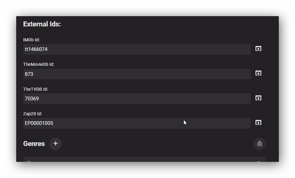

BruceDavid 4 Posted January 13, 2022 Author Posted January 13, 2022 If I look at the metadata editor for the series, IMDB is listed first (see below) even though TMDB is listed first in library-metadata settings. I tried deleting the IMDB ID shown below (leaving the field blank) but that did not solve the problem. Thoughts? Thanks.
seanbuff 1353 Posted January 14, 2022 Posted January 14, 2022 5 hours ago, BruceDavid said: If I look at the metadata editor for the series, IMDB is listed first (see below) even though TMDB is listed first in library-metadata settings The order on that metadata page is unrelated to the order of your meta downloaders so don't worry about that. Have you tried temporarily unselecting the other providers, just leave TheMovieDb and do a re-"Identify" on the Columbo series level using "873" as the ID? 1
