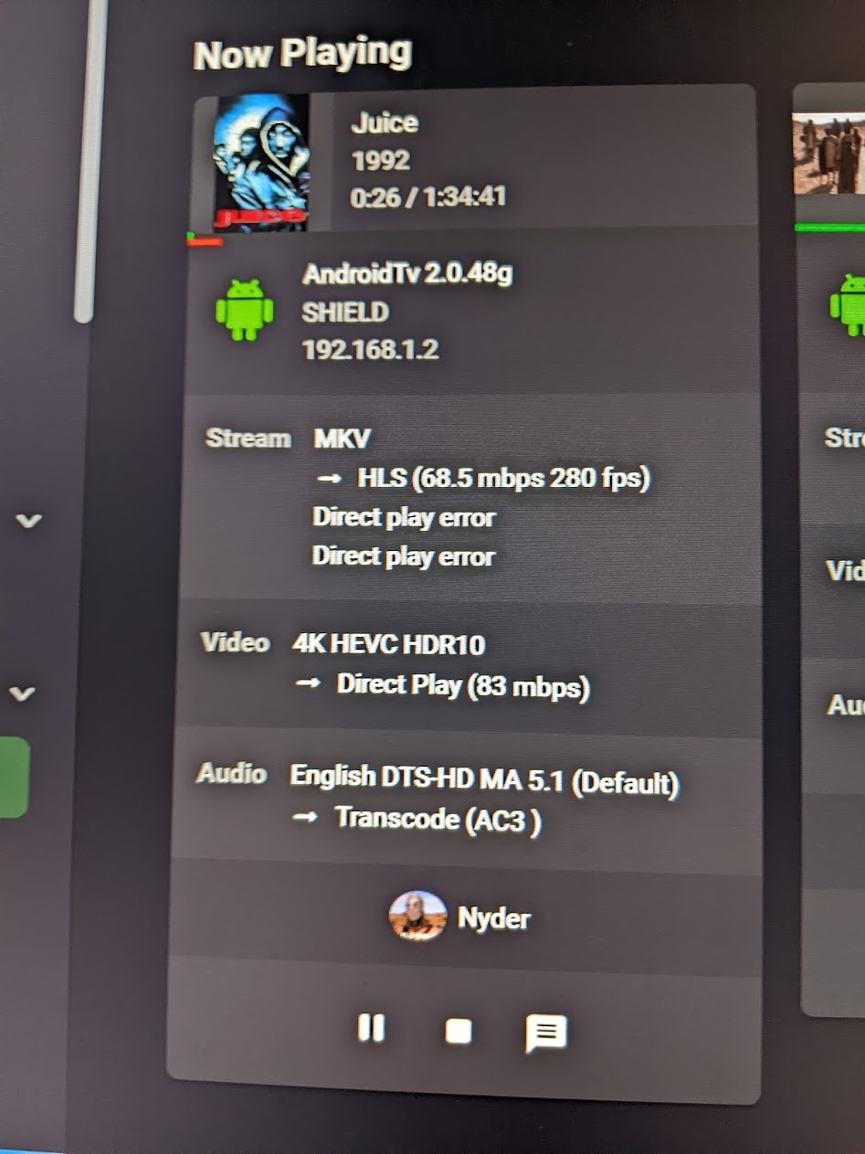

Nyder 1 Posted January 18, 2022 Posted January 18, 2022 Anyone know why when I play 4K remux from my Emby server onto my Nvidia shield I get these weird error? running latest hotfix and latest version of emby server for windows 10
rbjtech 5344 Posted January 19, 2022 Posted January 19, 2022 4 hours ago, Nyder said: Anyone know why when I play 4K remux from my Emby server onto my Nvidia shield I get these weird error? running latest hotfix and latest version of emby server for windows 10 The issue is you are trying to play DTS-HD on a system that does not support it - thus emby is having to transcode/repackage. Try choosing a compatible audio track BEFORE you press play - likely an AC3 track. It should then direct-play.

Nyder 1 Posted January 19, 2022 Posted January 19, 2022 4 hours ago, rbjtech said: The issue is you are trying to play DTS-HD on a system that does not support it - thus emby is having to transcode/repackage. Try choosing a compatible audio track BEFORE you press play - likely an AC3 track. It should then direct-play. My Soundbar supports DTSX, I connected the shield to the soundbar directly and it plays DTS-HD/DTS audio tracks on Non-REMUX MKV's fine with no transcoding (Like it did before the recent update) however ALL remux MKV's 4K or 1080P stutter until I change the sound track to a non DTS-HD track. Non REMUX MKV's play fine with DTS-HD/DTSX. Nyd
CBers 7554 Posted January 19, 2022 Author Posted January 19, 2022 5 hours ago, Nyder said: My Soundbar supports DTSX, I connected the shield to the soundbar directly and it plays DTS-HD/DTS audio tracks on Non-REMUX MKV's fine with no transcoding (Like it did before the recent update) however ALL remux MKV's 4K or 1080P stutter until I change the sound track to a non DTS-HD track. Non REMUX MKV's play fine with DTS-HD/DTSX. Nyd You might want to open a new discussion thread in the Android TV forum and submit logs etc., so that @ebr can review.
rbjtech 5344 Posted January 19, 2022 Posted January 19, 2022 (edited) 6 hours ago, Nyder said: My Soundbar supports DTSX, I connected the shield to the soundbar directly and it plays DTS-HD/DTS audio tracks on Non-REMUX MKV's fine with no transcoding (Like it did before the recent update) however ALL remux MKV's 4K or 1080P stutter until I change the sound track to a non DTS-HD track. Non REMUX MKV's play fine with DTS-HD/DTSX. Nyd ok - If this worked before the 'shield update' - then your TV must support eARC passthrough - as that is the only way you would have DTS-HD or True-HD working if you are plugging the Shield into the TV. Have you checked the Audio settings on the shield ? If it's set to Auto, maybe select the individual Codecs instead. I also personally turn off the 'Dolby Processing' - as I want it to passthrough ALL codecs unaltered to my Receiver and let it do the processing, not the shield. Edited January 19, 2022 by rbjtech
