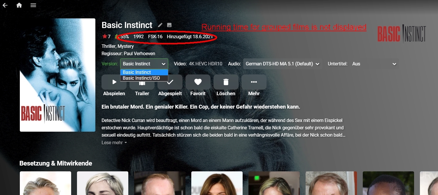

mixXxim 2 Posted January 11, 2022 Posted January 11, 2022 Hi, I've grouped two versions of the same movie. Once as mkv and once as ISO with the same name. Unfortunately then the running time of the films is not displayed. Assumption: because then the ISO is taken as the primary film and the running time cannot be determined, although the ISO is in the second position in the selection. Question: How can I change this fact without splitting up the group. thank you Ich habe zwei Versionen ein und des selben Films Gruppiert. Einmal als mkv und einmal als ISO mit dem selben Namen. Leider wird dann die Laufzeit der Filme nicht angezeigt. Vermutung: weil dann die ISO als primärer Film genommen wird und die Laufzeit nicht ermittelt werden kann, obwohl in der Auswahl die ISO an zweiter Stell steht. Frage: Wie kann ich diesen Umstand ändern ohne die Gruppierung aufzusplitten. Danke

pwhodges 2025 Posted January 11, 2022 Posted January 11, 2022 There is no user control over the ordering of options, or which Emby chooses as default. The choice is made each time of the version which Emby thinks will be able to give the best quality for the client and connection in use. Our usage for other things like versions or directors cuts is (currently) tolerated but not really supported. Paul
Happy2Play 9802 Posted January 11, 2022 Posted January 11, 2022 4 minutes ago, mixXxim said: Assumption: because then the ISO is taken as the primary film and the running time cannot be determined, although the ISO is in the second position in the selection. There is no dynamic information on multi-versioning. Emby will only present info for one item in the group no matter what version is selected.
Solution Happy2Play 9802 Posted January 11, 2022 Solution Posted January 11, 2022 5 minutes ago, mixXxim said: Question: How can I change this fact without splitting up the group. Possibly remove the ISO, do a library scan and readd the ISO.
pwhodges 2025 Posted January 11, 2022 Posted January 11, 2022 1 minute ago, Happy2Play said: There is no dynamic information on multi-versioning. Emby will only present info for one item in the group no matter what version is selected. That's not strictly true, as the audio and subtitle track selectors are adjusted to match the selected file (it would be unusable if they weren't). Paul
Happy2Play 9802 Posted January 11, 2022 Posted January 11, 2022 Just now, pwhodges said: That's not strictly true, as the audio and subtitle track selectors are adjusted to match the selected file (it would be unusable if they weren't). Paul Yes that is file info and the rest of the UI does not show any this different as the first file imported presents everything for all files, ie first nfo file if you write nfo files.

mixXxim 2 Posted January 12, 2022 Author Posted January 12, 2022 14 hours ago, Happy2Play said: Eventuell die ISO entfernen, einen Bibliotheksscan durchführen und die ISO lesen. Hi, Thanks a lot for all the answers. @ Happy2Play Did it just as well, it works and the times can now also be sorted. That was my real job. 1 hour ago, ebr said: Hallo. Deine Vermutung ist wahrscheinlich richtig. Ich schätze, ich würde fragen, warum eine ISO als Version hinzugefügt werden sollte - Sie werden es nirgendwo spielen können, also wird es wahrscheinlich nur Frustration für die Benutzer verursachen. @ebr because I want to keep the ISO as originals and the mkv are ripped and edited. But I will move to an external HDD later. thank you @all why is the quote in German now? Probably because I had the page translated into German in chrome.
