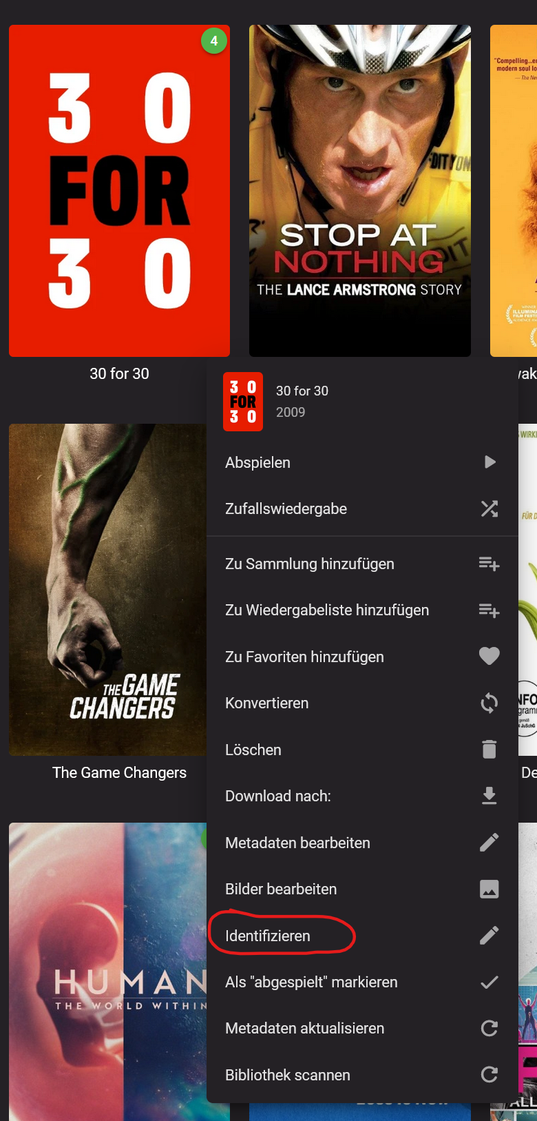

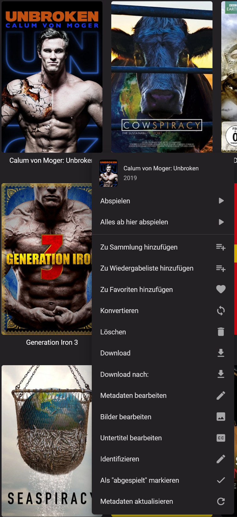

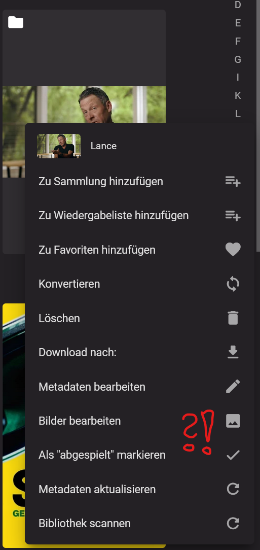

Florian2000 17 Posted January 11, 2022 Posted January 11, 2022 Hi, I want a library called "Dokumentation" which contains both films and series. Now I thought I was right with a mixed content library, but this library does not recognise any series...also I can no longer change this type of directory/media type with "Identify"...this menu entry is not offered at all. Identify is missing when clicking on the directory: when clicking on a movie...the entry "Identify" is there: The same content/media files in the dedicated "Series" library was recognized correctly: So I ask myself what is the use of mixed content libraries when it is not possible to mix movies and series in a proper way? Or what am I doing wrong? Br, Florian

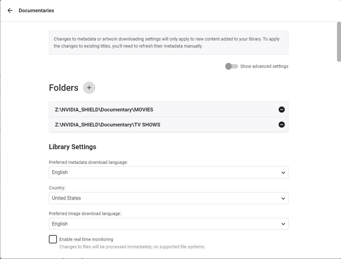

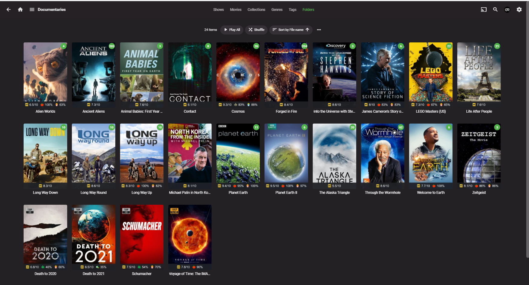

Solution GrimReaper 4860 Posted January 11, 2022 Solution Posted January 11, 2022 (edited) How did you setup library paths? I have same mixed-content Documentaries library and have no issues getting either Movies or TV shows recognized. Edited January 11, 2022 by GrimReaper Cross-posted

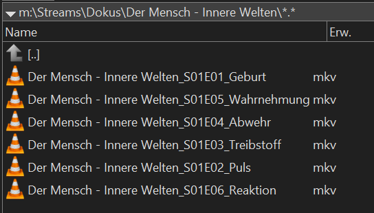

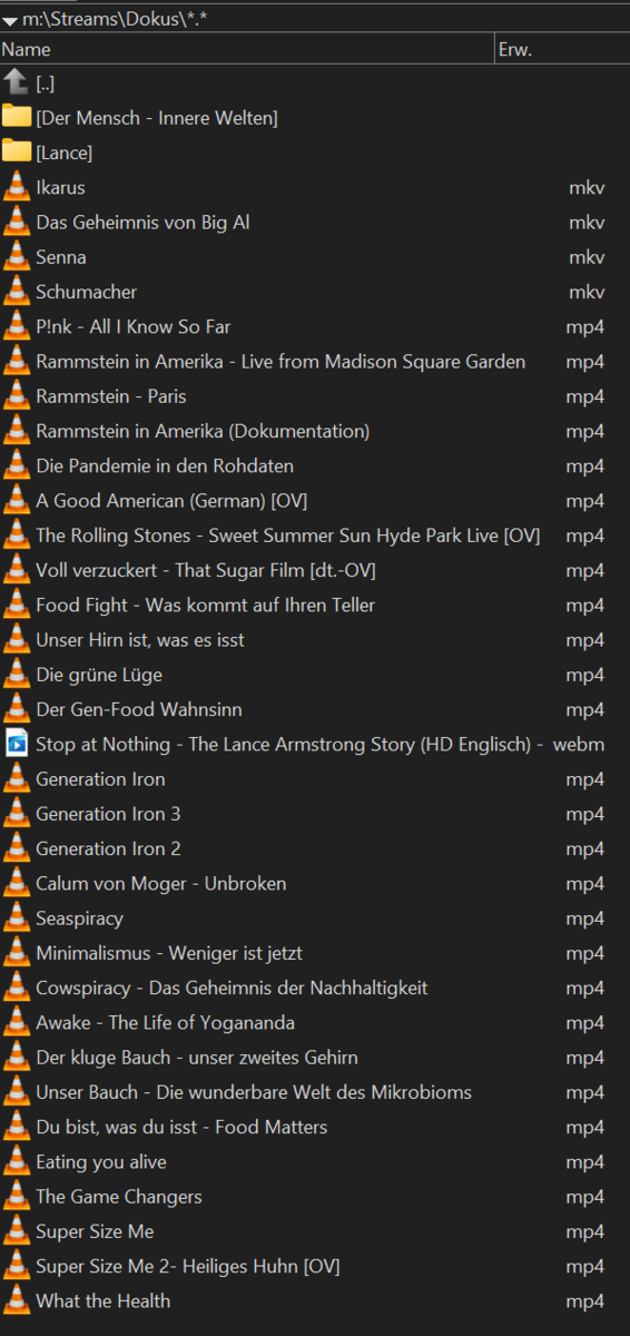

Florian2000 17 Posted January 11, 2022 Author Posted January 11, 2022 I have one library path to the folder "Dokus" and within this folder I have both movies and series. and this is how I do the series which works fine if it is in a series library but it doesn't work fine in a mixed mode library:

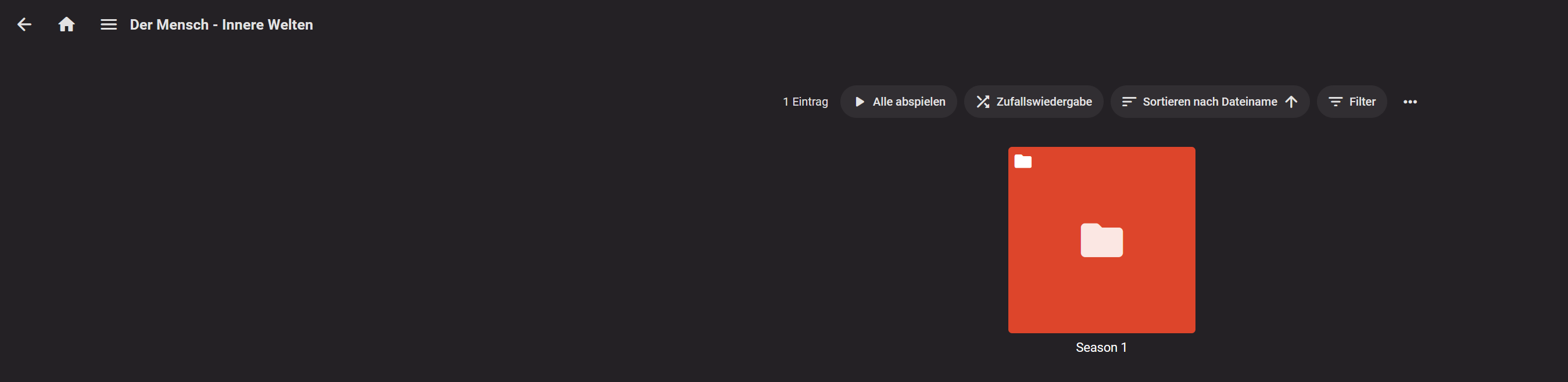

ebr 16309 Posted January 11, 2022 Posted January 11, 2022 Try taking one of those series folders and putting the episodes under the proper "Season x" folders. In a mixed content library, without something that gives a clue (like the existence of a season folder) there is no way to tell the difference between a TV series and just a folder.
Florian2000 17 Posted January 11, 2022 Author Posted January 11, 2022 7 minutes ago, ebr said: Try taking one of those series folders and putting the episodes under the proper "Season x" folders. In a mixed content library, without something that gives a clue (like the existence of a season folder) there is no way to tell the difference between a TV series and just a folder. doesn't work: it's only one folder more with no further effect. Identifying is also missing when emby thinks it is only a directory...

pwhodges 2025 Posted January 11, 2022 Posted January 11, 2022 54 minutes ago, Florian2000 said: didn't work...it's like GrimReaper wrote: the solution is to have it split into different directories and to have both folders included into one library. but personally I don't understand why it isn't working in one directory as well. Emby works best when you use the preferred folder layout; in my early time with it I learned this the hard way! So my "documentaries" library (yes, I have one too) is in a single folder "documentaries", with each film in its own subfolder "documentaries\film-name" and each series in its own subfolder "documentaries\series-name\season01" (etc for additional seasons). This simply works as you'd want it to, and once you've got your library like that it's no trouble to keep it that way in the future. If Emby still has trouble with something obscure (I have a lot of that...), then I go to TVDB or TMDB and look it up manually, then either change the name in my library to be an exact match to their naming, or append their ID using the [tvdbid=...] or [tmdbid=...] format. In rare cases I have failed to find something manually, but have found it in IMDB (which Emby doesn't use) - adding [imdbid=tt...] to the folder name then sometimes enables the other databases to find what I'd failed to manually. Paul 2
