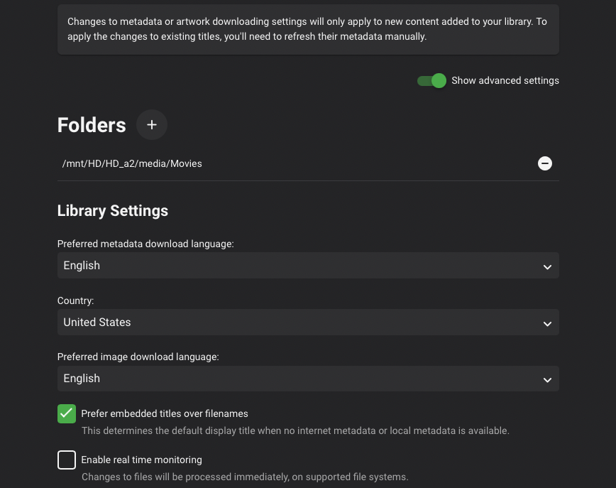

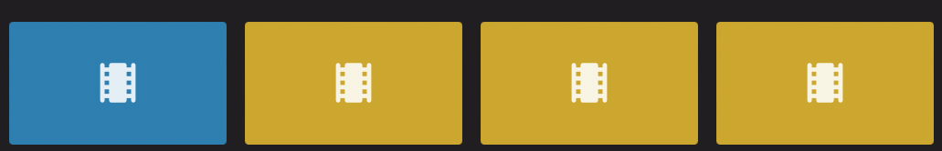

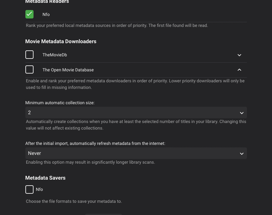

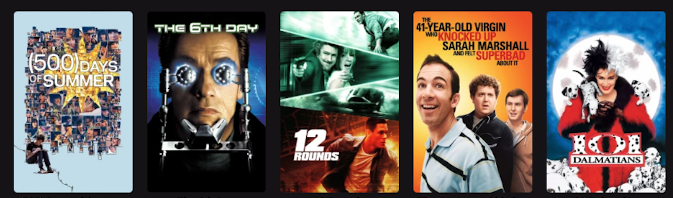

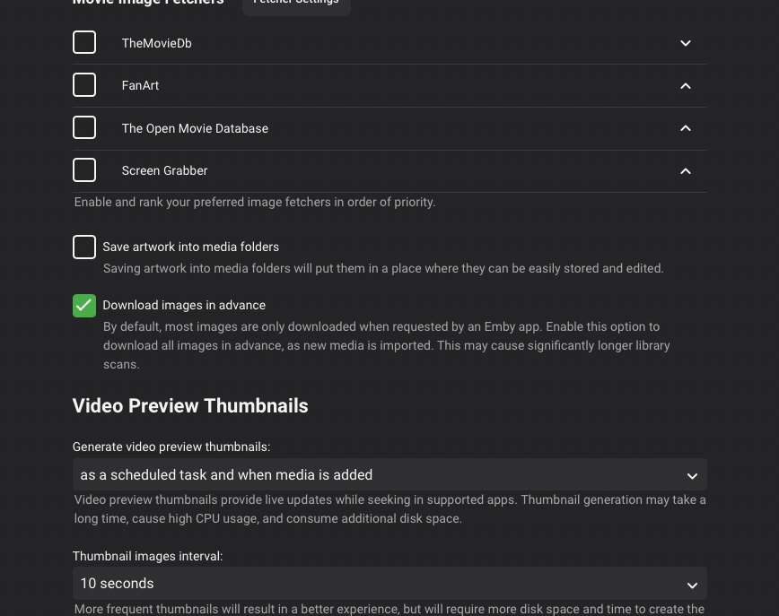

OurfamilySpot 5 Posted January 11, 2022 Author Posted January 11, 2022 (edited) So on my primary server, the artwork for all the videos show up when viewed in a client (the box art that I added to the metadata of all my videos, prior to importing into Emby). The NFO file is generated, and all my metadata show on the files in the library, along people. After the library is sync'd to my other server, and scanned. All the videos show up but with the colored cards instead of the box art. All other metadata seems to be there (assuming its coming for the NFO that is synced). I have all the metadata providers disabled on the slave server, I have NFO selected as a metadata reading I have NFO deselected in Metadata savers (so it isn't overwritten). But I never see the box art, (Video covers) on the slave only the colored cards. I do see that the video preview thumbnails do run and show. Also I am assuming I can safely sync the metadata/people and collections folders between the servers (again only one direction from master to slave). Is that fair? These are from my slave server. Expecting to see this: Got this: Edited January 11, 2022 by OurfamilySpot

Luke 43418 Posted January 11, 2022 Posted January 11, 2022 OK the server's internal metadata folder is not really intended to be used by multiple servers. For the one that downloads metadata, the best thing to do actually would be to enable saving nfo and images to media folders, then the other server will be able to read that information. 1
