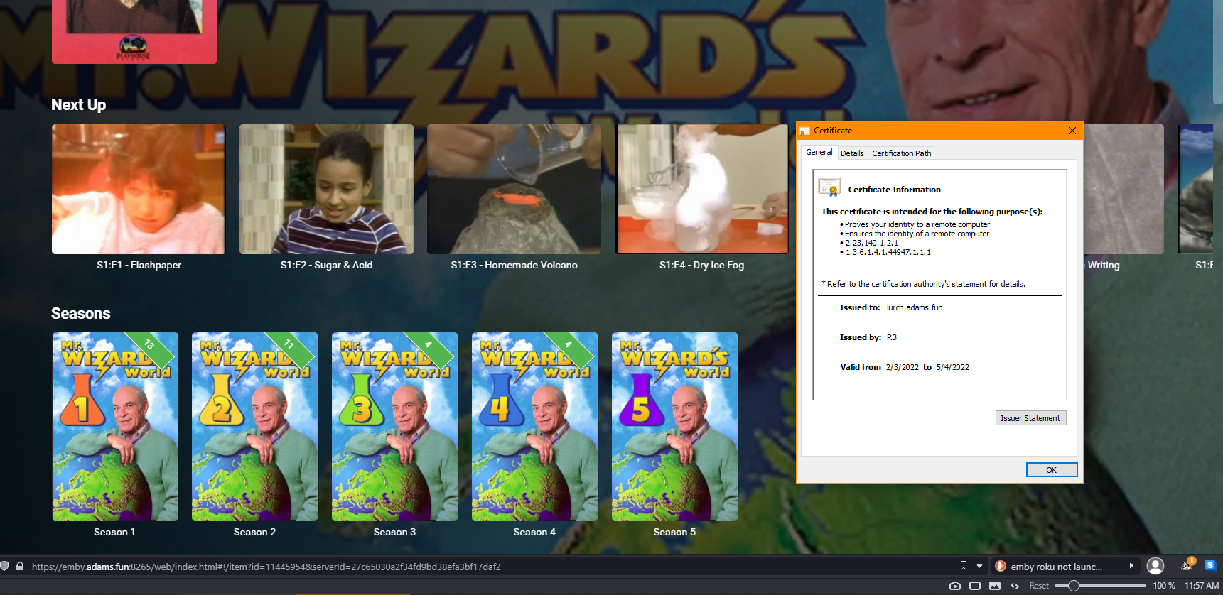

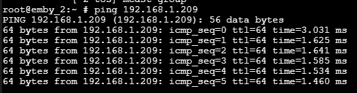

Baenwort 119 Posted February 6, 2022 Posted February 6, 2022 (edited) The cert shows valid for the web browser. It is pulled by another device but includes the emby sub-domain and is valid for it. Here is a fresh start with only access from Roku 'stable' app. embyserver.txthardware_detection-63779744116.txt last thing I did before going to pull the logs was attempt to connect. The Roku's IP is 192.168.1.209 and I can ping it from the Emby Jail. Edited February 6, 2022 by Baenwort
Baenwort 119 Posted February 6, 2022 Posted February 6, 2022 Is there any debugging or logging I can pull from the Roku?

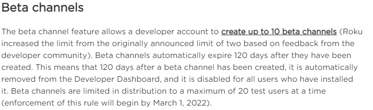

speechles 2062 Posted February 6, 2022 Posted February 6, 2022 (edited) @Baenwort It might make it faster if we could actually reproduce the error. Any chance you can add me (speechles) to your server for testing? If I can see the error in the Roku debug console (app crash) I can figure out what is happening. That will take the load off you as far as chasing the problem. Just PM me and let me know how to login and I can fix it. We are here to help. Also.. The BNN app will be disappearing on Febuary 24th, 2022. It will not be available as a private channel. It will be deleted from your Roku. This is beyond the control of Emby or myself. Unofficial private channels are leaving Roku forever. They will now only allow temporary Beta channels which can exist for 30 days. Keep this in mind as we progress into 2022. Below is the reference from Roku. Here is that "View Online" link too: https://x.email1.roku.com/ats/msg.aspx?sg1=934cba917ad6bf79ca20002cea349ffed32aebfa9054a6aa80620377c826b26a Edited February 6, 2022 by speechles

speechles 2062 Posted February 6, 2022 Posted February 6, 2022 3 minutes ago, Baenwort said: I suspect this means the 'stable' and the 'beta' app are sharing cache or log in details? The Roku has a registry which stores the information per developer ID key number. Rather than juggle keys when updating apps there is a single key that all Emby Roku apps update VIA. This is to make it easier on everyone all the way around. Roku has also recently started to enforce that users are not creating multiple application ID to go over the only 5 applications per developer rule. Roku is cracking down as of February 24th. Keep that in mind.
Baenwort 119 Posted February 6, 2022 Posted February 6, 2022 4 minutes ago, speechles said: The Roku has a registry which stores the information per developer ID key number. Rather than juggle keys when updating apps there is a single key that all Emby Roku apps update VIA. This is to make it easier on everyone all the way around. Roku has also recently started to enforce that users are not creating multiple application ID to go over the only 5 applications per developer rule. Roku is cracking down as of February 24th. Keep that in mind. I think the Beta channel limitation on number of users will be a larger problem as I sometimes switch from stable to beta server chains when bugs crop up. As I recall you need to use the 'beta' app when running the beta server versions. I presume Emby has some method to allow the running of the 'beta' app along with the beta server versions that doesn't need me to install and configure a new 'beta' app every 120 days. from https://blog.roku.com/developer/beta-channels#Rokusunsettingnoncertifiedchannels-Migratinganon-certifiedchanneltoapublicchannel I don't see how the 5 application per developer rule will impact Emby or my use of it as I only run the two "Emby" apps and the Blue Neon app (my son is autistic and doesn't handle change well. We keep the BN app around as the interface matches what Emby looked like when he started being allowed to use the TV).
ebr 16334 Posted February 6, 2022 Posted February 6, 2022 19 minutes ago, Baenwort said: Once there I could use the http port (8096) and connect to the server host 'emby.adams.fun' but when I changed the host to 'https://emby.adams.fun' and the port to 8265 (my https port) I got error code (-60) when I had https:// at the start of the host name and error (-40) when I forgot to include that. Okay, so that tells me it is a certificate problem. Let's Encrypt certs had a root (or maybe intermediate) expire late last year and that caused a lot of issues with older and more strict devices.
Baenwort 119 Posted February 6, 2022 Posted February 6, 2022 5 minutes ago, ebr said: Okay, so that tells me it is a certificate problem. Let's Encrypt certs had a root (or maybe intermediate) expire late last year and that caused a lot of issues with older and more strict devices. The prior cert that was working was issued in November of 2021. This cert I'm under now was issued February 3rd 2022. Is the prior cert in that window?
ebr 16334 Posted February 6, 2022 Posted February 6, 2022 I really am not sure. That is about the time that these issues started cropping up but Roku may have also changed something in the meantime.
