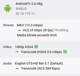

Jammi3D 9 Posted January 9, 2022 Author Posted January 9, 2022 (edited) Hi ebr, He couldn't find the option but after sitting on the phone with him and him explaining the problem it seems to be android devices that have the issues (incl my moblie) .. I got it wrong about files on gdrive working, they have the same issue. If I set an upload limit on his account to force a transcode of the file everything works perfectly fine. DirectPlaying any file causes the loading circle which than eventually closes and goes back to the home screen. Nothing has changed my end, I have a 40Mbps upload & I beleive he is on a 100Mbps download. Most files I encode myself to ensure directplay I've enabled debugging on the server and have attached the main server log file along with recent transcode log files. He is currently streaming from me now with no isssues (upload is limited to 4Mbps to force a transcode) File Specs are usually: Format profile : Main 10@L5@Main Bit rate : 2 360 kb/s Width : 1 920 pixels Height : 960 pixels Audio ac-3 @ 384kbps embyserver.txt ffmpeg-transcode-5bec8da2-21e3-4720-80da-d89038f2444d_1.txt ffmpeg-transcode-a1630ffe-1b5b-495a-9025-e3ba0414dd73_1.txt ffmpeg-transcode-ceda146c-ff0a-4800-aa61-979a3fb82d7e_1.txt Edited January 9, 2022 by Jammi3D 1
