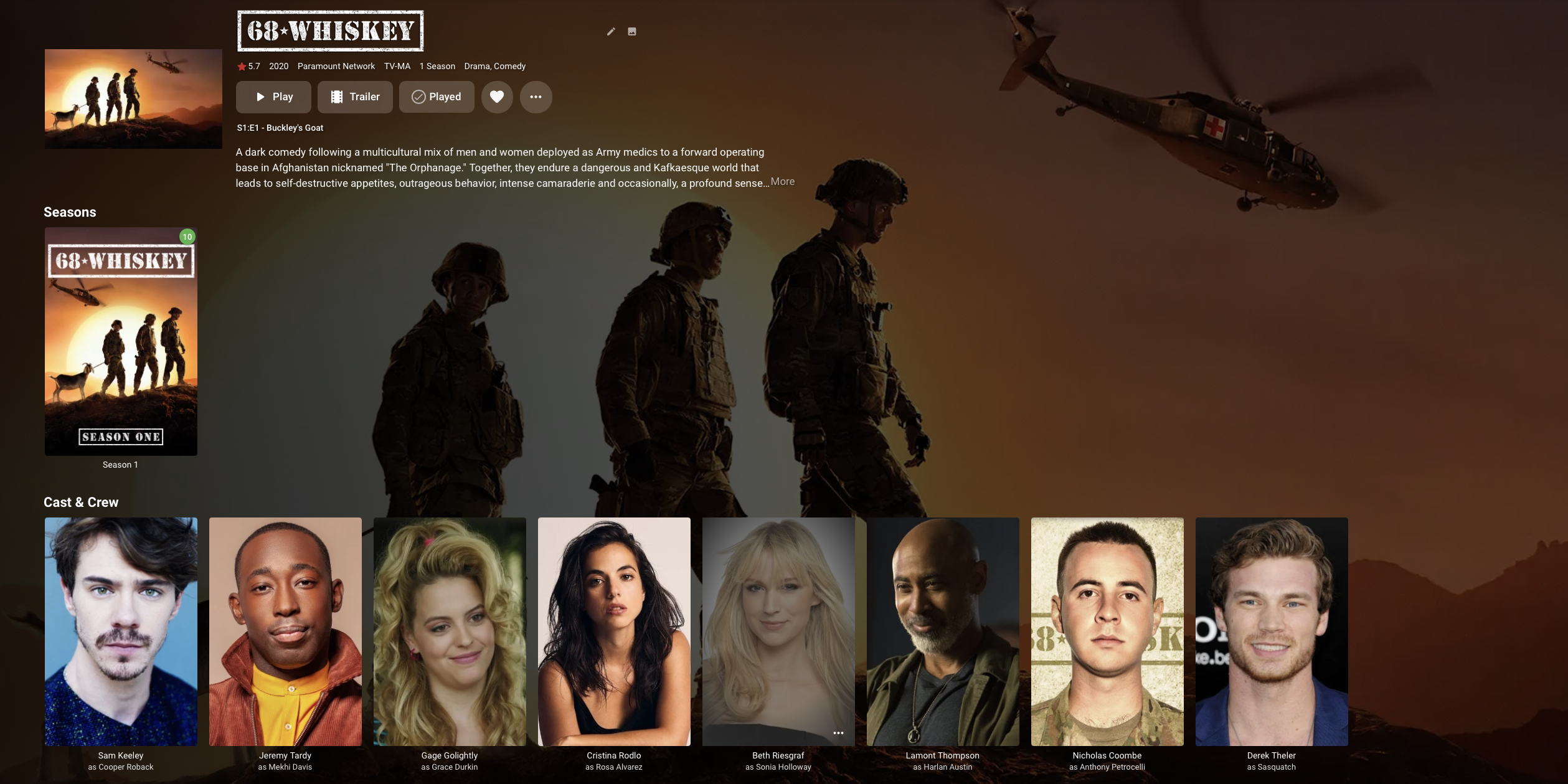

snodrog742 34 Posted January 10, 2022 Author Posted January 10, 2022 8 minutes ago, Luke said: Do you know what item that belongs to? Refreshed '68 Whiskey' and this is what images it puts in. Logs attached as well. embyserver.txt
Luke 42246 Posted January 13, 2022 Posted January 13, 2022 On 1/10/2022 at 3:21 PM, snodrog742 said: Refreshed '68 Whiskey' and this is what images it puts in. Logs attached as well. embyserver.txt 102.58 kB · 2 downloads How did you determine that it's related to this item?
snodrog742 34 Posted January 13, 2022 Author Posted January 13, 2022 (edited) 1 hour ago, Luke said: How did you determine that it's related to this item? When I refresh metadata for this show you can see the line in the log at the same exact time. It also doesn't matter which show. 1000's won't add a Primary image. How do I get this corrected when it's been a week with no actual help? Edited January 13, 2022 by snodrog742
