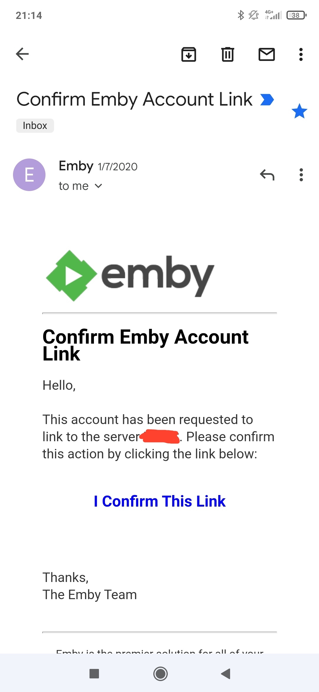

GrimReaper 4902 Posted January 28, 2022 Posted January 28, 2022 Have you ever received an email for account link confirmation?

heroicwisdom 0 Posted January 30, 2022 Author Posted January 30, 2022 On 1/28/2022 at 3:35 PM, GrimReaper said: Have you ever received an email for account link confirmation? Not sure. I searche dmy emails and all i have is a password reset i performed and my emby key. So i don't remember. I dont have any messages saying i need to confirm my account though
GrimReaper 4902 Posted January 30, 2022 Posted January 30, 2022 (edited) 10 minutes ago, heroicwisdom said: Not sure. I searche dmy emails and all i have is a password reset i performed and my emby key. So i don't remember. I dont have any messages saying i need to confirm my account though In your User settings, delete your Connect name, Save, re-enter it (or enter registration email address), Save again. Check your Spam folder. Edited January 30, 2022 by GrimReaper Screen
