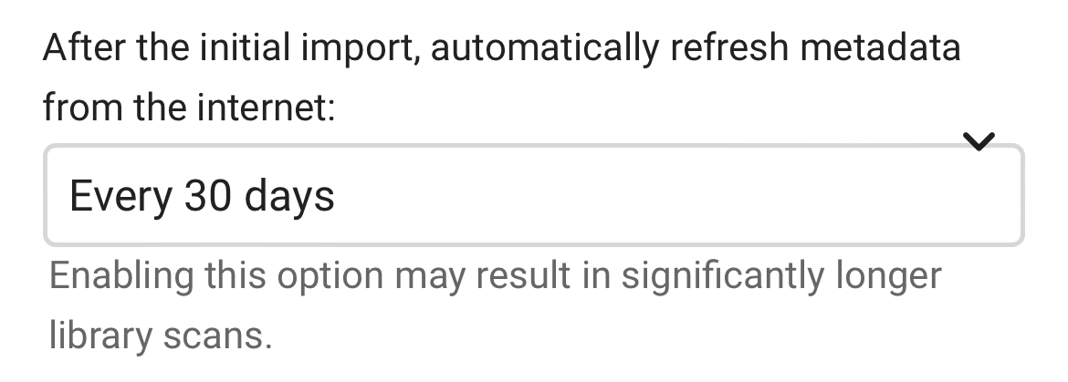

markdj 49 Posted January 5, 2022 Posted January 5, 2022 Hi, I’ve enabled the setting as shown on the screenshot but this doesn’t seem to do anything. I sometimes have to manually refresh shows in order to update (at the time) unavailable plot details and IMDb ratings are always the same no matter what. Is this supposed to create a separate task for the Scheduled Task settings maybe? This happens to both Movies and TV Shows by the way.

markdj 49 Posted January 5, 2022 Author Posted January 5, 2022 (edited) @Luke Episodes that are newly added don’t always have the correct information on TVDb yet. So I wait for a refresh from Emby (sometimes I don’t notice and find out months later) but it never happens. It only updates if I manually update the metadata via the submenu. Except else seems to scrape just fine, it’s just that despite the setting it never runs an update. Same goes for the IMDb scores. They’re always the same so a newly released movie with a score of 7.4 that a week later sits at 6.8 will remain at a 7.4 until I manually refresh the data. Edited January 5, 2022 by markdj

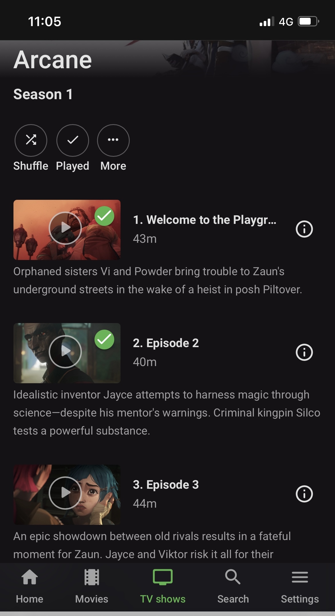

markdj 49 Posted January 6, 2022 Author Posted January 6, 2022 (edited) @Luke Here’s an example, found one thank God. These episode titles are and were never updated (first one being the exception but that added with the initial scan of the show) since the show has been added since its release date. An update never seems to be triggered. Edited January 6, 2022 by markdj
ebr 16309 Posted January 6, 2022 Posted January 6, 2022 Hi. The problem is those fields are filled in. Even though they are filled with "filler" values, they have values and the refresh is looking for fields with no values. Related:
markdj 49 Posted January 6, 2022 Author Posted January 6, 2022 20 minutes ago, ebr said: Hi. The problem is those fields are filled in. Even though they are filled with "filler" values, they have values and the refresh is looking for fields with no values. Related: That’s what I thought. No real solution so far then, I see, except for the script. Maybe some time in the future then.
