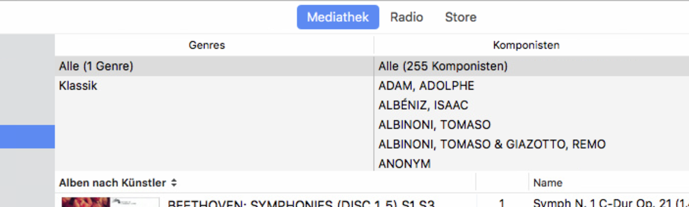

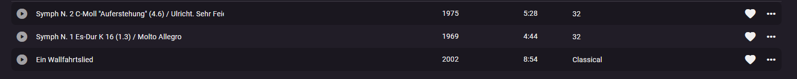

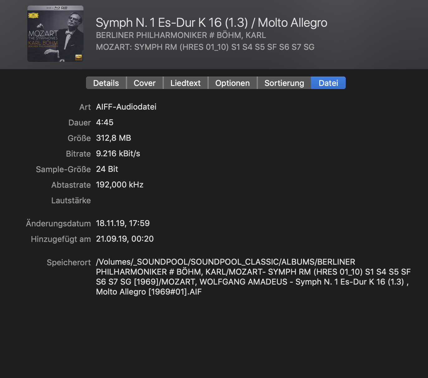

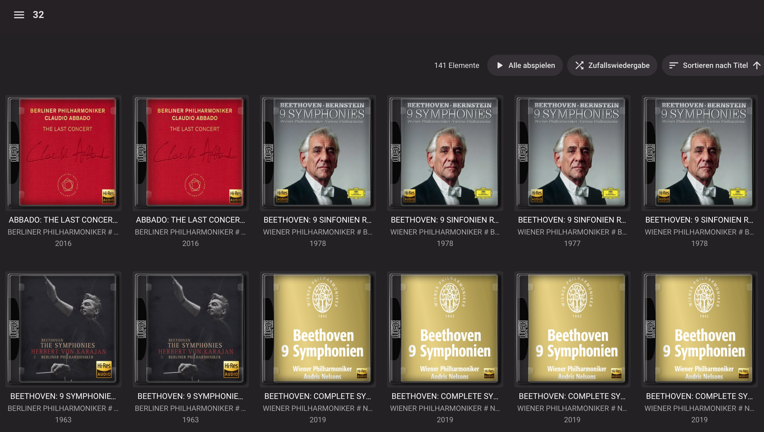

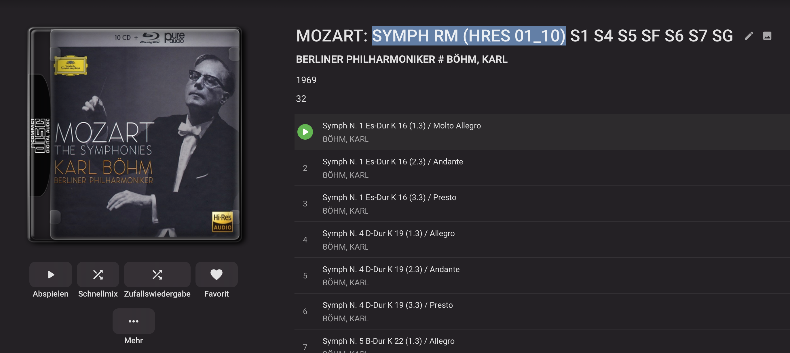

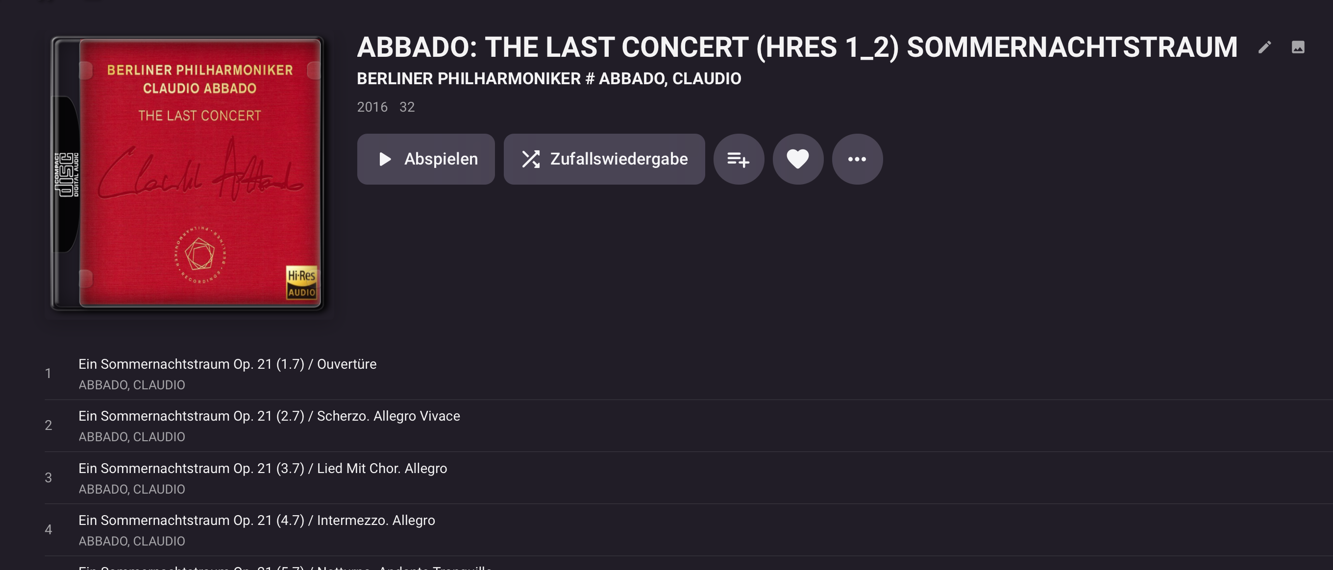

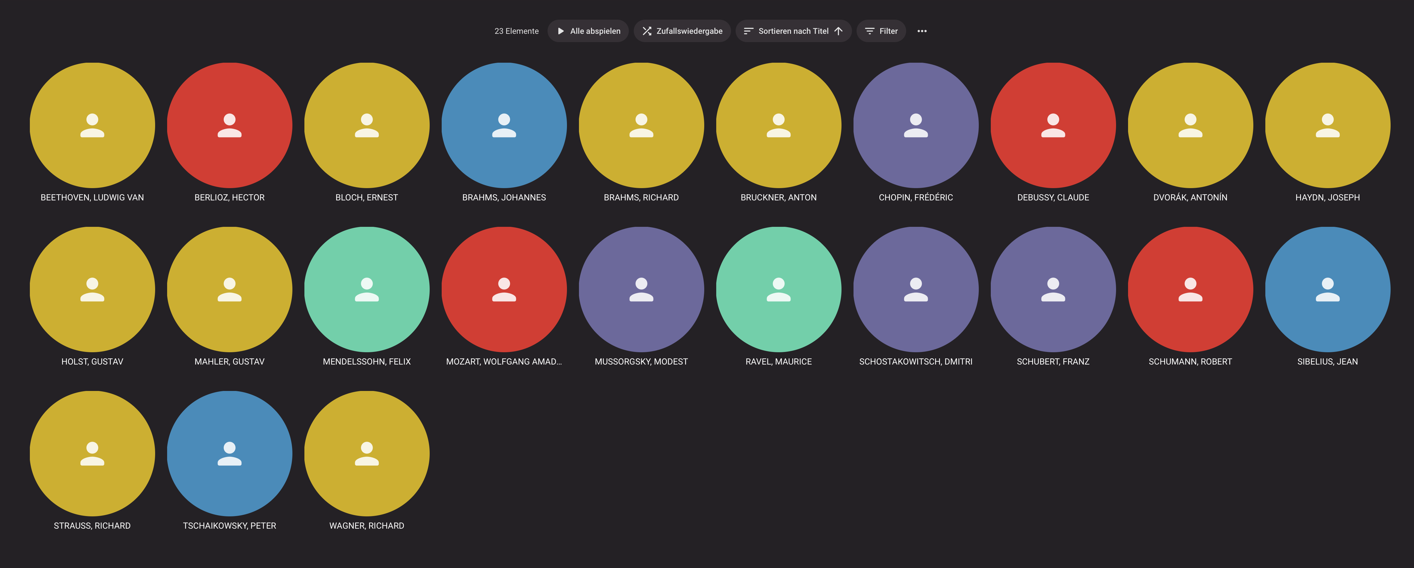

Anderella 13 Posted January 4, 2022 Posted January 4, 2022 I added my classical music library to emby. Basically all my files are uncompressed AIFF, all tagged via iTunes and all organized the same way in artist folders and album subfolders. Possible bug 01: Some files are not recognized correct in genre as "Classical". The wrong genre is: "32" ? Screenshot: 01_Wrong_Genre Possible bug 02: Although all files are tagged the same way, not all composers are listed under emby. (Emby is listing only 23 composers, under iTunes I have 255 - Screenshots: 02_Missing_Composers and 03_Composers_under_iTunes) Example missing composer: Arvo Pärt Screenshot under iTunes: 04_Composer_Pärt_iTunes (with tech Info: 05_Info_iTunes) - Not listed as composer under emby. What I found out myself: It seems that all my HRES files 24 Bit 96 kHz or 24 Bit 192 kHz are wrong listed as genre: 32 BUT the composers of these albums are indexed/recognized in the database. (Screenshots: 06_Hres_Emby, 07_Hres_iTunes, 08_Overview_Wrong_Genre) On the other side: All my 16 Bit 44,1 kHz AIF-files are listed in the correct genre, but the composer-tags of these files are obviously not recognized. Thx for help.

Luke 42240 Posted January 4, 2022 Posted January 4, 2022 Hi there, have you checked the embedded metadata within the tracks using something other than iTunes? You probably have tracks with a genre assigned with just the number 32, and I'm guessing that the Composer value may not be present. Can you provide a sample track for testing?
Anderella 13 Posted January 4, 2022 Author Posted January 4, 2022 Hi there Sorry, I checked the tagging myself before posting, but didn't add the info or the values. Enclosed are three MediaInfo files - to me they seem correct. For cross check I enclose a dropbox link 600 MB (files are too big) of the original audio files - otherwise I can Wetransfer the files if you prefer. https://www.dropbox.com/s/dt75rhtikf49egy/Emby_Audio.zip?dl=0 MAHLER, GUSTAV - Symph N. 2 C-Moll 'Auferstehung' (4.6) , Ulricht. Sehr Feierlich, Aber Schlicht [1975#04].txt MOZART, WOLFGANG AMADEUS - Symph N. 1 Es-Dur K 16 (1.3) , Molto Allegro [1969#01].txt PÄRT, ARVO - Ein Wallfahrtslied [2002#01].txt

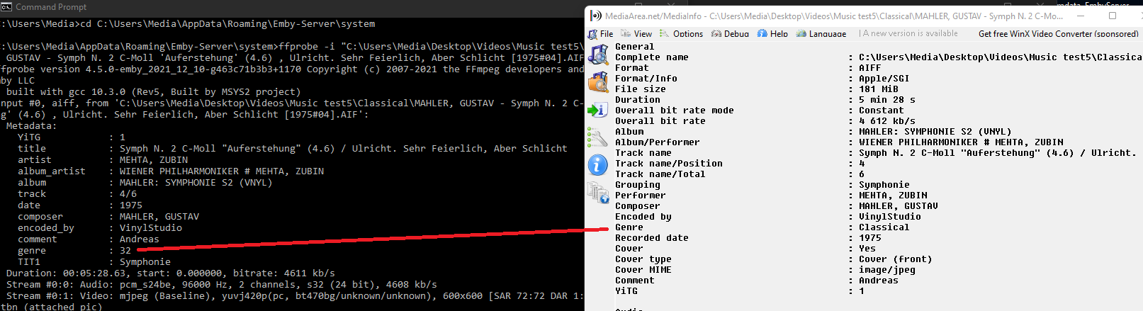

Happy2Play 9811 Posted January 4, 2022 Posted January 4, 2022 (edited) 1) Emby does not have a built-in conversion table like other programs. List of ID3v1 Genres - Wikipedia So Genre 32 is exactly that. But probably something Emby should look at as this has come up a few times. Remember Emby uses ffmpeg/ffprobe to see all embedded metadata, so it really does not matter what other programs show you. Another example ffprobe shows 32 and Media Info shows Classical. 2) @Lukeis TCM linked to Composer? As I see the same issue of TCM/Composer not showing up in this example. PÄRT, ARVO missing Edited January 4, 2022 by Happy2Play

Luke 42240 Posted January 5, 2022 Posted January 5, 2022 Never heard of tcm before but I guess we can support that.

Anderella 13 Posted June 5, 2022 Author Posted June 5, 2022 First: Thank you all for your great support and your work on all this, I really appreciate! Feedback: Just installed current server update 4.7.2.0. TCM error is gone, which is great - Thank you. But genre "32" is still existing on all my high-res audio files..... Do you need as cross-check a sample file?

Anderella 13 Posted June 11, 2022 Author Posted June 11, 2022 Hi, basically all my files are tagged the same way via iTunes (under Windows). Only difference: # 44.1 Audio Files are basically ripped CD tracks (ExactaudioCopy, .wav files), converted to AIF and tagged under iTunes. (Genre interpreted correct) # Recorded H-Res Audio Files, vinyl tracks (96 kHz 24 Bit) with VinylStudio, also tagged afterwards with iTunes. (Genre interpreted correct) # Ripped H-Res Files, via DVD Audio Extractor (Bluray Audio tracks ripped as 96 kHz 24 Bit), also tagged with iTunes. These are not recognized correct (Genre: 32), although ffprobe shows the correct genre: Classical. See enclosed report file. ffprobe-20220611-155510.log

Happy2Play 9811 Posted June 17, 2022 Posted June 17, 2022 On 6/9/2022 at 9:56 AM, Luke said: Are your files actually tagged with just numbers as genres? Yes per the items linked above and shown in screenshot in following post. 5 hours ago, Luke said: Can you provide a sample track for testing? thanks.
Anderella 13 Posted June 18, 2022 Author Posted June 18, 2022 Hi, enclosed are five sample files. 2 Files (Mahler, 96 kHz 24 Bit and Pärt, 44,1 kHz and 16 Bit) I had problems before with composer and genre are working now (with current server version). 3 Files (Mendelssohn, 48 kHz 24 Bit and Wagner, 96 kHz 24 Bit and Mozart, 192 kHz 24 Bit) are still interpreted as genre "32". Thank you both for your help! (Besides: Still any chance to support " # " as a delimiter for artists and composer? (Like ";") - Right now my search "Mozart Böhm RM" doesn't find the enclosed Mozart track.) Dropbox Link

Anderella 13 Posted June 27, 2022 Author Posted June 27, 2022 Thank you for your input, would be great, if this could be implemented. Did my sample files help with genre 32?
Luke 42240 Posted June 28, 2022 Posted June 28, 2022 Hi, yes and currently at this time we just import those as plain numbers.
softworkz 5133 Posted June 30, 2022 Posted June 30, 2022 @Anderella - thanks, your samples were indeed helpful. The ID3v2 tags were from different versions of the spec: MAHLER, GUSTAV - Symph N. 2 C-Moll 'Auferstehung' (4.6) , Ulricht. Sehr Feierlich, Aber Schlicht [1975#04] [file @ 00000293D82606C0] Setting default whitelist 'file,crypto,data' [aiff @ 00000293D829A880] Format aiff probed with size=2048 and score=100 [aiff @ 00000293D829A880] id3v2 ver:3 flags:00 len:155446 [aiff @ 00000293D829A880] Before avformat_find_stream_info() pos: 4096 bytes read:188232 seeks:2 nb_streams:2 MENDELSSOHN, FELIX - Ein Sommernachtstraum Op. 21 (4.7) , Intermezzo. Allegro [2016#04] [aiff @ 000001536742FA40] Format aiff probed with size=2048 and score=100 [aiff @ 000001536742FA40] id3v2 ver:4 flags:00 len:138973 [aiff @ 000001536742FA40] Before avformat_find_stream_info() pos: 54 bytes read:171759 seeks:2 nb_streams:2 MOZART, WOLFGANG AMADEUS - Symph N. 1 Es-Dur K 16 (1.3) , Molto Allegro [1969#01] [aiff @ 000001A9A4971540] Format aiff probed with size=2048 and score=100 [aiff @ 000001A9A4971540] id3v2 ver:4 flags:00 len:94554 [aiff @ 000001A9A4971540] Before avformat_find_stream_info() pos: 54 bytes read:127340 seeks:2 nb_streams:2 PÄRT, ARVO - Ein Wallfahrtslied [2002#01] [aiff @ 000002F229D6FA40] Format aiff probed with size=2048 and score=100 [aiff @ 000002F229D6FA40] id3v2 ver:2 flags:00 len:26227 [aiff @ 000002F229D6FA40] Before avformat_find_stream_info() pos: 54 bytes read:59013 seeks:2 nb_streams:2 WAGNER, RICHARD - Rheingold (02.44) - 1. Sz , Weia! Waga! Woge, Du Welle! [1970#02] [aiff @ 000002227365D780] Format aiff probed with size=2048 and score=100 [aiff @ 000002227365D780] id3v2 ver:4 flags:00 len:108389 [aiff @ 000002227365D780] Before avformat_find_stream_info() pos: 54 bytes read:141175 seeks:2 nb_streams:2 Regarding the TCON field, there has been a change between v2.3: https://id3.org/id3v2.3.0#Text_information_frames_-_details and v2.4: https://id3.org/id3v2.4.0-frames (search TCON) in the way that since v2.4, no braces are required anymore around the number. ffmpeg/ffprobe do not properly implement this for v2.4 and still expect braces. Your files are correct. I have fixed this now in our ffmpeg. The fix will be probably in the next beta (or one after). Thanks a lot for reporting! 1
