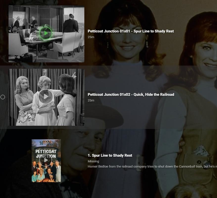

GregMo 24 Posted January 3, 2022 Posted January 3, 2022 (edited) Can anyone point me to a log file or some such that I can look into to debug file name scrapping? The following series, for some reason, will not scrape with the 1x01 format. If I rename it with s1e1 it does it fine, but I don't want to have to rename the whole series and there's no good reason that it shouldn't find this one as it does fine with many others named the same way. Edited January 3, 2022 by GregMo

GregMo 24 Posted January 3, 2022 Author Posted January 3, 2022 (edited) The filenames are shown in the image, just add an ".mkv" onto the end of them. Edited January 3, 2022 by GregMo
