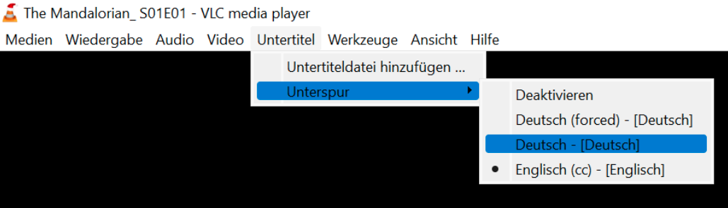

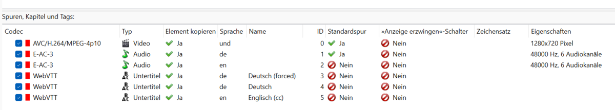

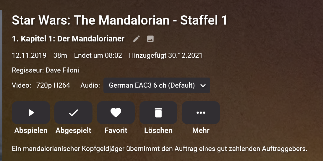

Florian2000 17 Posted December 31, 2021 Author Posted December 31, 2021 12 hours ago, Luke said: Hi, did you run a library scan after changing the file? yes, I always do. The interesting thing is that the additional audio language is there for selection. Only the subs are missing. subtitles according to VLC: the container format is mkv. The tracks within MKVToolNix:

Happy2Play 9802 Posted January 1, 2022 Posted January 1, 2022 @Lukedoes it matter that the subs at least from image above are internal "WebVTT"? In a test Emby only sees external VTT not internal VTT.
Happy2Play 9802 Posted January 1, 2022 Posted January 1, 2022 Additional info from ffrpobe Stream #0:4(chi): Subtitle: none (default) Metadata: BPS : 43 DURATION : 01:49:14.664000000 NUMBER_OF_FRAMES: 983 NUMBER_OF_BYTES : 35681 Unsupported codec with id 0 for input stream 4 Media info Text #2 ID : 5 Format : S_TEXT/WEBVTT Codec ID : S_TEXT/WEBVTT Duration : 1 h 49 min Bit rate : 43 b/s Count of elements : 983 Stream size : 34.8 KiB (0%) Language : Chinese Default : Yes Forced : No Looks like it maybe an old open defect. #5641 (Support WebVTT according to MKV specs) – FFmpeg

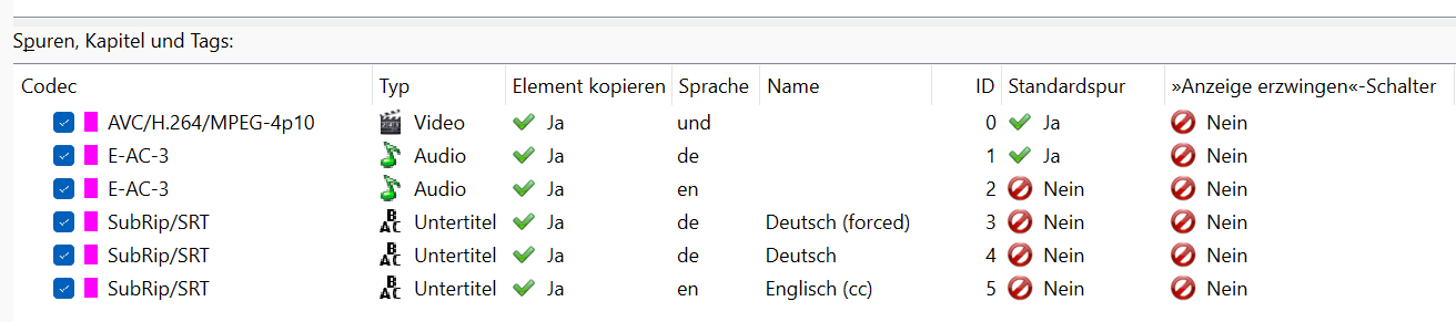

Luke 42197 Posted January 4, 2022 Posted January 4, 2022 it looks like ffmpeg currently does not support this, so your best bet for now is to either keep them external, or embed them as a different text format such as subrip.
