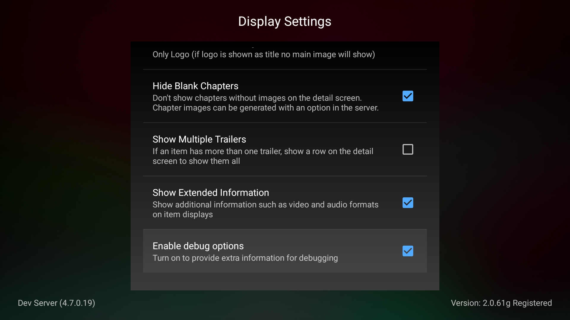

GrimReaper 4898 Posted December 30, 2021 Posted December 30, 2021 4 hours ago, westhill said: so I enabled debug mode and reproduced the error and have the line number in the logs. Are you sure you've enabled in-app Debug mode (Settings>General Display tab>scroll all the way down)? Above sounds to me like you've enabled debug logging server-side (in the Web UI).
westhill 5 Posted December 30, 2021 Author Posted December 30, 2021 Got it, thank you. I had enabled debug in the app, collected logs from the server and have DMd them to Like and Ebr. I had since turned off debug, hence why I was not seeing the option. Are the logs sent by the app the same as the server side apps?

ebr 16337 Posted December 31, 2021 Posted December 31, 2021 Hi. You need to enable this option here: ...and then you will get the send logs option in your user menu.
