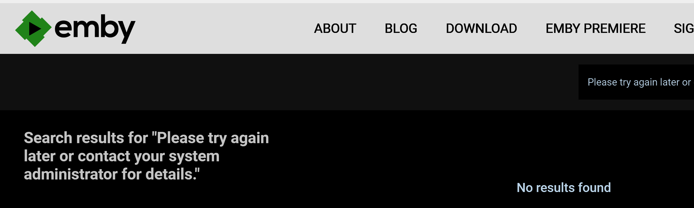

instrumentally 8 Posted December 29, 2021 Author Posted December 29, 2021 (edited) I searched the Knowledge Base for "Please try again later or contact your system administrator for details." and got ZERO results. So what exactly have I done wrong by posting my question here? Edited December 29, 2021 by instrumentally
Happy2Play 9802 Posted December 29, 2021 Posted December 29, 2021 3 minutes ago, instrumentally said: I searched the Knowledge Base for "Please try again later or contact your system administrator for details." and got ZERO results. So what exactly have I done wrong by posting my question here? Dev/Admin is asking for server logs (general information of a specific example). Sure, the video shows an issue, but a log can possibly identify the cause of the issue. Majority of the time it is a path change issue. 1
