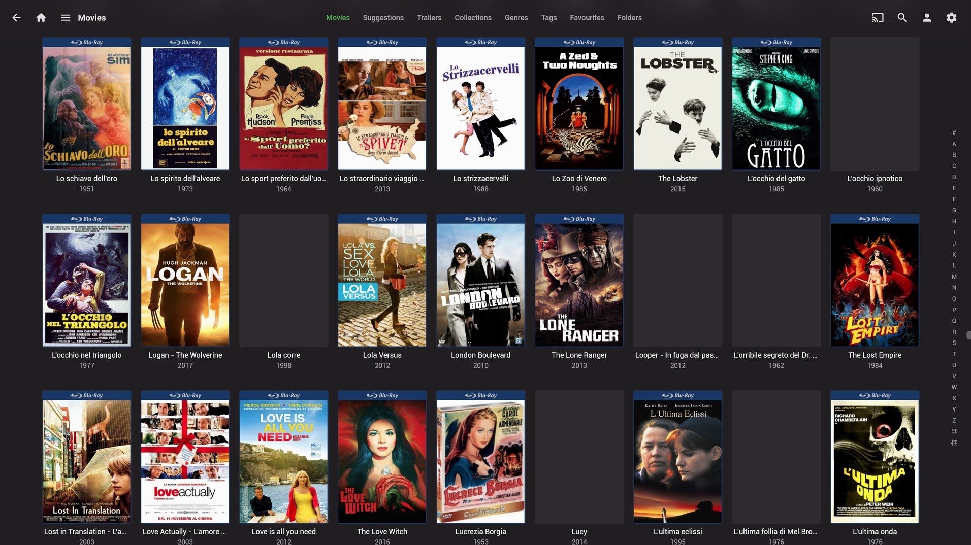

jan_axhell 4 Posted December 31, 2021 Author Posted December 31, 2021 I swear I don't understand what you mean. I've asked in community, described the problem as blind, included logs. You mean I haven't mentioned version? It's the latest, 4.6.7.0 for Windows, but that info is in the logs.. Here is a screenshot. It is taken with no HDD connected, all you see is cached. For some reason the are holes. The art that goes there is present on the HDDs. If I rescan them, some art reappears and some other disappears. It's like there is a limit beyond which Emby doesn't want to go. The first 5 HDDs produced no hole.
