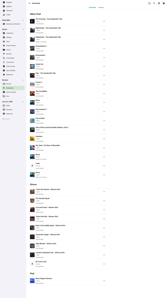

Luke 42197 Posted January 7, 2022 Posted January 7, 2022 @simonmason I would check the Downloads and Conversions sections of the emby server dashboard. It sounds like you created either Download or Conversion jobs that required transcoding, and this is where the files go until they are delivered to their destination. Please let me know the contents of those sections. Thanks.

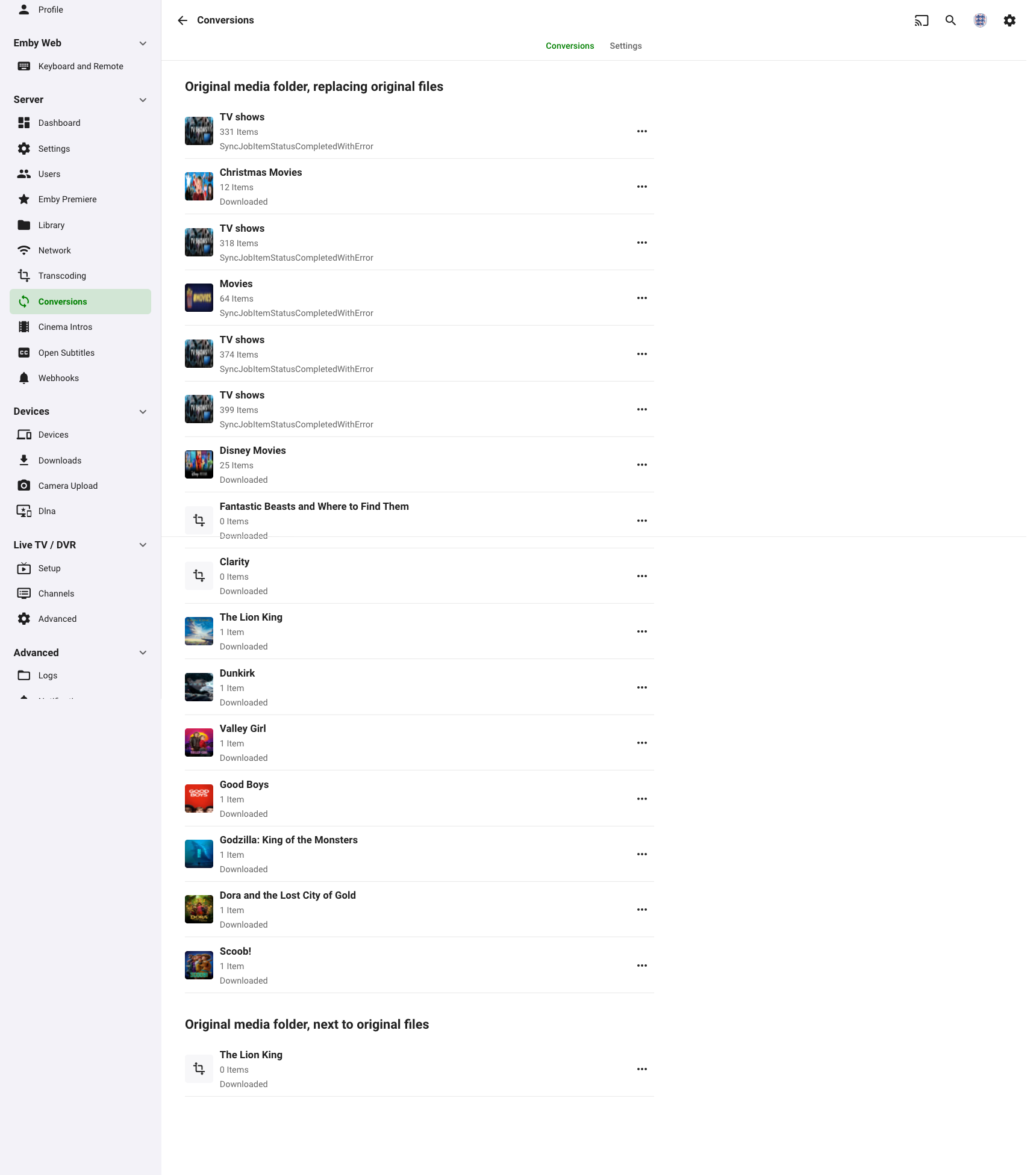

Luke 42197 Posted January 7, 2022 Posted January 7, 2022 OK, it's difficult to try and determine what might have happened in the past, but looks like some of these jobs did not complete successfully. You created conversion jobs to convert and replace your existing media. One possible reason for the problem could be that the conversion succeeded, but then the server did not have write access to actually replace the original media files. Additionally you also created multiple conversion jobs on your entire TV library. I would suggest going to all of the jobs that say completed with error and deleting all of them.
simonmason 19 Posted January 7, 2022 Author Posted January 7, 2022 @Luke I removed all of these. Hasn’t reduced the disk usage under sync but maybe that takes some time? Also, a long time ago I set up a conversion job on several folders to set all files to a standard size - mostly to reduce 4K files. But I find I don’t need that as much now. So how do I remove it? I see an option to remove downloads when I click on the conversion job. Is that what I use? Thanks.
Luke 42197 Posted January 9, 2022 Posted January 9, 2022 On 1/7/2022 at 6:48 PM, simonmason said: @Luke I removed all of these. Hasn’t reduced the disk usage under sync but maybe that takes some time? Also, a long time ago I set up a conversion job on several folders to set all files to a standard size - mostly to reduce 4K files. But I find I don’t need that as much now. So how do I remove it? I see an option to remove downloads when I click on the conversion job. Is that what I use? Thanks. Yes that's what you do. If the files associated with that particular conversion job are not getting deleted, then it's possible the server is being denied access to delete within that folder, so that could be something to look into. We'd have to look at an example though. Thanks.
