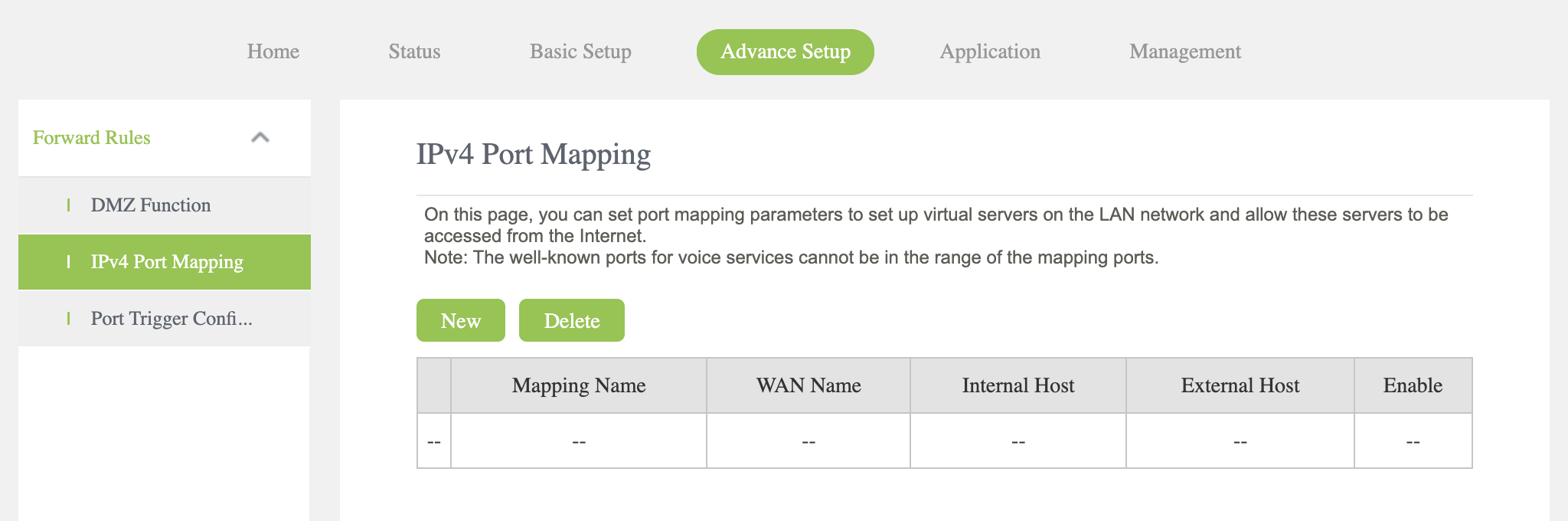

longstreath 8 Posted December 27, 2021 Author Posted December 27, 2021 Hi Carlo, As an update to the above, I have managed to get the Username/Password combo from the provider so can access the router setup. Not sure if this is of any help, but when looking at the settings there is this dialogue in the Advanced tab:
Luke 42243 Posted December 28, 2021 Posted December 28, 2021 @longstreath I would try adding port mapping and let us know if that helps. Thanks. https://support.emby.media/support/solutions/articles/44002137137-remote-setup
