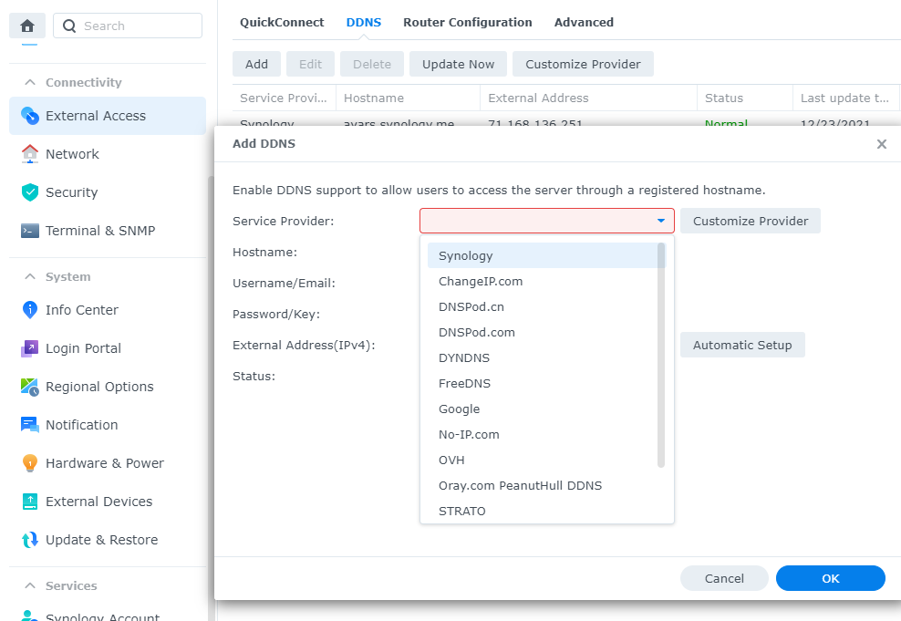

Carlo 4561 Posted December 23, 2021 Posted December 23, 2021 Hi, we need some additional info so let me ask a few questions: Has this ever worked for you previously? Is your Emby Server setup for remote access? Are you trying this on the same LAN as your Server or are you remote from it? If setup remotely do you use a DDNS service? If not you might want to as it's easy to setup and then you likely wouldn't need Emby Connect. Are you able to log into your Emby server using it's IP and the username/password as setup directly on the server?

Carlo 4561 Posted December 24, 2021 Posted December 24, 2021 17 hours ago, EmbyUser149 said: I'm having the same issue. New premium user, never connected via Emby Connect outside my LAN before and it works just fine on my LAN. Emby Server running on Synology NAS. Configured for Premium, configured for emby connect, remote connections allowed, firewall is not set to block. No port forwarding is set up on the Asus router because as I understand to purpose of Emby Connect, it saves the user from having to set that up. You need to make sure ports are forwarded on your router correctly or no inboard traffic will make it to your Emby Server. If you stick with the default port of 8096 you should be fine but don't try to change the ports to 80 or 443 until you get it working correct with the defaults. Reason is you will have an issue with the built in reverse proxy in DSM and will need to adjust it or it will forward your traffic to port 5000 (DSM desktop). From your home LAN after forwarding tcp port 8096 open https://canyouseeme.org Type in port 8096 and run a test. If it fails there is still a problem but if it passed the test the port is open and remote access can work. Then you can setup and use Emby Connect but I'd ask why you want to use it? Likely your router has DDNS built in. But definitely this feature is built into Synology. Control Panel, External Access, DDNS They have a whole bunch of different services they can update for you or you can use the first one Synology which will be handled by them. So if you were to choose synology they will ask you for a host name. If you were to enter "rip" then you would get a fully qualified domain as rip.synology.me. You could then skip Emby Connect and it's management and just use port 8096 and rip.synology.me which is easy to remember and a whole lot less work.
