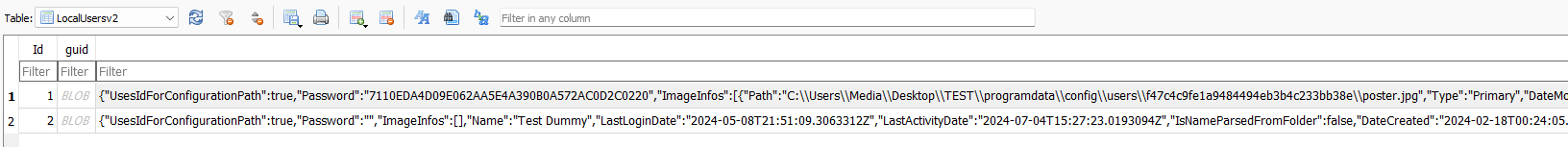

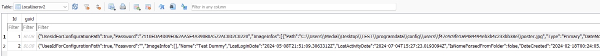

Happy2Play 9814 Posted September 26, 2024 Posted September 26, 2024 (edited) 14 minutes ago, parhamsan said: I just created a backup of the users.db (users.db.backup) on the Unraid and copied the users.db from windows backup folder and when I started emby it kept spinning and didn't get into to the main screen, so no go with this method! How do I do this: "You could go into each db to verify each use has the same ID" and what do you suggest if I want to at least see the current passwords for the users? Is there anyway to extract them from old database? I don't what to start asking the 20 users the same question, and don't want to restore form old backup since it corrupted my database! Thanks. Not sure without seeing server log to see if anything was logged as dbs are sort of match with the backup process maintaining all. But the user passwords are hashed/salted in the db. But open the dbs in any viewer and copy from one to the other. Example from a test server ie two users index/id 1 and 2 so 1 and 2 correspond to the usersdatas table in the library.db tracking userdata. So that is where I was getting to about creation when recreating. But you could copy the data per user from one db to another as it will show the name for each. Edited September 26, 2024 by Happy2Play

parhamsan 17 Posted September 26, 2024 Posted September 26, 2024 Well, I understand that cross platforming could create issues, but extracting users data did not bring images back nor the passwords. Happy2Play, What if I delete all the users (except the admin) from the new emby server and then add them one by one from the backup (windows) users.db to the new one? Will that work? please help me out here!!!

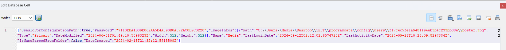

parhamsan 17 Posted September 26, 2024 Posted September 26, 2024 Happy2Play, I opened both users.db from windows and Unraid. I see that the password for me (admin), on both windows and Unraid are the same. I also know which user is who. Will it work if I append the passwords contents (from the windows users.db) to each user to the users.db (for the Unraid) and overwrite it? Does something like this makes sense? Thanks.
parhamsan 17 Posted September 26, 2024 Posted September 26, 2024 BTW tried the method I mentioned above and worked like a charm!!! If anyone is interested I can explain how I did it. Thanks for the hints @Happy2Play!!! 1
