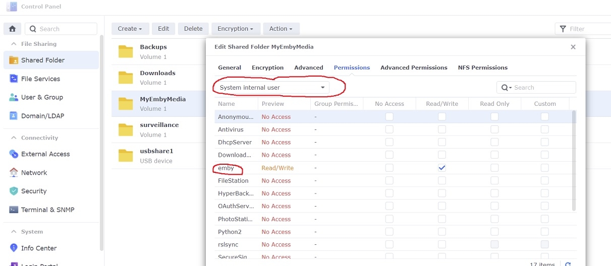

Happy2Play 9812 Posted December 21, 2021 Posted December 21, 2021 Moving to Synology section What DSM version? If DSM 7 did you verify internal user on your Shares?

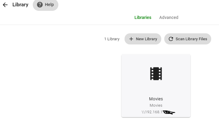

narayansmate 4 Posted December 21, 2021 Author Posted December 21, 2021 So, I think the real problem is: how do I point Emby towards the network share? I don't seem to be able to access it or find it, per the attached image. Is it the IP address or?? Sorry, and thanks.

Solution FrostByte 5454 Posted December 21, 2021 Solution Posted December 21, 2021 Here is an example of my Movies library. MEDIA-SERVER is my NAS name, but you could use the IP MyEmbyMedia is the share name I'm using just like the pic H2P posted earlier. Underneath the share is a folder for the library Movies Underneath Movies I have folders for each movie

FrostByte 5454 Posted January 12, 2022 Posted January 12, 2022 1 hour ago, aflagator said: Having similar issues but with Synology DS420j running DSM 7.0.1-42218 and Emby version 4.6.7.0. Odd, when installed EMBY, EMBY user was changed to 'EMBY__PKG_' I have granted read/write to this user to the Share Drive location where the Video is located. Also pointed the EMBY to the /volume1/Movies_1 share folder. It see's the folder, just no content. I too am very new to this NAS and EMBY, so any help would be appreciated. Thanks in advance. Ignore that other user. The only user you need under DSM 7 is the "System internal user" Emby. You will need to use the dropdown box to see it when setting the read/write permissions on the shares.
aflagator 3 Posted January 12, 2022 Posted January 12, 2022 Thanks, but with the Synology Version DSM 7.0.1-42218, I don't have a drop down box for determining if this is a "System Internal User'. If I try and add user EMBY, it says that name is already built or reserved for system use. (I only see this as a pop-up on the user name field once added; the user name field changes to a red outlined box and if you move the move to that user/name field, it will display pop-up). I cannot find anywhere to modify system users. Any thoughts? Anb thanks so much.
FrostByte 5454 Posted January 12, 2022 Posted January 12, 2022 It's under the permissions for shared folders. The install "should" have automatically created the System internal user called 'Emby' Emby doesn't use local users for permissions on Synology anymore. You can delete them all if you wish.
aflagator 3 Posted January 12, 2022 Posted January 12, 2022 Thanks, I appreciate the guidance. With your screen shot as guidance, I finally found the section within Permissions with System user option. It's working. I was told EMBY support was good. You more than proved it! Thanks very much. Next step is getting it to pull from smart TV/Emby app and then it will be Emby Premier for me due to the great response from you. Again, thanks. 2 1
