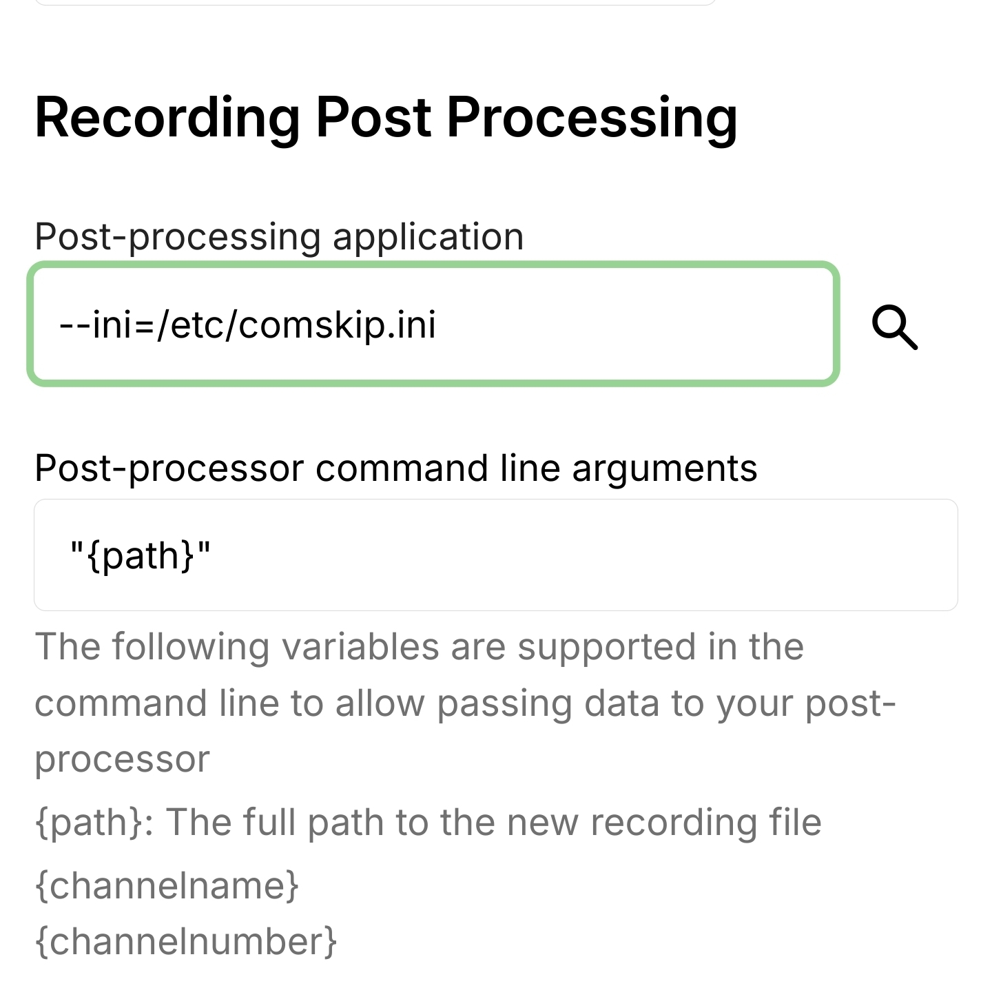

TMCsw 260 Posted July 24, 2025 Posted July 24, 2025 14 hours ago, Ranse said: Any help would be appreciated ! First there needs to be two(2) '-' for the ini ie "--ini=/etc/comskip.ini" second as Bill shows you need to use "{path}" not "{emby/Recordings}" (emby will supply the full path and file name with just "{path}".) If that fails you may need to call an .sh script instead...
Ranse 6 Posted July 25, 2025 Posted July 25, 2025 7 hours ago, TMCsw said: First there needs to be two(2) '-' for the ini ie "--ini=/etc/comskip.ini" second as Bill shows you need to use "{path}" not "{emby/Recordings}" (emby will supply the full path and file name with just "{path}".) If that fails you may need to call an .sh script instead... Hi thanks for the reply, Is this correct?
Ranse 6 Posted July 25, 2025 Posted July 25, 2025 8 hours ago, TMCsw said: First there needs to be two(2) '-' for the ini ie "--ini=/etc/comskip.ini" second as Bill shows you need to use "{path}" not "{emby/Recordings}" (emby will supply the full path and file name with just "{path}".) If that fails you may need to call an .sh script instead... can you please provide an example for shell script?
TMCsw 260 Posted July 26, 2025 Posted July 26, 2025 21 hours ago, Ranse said: Is this correct? No, should be: /usr/local/bin/comskip --ini=”/etc/comskip.ini" “{path}” 1
Ranse 6 Posted July 26, 2025 Posted July 26, 2025 (edited) 4 hours ago, TMCsw said: No, should be--ini=”/etc/c“{path}” Edited July 26, 2025 by Ranse
Ranse 6 Posted July 26, 2025 Posted July 26, 2025 4 hours ago, TMCsw said: No, should be: /usr/local/bin/comskip --ini=”/etc/comskip.ini" “{path}” Ok changed it , but it does not generate new .edl files in the folder. Is there a way to force it?

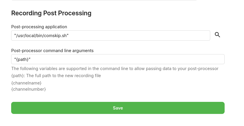

TMCsw 260 Posted July 29, 2025 Posted July 29, 2025 Try creating a .sh file that contains the following: #!/bin/bash LD_LIBRARY_PATH='' "/usr/local/bin/comskip" --ini=”/etc/comskip.ini” “$1” Make it executable and in a directory that emby can access. Say : "/usr/local/bin/myskipper.sh" Then call it in emby like this: 1
Ranse 6 Posted July 29, 2025 Posted July 29, 2025 4 hours ago, TMCsw said: Try creating a .sh file that contains the following: #!/bin/bash LD_LIBRARY_PATH='' "/usr/local/bin/comskip" --ini=”/etc/comskip.ini” “$1” Make it executable and in a directory that emby can access. Say : "/usr/local/bin/myskipper.sh" Then call it in emby like this: Ok done, thanks again for your help, I'll report back when I have something new.
