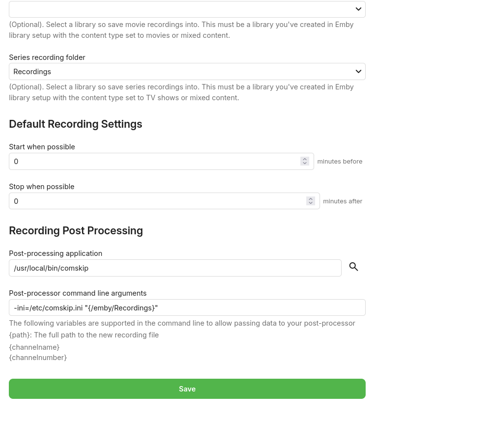

abescalamis
I tried to install comskip to Ubuntu 24.04, for some reason the following no longer works as it did before, everything worked up to ./configure command.  The "make" and sudo make install didn't work, it looks like something change in Ubuntu 24.04.
sudo apt-get update
sudo apt-get install ffmpeg libavcodec-dev libavformat-dev libavutil-dev autoconf automake git libargtable2-dev libtool
git clone https://github.com/erikkaashoek/Comskip
cd Comskip
./autogen.sh
./configure
make
sudo make install
instead I used the following to install comskip:
sudo apt install comskip

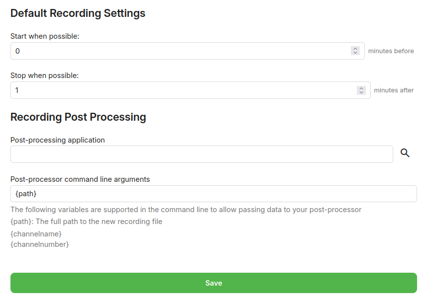

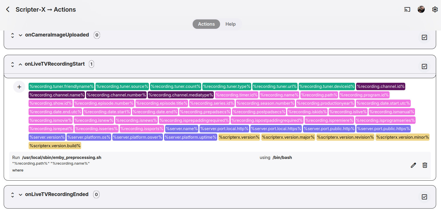

abescalamis
successfully got comskipper and comskip to work using the "Recording Post Processing" but need help with real time processing.
1) Steps taken for "Real Time Processing" - I'm using ubuntu, and confirmed the emby_preprocessing.sh works using the following command.
$ cd /usr/local/sbin/
$ ./emby_preprocessing.sh '/mnt/Emby/Shows/Test/sample_recording.ts'
2) also confirmed live_tv=1 in /ect/comskip.ini is enabled.
3) Made the bash file executable with the following command:
$ sudo chmod +x /usr/local/sbin/emby_preprocessing.sh
Since I'm trying to set real time processing, I cleared post processing (post processing works perfect)
embyserver.txt media.txt
Edited by abescalamis
First "%recording.path%" in SX is the is the same as  "{path}" in post processing, why are you adding "%recording.name%" ? Also you may need to add a ‘sleep X’ of say about 5sec before calling Comskip.
Otherwise would need to see the contents of ‘/usr/local/sbin/emby_preprocessing.sh’ to diagnose…
abescalamis
I followed a guide posted here, but did the changes you said, after troubleshooting the sleep time like you pointed out,  came out to believe that my issue for "real time processing" is that my computer takes 26 seconds to create the .edl of a 30 minute show, I tested by giving the .sh a 20 minute sleep and it process the .ts video in a few seconds and generated the EDL. but since my PC does it to fast the EDL is incomplete.
I will use post processing instead based on the above, it seems that if you machine is fast the "real-time processing wont work", no point anyways since only 26 seconds to process a 30 minute show.

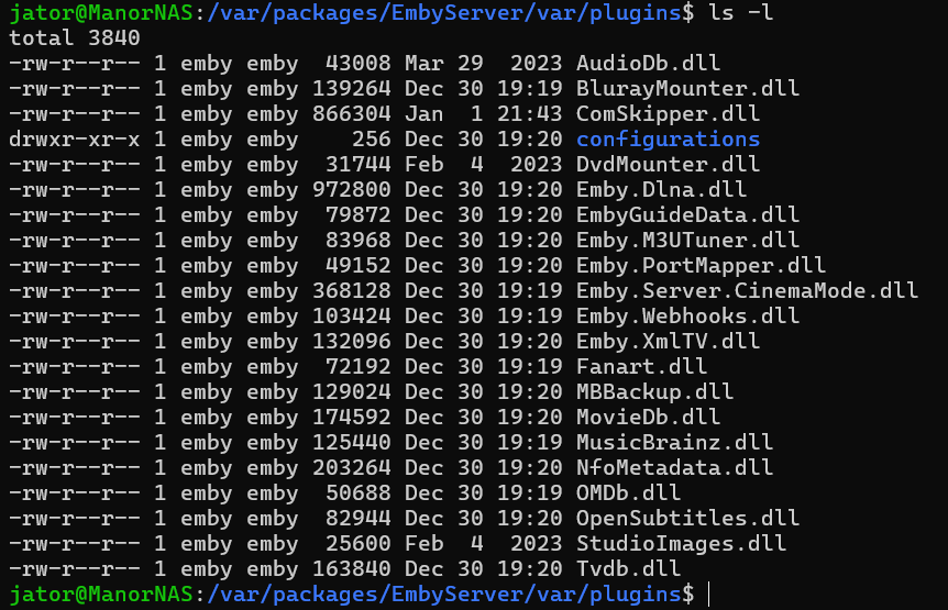

Trying to trouble shoot why the plugin isn't showing on my server.  Here's where I have installed the .dll:
I've rebooted the server, including shutting it down completely (I used SynologyNAS platform), but still don't see it showing up in my Plugin Library.  Any suggestions?
@BillOatmanchanged/updated something and the the latest version doesn't work for me on Linux either can you find and replace the ComSkipper.dll with version 2.1.0.0 ? it works great!
So making a little progress.  Found in the log that one of the locations I had placed the .dll had root privilidges and couldn't be read:
2025-01-03 07:26:04.601 Info App: File /var/packages/EmbyServer/var/plugins/ComSkipper.dll has version 2.1.1.0
2025-01-03 07:26:04.614 Error App: Error getting version number from /volume1/@appstore/EmbyServer/system/plugins/ComSkipper.dll
so I corrected that
2025-01-03 07:41:02.903 Info App: File /var/packages/EmbyServer/var/plugins/ComSkipper.dll has version 2.1.1.0
2025-01-03 07:41:02.945 Info App: File /volume1/@appstore/EmbyServer/system/plugins/ComSkipper.dll has version 2.1.1.0
Rebooted the server but the plugin is still not showing up in the plugin to be configurable.  I do show the below error further down in the logs, but it doesn't reference Comskipper so not sure it applies.

	   at System.Reflection.RuntimeModule.GetTypes(RuntimeModule module)
	   at System.Reflection.Assembly.GetTypes()
	   at Emby.Server.Implementations.ApplicationHost.GetTypes(Tuple`2 assemblyInfo)
	System.IO.FileNotFoundException: Could not load file or assembly 'MediaBrowser.Common, Version=4.8.10.0, Culture=neutral, PublicKeyToken=null'. The system cannot find the file specified.
	File name: 'MediaBrowser.Common, Version=4.8.10.0, Culture=neutral, PublicKeyToken=null'
	System.IO.FileNotFoundException: Could not load file or assembly 'MediaBrowser.Controller, Version=4.8.10.0, Culture=neutral, PublicKeyToken=null'. The system cannot find the file specified.
	File name: 'MediaBrowser.Controller, Version=4.8.10.0, Culture=neutral, PublicKeyToken=null'
	System.IO.FileNotFoundException: Could not load file or assembly 'MediaBrowser.Model, Version=4.8.10.0, Culture=neutral, PublicKeyToken=null'. The system cannot find the file specified.
	File name: 'MediaBrowser.Model, Version=4.8.10.0, Culture=neutral, PublicKeyToken=null'
	Source: System.Private.CoreLib
	TargetSite: System.RuntimeType[] GetTypes(System.Reflection.RuntimeModule)
2025-01-03 07:41:03.027 Error App: LoaderException: Could not load file or assembly 'MediaBrowser.Common, Version=4.8.10.0, Culture=neutral, PublicKeyToken=null'. The system cannot find the file specified.
2025-01-03 07:41:03.027 Error App: LoaderException: Could not load file or assembly 'MediaBrowser.Controller, Version=4.8.10.0, Culture=neutral, PublicKeyToken=null'. The system cannot find the file specified.
2025-01-03 07:41:03.027 Error App: LoaderException: Could not load file or assembly 'MediaBrowser.Model, Version=4.8.10.0, Culture=neutral, PublicKeyToken=null'. The system cannot find the file specified.
And lastly, should there be 2 different entrys for Emby (/var/Packages/EmbyServer and /volume1/@appstore/EmbyServer)?  I'm wondering if when I tried to install Emby via Synology Package Center, it kept erroring out, so I tried manually install method.  Eventually I discovered that with Jellyfin on the same port it would stop the auto install, so perhaps I should uninstall all and restart?
I have the same exact issue. The scripter doesn't seem to work with Linux. I see many complaints.

Hello Everyone,
I went through all the steps and successfully installed the comskipper on Debian 12 , and tested it with couple of files and it works fine.
My issue is that , it does not work for the recordings after the recording is completed, basically I am looking for the first option in the guide , not the live TV commercial skipping.
I have played with the {path} option, I think it is wrong in my setup.
Any help would be appreciated !
Thanks in advance.
I have the plugin installed anScreenshotFrom2025-07-2323-51-37.png.7cb55349eab3f2d05a3f827c4a78e332.png
Edited by Ranse
6 minutes ago, Ranse said:
Hello Everyone,
Thanks in advance.
Forgot to add, I have downloaded the ini file from the first posts, and I have the plugin too.
BillOatman
This is mine, but it's on Windows. Flavors of Linux are likely different. Your command line argument at the end looks wrong to me.
Edited by BillOatman
