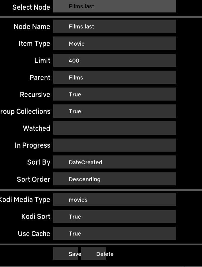

Nastream 5 Posted December 20, 2021 Posted December 20, 2021 Hello, when I activate the cache for the custom node, the "Next Pages" menu , disappears after a while. this does not happen when the cache option is on "false" it is not immediate, it disappears after a certain time, to find the Next Page button, I can empty the cache and it appears Thank you

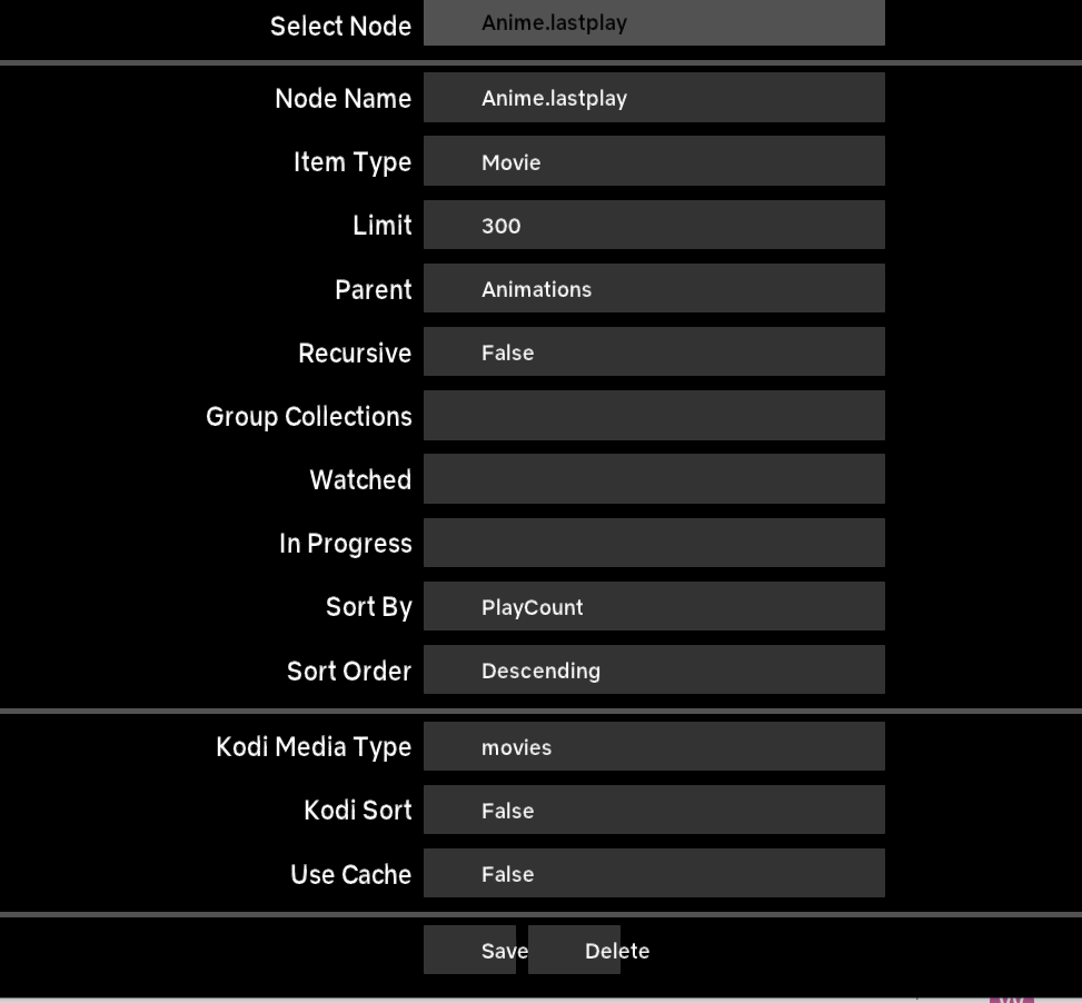

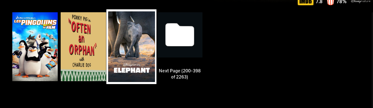

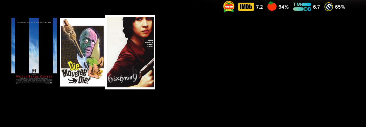

Nastream 5 Posted December 23, 2021 Author Posted December 23, 2021 Hello, here is the screen when film is in true here the next button has disappeared with animation cache on false the next page button is active My log Thank you @TeamB kodi.log
TeamB 2440 Posted December 23, 2021 Posted December 23, 2021 (edited) The limit here on the custom nodes is not set up to give you pages. It is to limit to say the top 20 unwatched items in your system so you can use it in a home screen widwet. If you want pages you need to set that in the interface settings in the addon settings. If you remove the limit in the custom node does the next page button show? Edited December 23, 2021 by TeamB
Nastream 5 Posted December 24, 2021 Author Posted December 24, 2021 hello, I deleted the limit but the button is not displayed the only way is to clear the cache there it appears well
