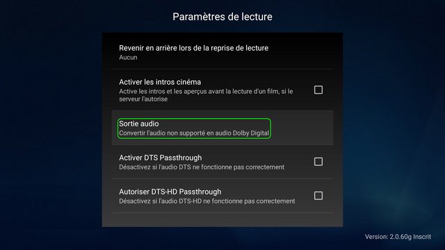

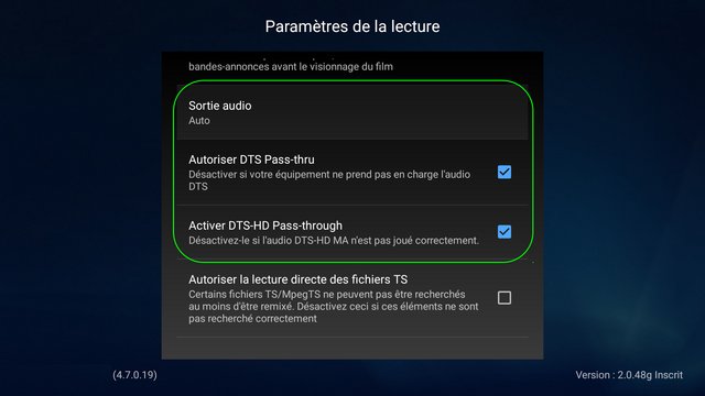

Satanasss 11 Posted December 21, 2021 Author Posted December 21, 2021 I was only able to try yesterday. In fact it was due to a bad configuration on my part. By uninstalling then replacing with the betas I incorrectly configured this option and the conversion was done via the Emby Server (my PC), which is not good in my case: While I needed to output audio: Either "Auto": Passtrought or Conversion from Shield Or : "Auto" + Passtrought for audio tracks In these configurations, either it is in Pass-Trough (direct audio), or it is the Shield TV which decodes (Soft). I have put some screenshots, it may be useful for other people who would encounter the same problems while reading.
