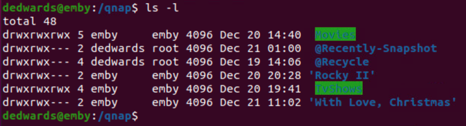

mudbaby 2 Posted December 20, 2021 Author Posted December 20, 2021 Hello Luke I got this issue resolved by installing nfs-kernel-server on the ubuntu server. So i was now able to mount the qnap share to the folder on the ubuntu and set the default recording to this folder. I changed owner and group as you see below. The problem is now i can not see the files in the folder I rescanned this and still nothing is showing up. It shows and nothing found. Any idea on this. Thanks

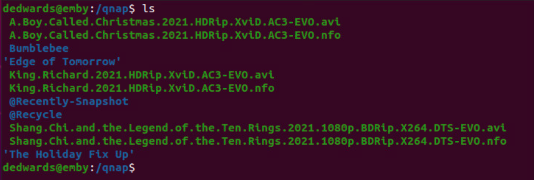

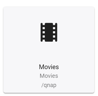

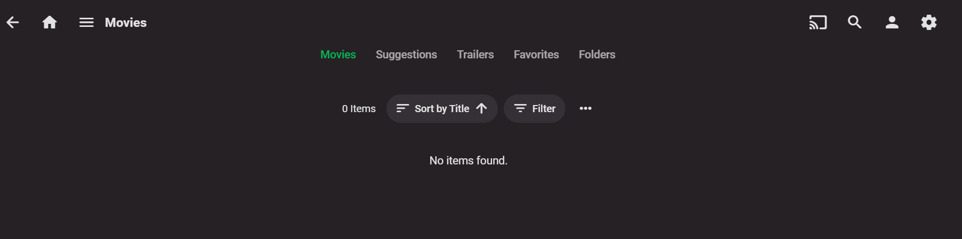

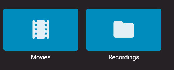

mudbaby 2 Posted December 21, 2021 Author Posted December 21, 2021 (edited) Hello, So i have removed the two paths /qnap/Movies and /qnap/TvShows from live tv section. I have the default recording path for live tv to only /qnap. I have added a library for movies and pointed it to the /qnap folder which is where the recordings also go. If it go to that folder in the terminal is see all the files in the /qnap folder. When i go to Home My Media in the emby browser and click on the Movies Library there is nothing displayed but when there are files in the actual folder. I did some recordings from live tv and they show in the folder in the terminal But they do not show in the Movies Library or the Recordings. Would be nice to get this working. Any suggestions on this. I would run this on my QNAP but when i install the emby server on the qnap i do not get to see the guide but i do see the channels just not guide information and also there is no digital signature for the application not sure why emby does not sign the product. So that is why i have installed it on ubuntu 20.4.3 but on ubuntu i do not see the recordings on the movies . Thanks Dave Edited December 21, 2021 by mudbaby
