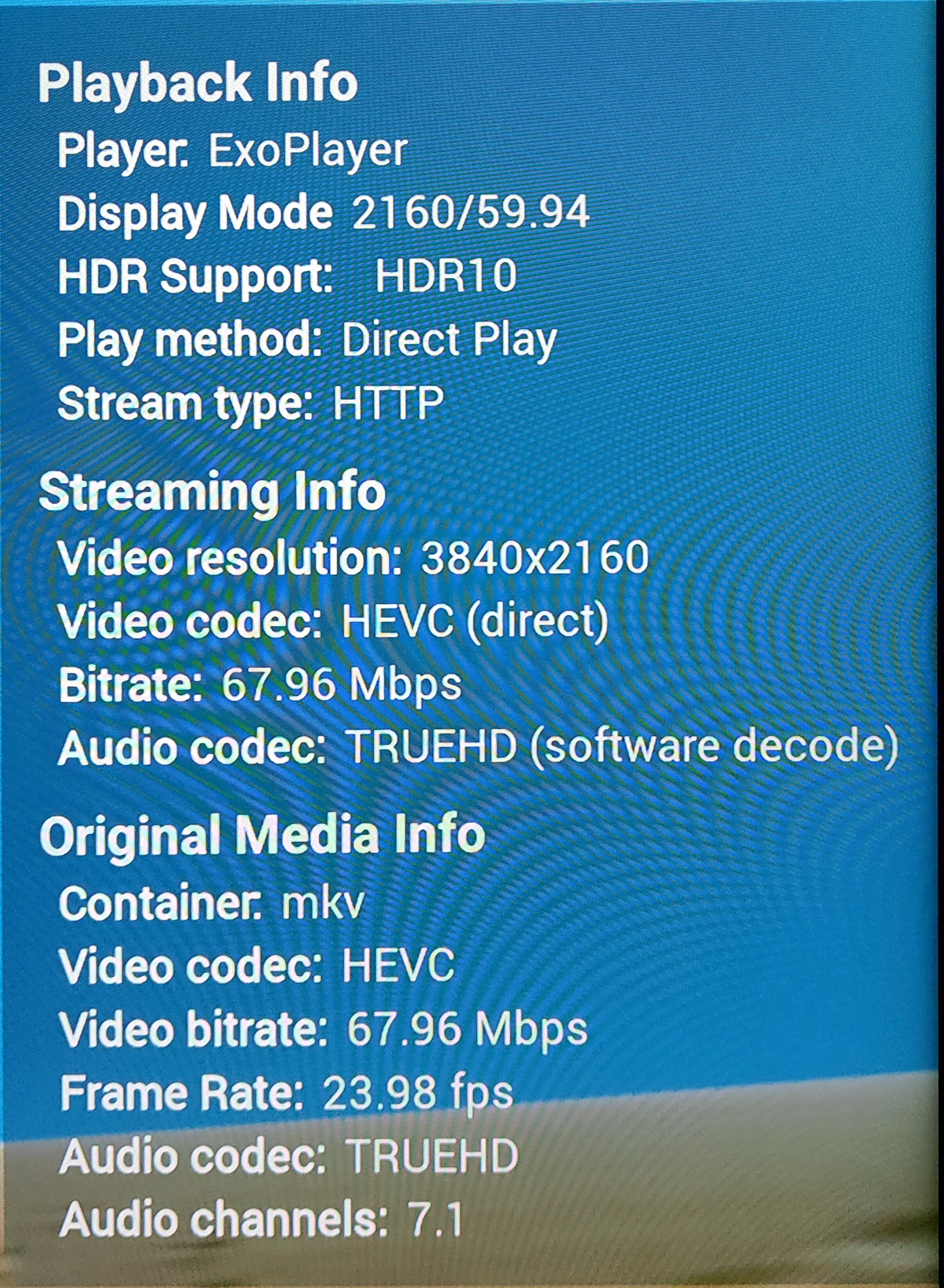

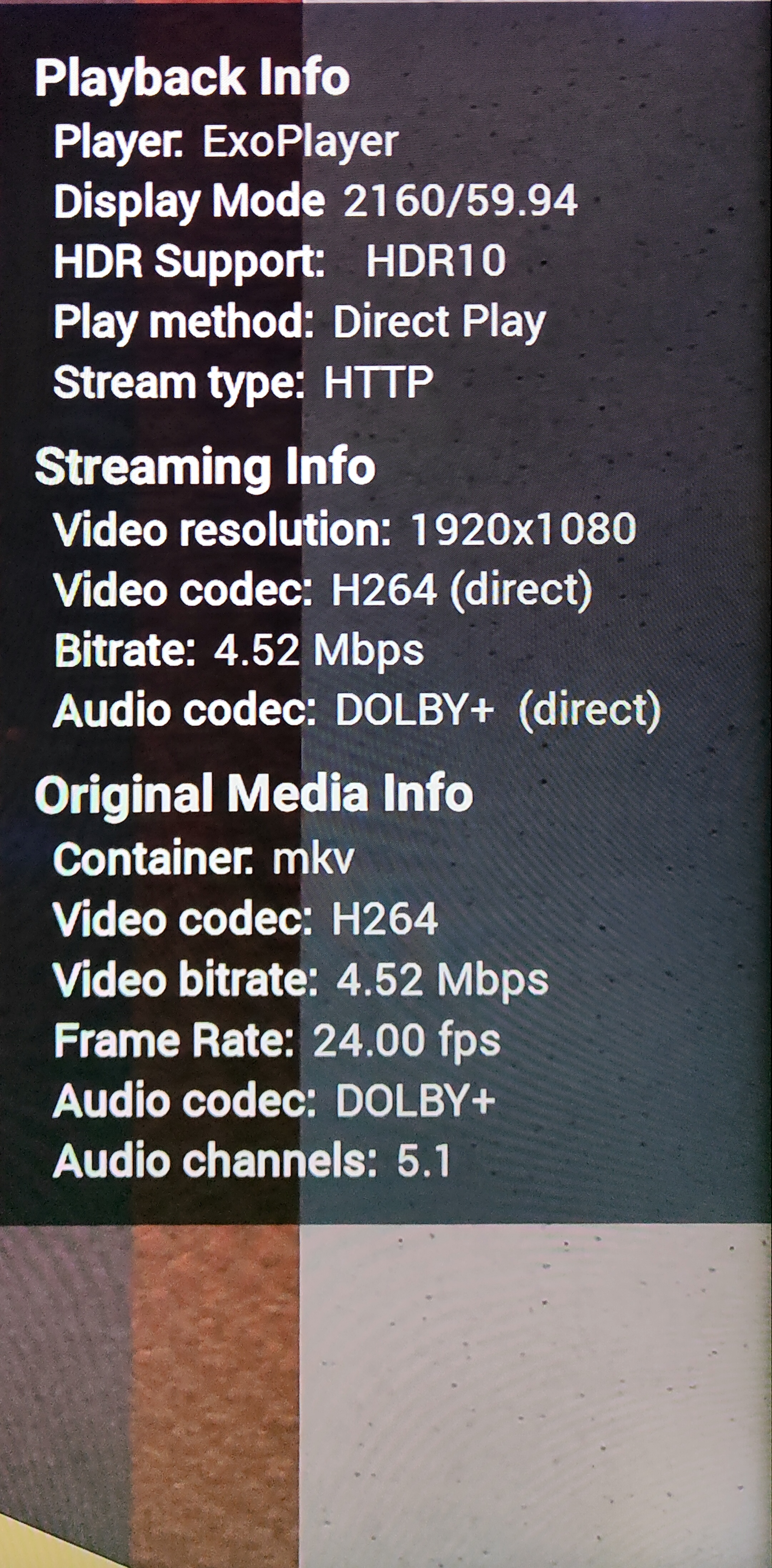

judgey 13 Posted December 19, 2021 Posted December 19, 2021 Hey, I'm on shield pro and just got a new sound bar with Atmos, so been looking at stats for nerds and I noticed this in the pictures below. It says software decode on one and on the other direct. The one that's decoding is the Atmos while the other is Dolby+. Why and what difference would it make, would I loose sound quality when it's decoding or will it not matter? thank you
ebr 16337 Posted December 19, 2021 Posted December 19, 2021 Hi. "Atmos" is not an actual audio format. It is a layer on top of one and it can be on top of either DD+ or TrueHD. Your system supports DD+ but not TrueHD - therefore we are decoding it in the app.

rbjtech 5344 Posted December 20, 2021 Posted December 20, 2021 You are losing both quality and Atmos if you are decoding to Dolby Digital. The only way to retain Atmos if using a sound bar that does not support True-HD Atmos (and eARC) is to use Dolby Digital Plus - which is what the 2nd example is using. Given the bitrate of the first example (67Mbit/sec), I assume this is a UHD Rip - and thus the expectation is you have the proper equipment to play it - it therefore is unlikely to have a Dolby Digital Plus (DD+) soundtrack. If it has a native Dolby Digital (non Plus) Soundtrack (could be labelled as AC3) - then that is preferable (quality wise) to letting emby decode the True-HD. Audio Codecs are a minefield - and we haven't even touched on DTS yet ...
