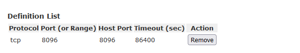

Chyron 256 Posted December 17, 2021 Posted December 17, 2021 (edited) I can't access Emby on my NVidia Shield TV or the Emby app on my Android phone. I also tried accessing Emby from multiple browsers on my phone, using both the appropriate local IP and the remote IP, but it just times out. I checked my router to confirm that port forwarding is set up correctly. Also, the competition seems to be working fine. Server log is attached. embyserver.txt Edited December 17, 2021 by Chyron
Solution Happy2Play 9802 Posted December 17, 2021 Solution Posted December 17, 2021 To me that suggests a firewall issue on host as that is the only thing that should block other LAN clients. 1 1
Chyron 256 Posted December 18, 2021 Author Posted December 18, 2021 (edited) 7 hours ago, Happy2Play said: that suggests a firewall issue on host That's exactly what it was. I deleted all the firewall rules for Emby Server. Then I exited and started Emby Server again and Windows Defender prompted me for network permissions. Now it's working fine. Edited December 18, 2021 by Chyron
