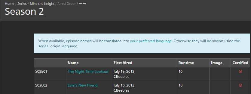

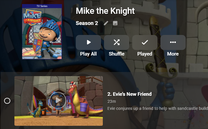

MBSki 1115 Posted December 17, 2021 Posted December 17, 2021 I can't figure out why Emby is skipping the 1st episode of season 2 for Mike the Knight. I've tried taking the show out of the library, rescanning and then putting it back in, but episode 1 just won't show up. It's in tvdb with a date, but it still won't show up.

Happy2Play 9802 Posted December 18, 2021 Posted December 18, 2021 2 hours ago, mbarylski said: @Happy2Play You've been able to explain these metadata issues to me in the past, any idea what's going on here? Can you show structure and naming scheme? Just to be sure what server version and library metadata downloader order.
Happy2Play 9802 Posted December 18, 2021 Posted December 18, 2021 15 hours ago, Ronstang said: I spend a lot of time reconciling my library and deleting episodes I actually already have.....time emby should be using, not me. But most issue are from mismatching guide data to actual provider data is my understanding. Cartoons are the worst as they are usually double episodes or naming in this cause. Same episode different online sources. "Mike the Knight" Mike the Knight and the Big Parade/Mike the Knight and Sparkie's Amazing Thing (TV Episode 2012) - IMDb Mike the Knight and the Night Time Lookout - TMDB The Night Time Lookout - TheTVDB.com

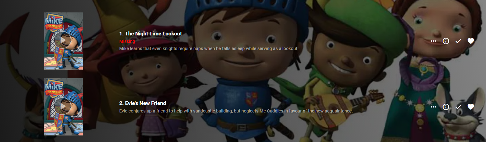

Happy2Play 9802 Posted December 19, 2021 Posted December 19, 2021 8 minutes ago, mbarylski said: Well that's interesting. How the heck do I fix that? I thought the point of ordering the metadata providers was so it would pick from the first one on the list FIRST? Why would it starting pulling from the 2nd one on the list? Here are my settings. Well there would have to be failure on first provider or missing metadata in order to pull from second provider. Removed episode 1 and ensured Missing options were enabled.

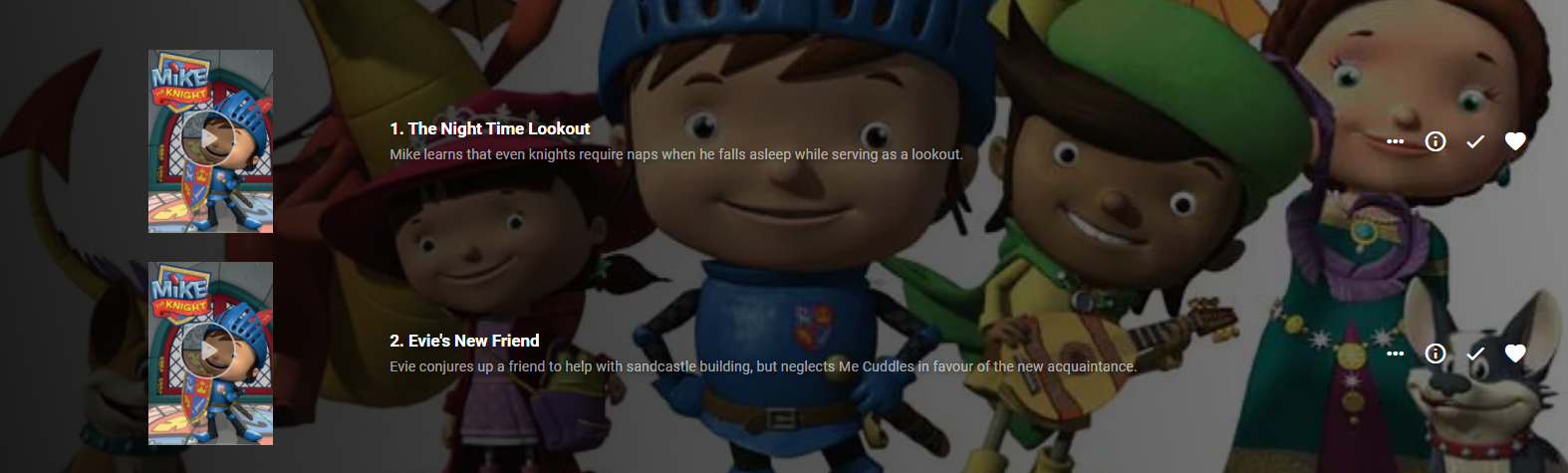

Happy2Play 9802 Posted December 19, 2021 Posted December 19, 2021 2 minutes ago, mbarylski said: How did you remove episode 1? Maybe I'll just throw a dummy episode 1 in there and see if that works. Btw, what client are you using? I see that "missing" is red in your screen shot, but I lost red a long time ago in the web and Android app. First screenshot I had dummy files for 2x01 and 2x02, then deleted 2x01 to show Missing in screen two. As for color it is custom css in web client.
MBSki 1115 Posted December 20, 2021 Author Posted December 20, 2021 On 12/18/2021 at 10:17 PM, Happy2Play said: First screenshot I had dummy files for 2x01 and 2x02, then deleted 2x01 to show Missing in screen two. Thanks. That seemed to work for a little while, but after a refresh metadata 2x01 disappears again. I even locked it and it still went away. How do you make it stay in there without disappearing on each refresh or scan? On 12/18/2021 at 10:17 PM, Happy2Play said: As for color it is custom css in web client. Wasn't it red before without custom css? I know it was red in one of the apps. Not sure why the color was removed.
