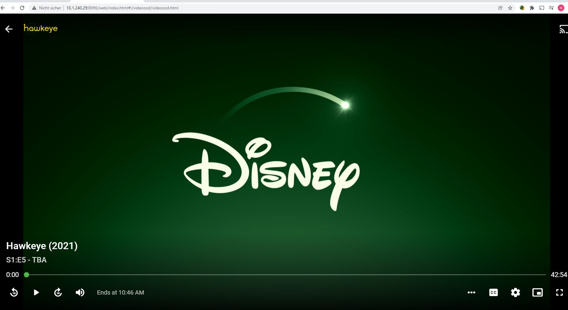

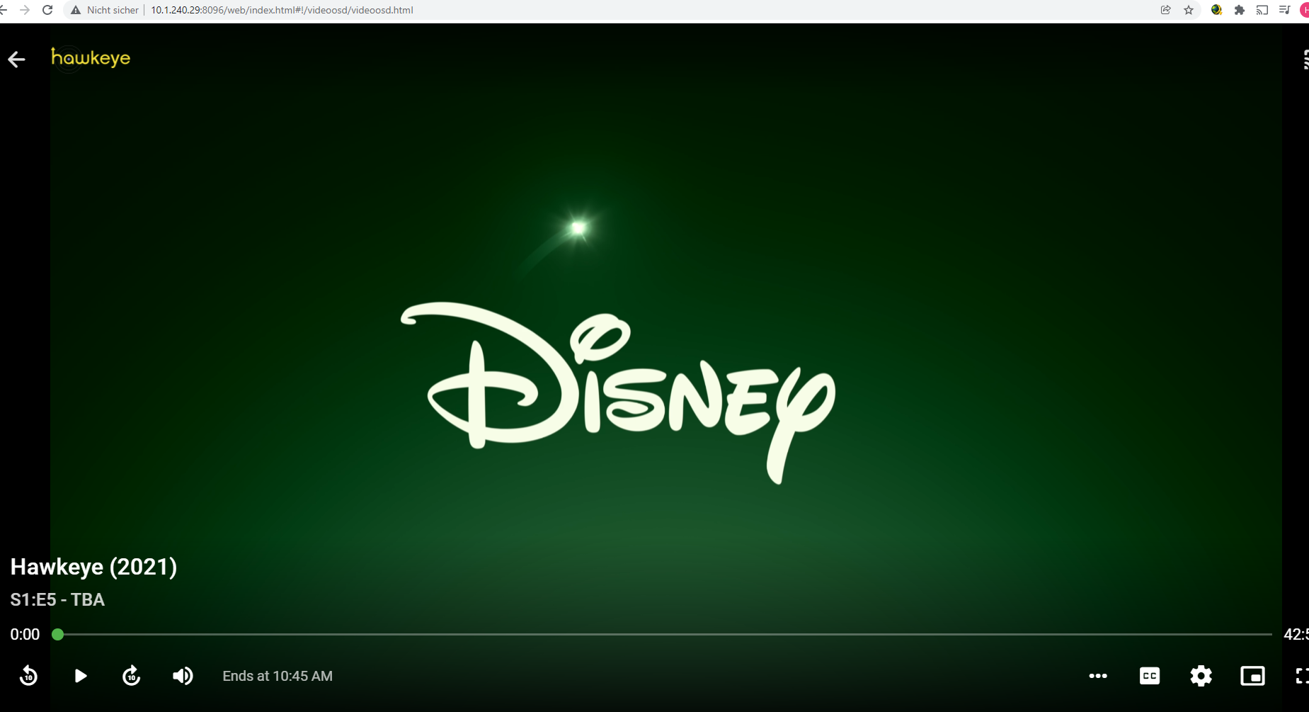

horfic 0 Posted December 16, 2021 Author Posted December 16, 2021 Hi, I'm having issues with Dolby Vision files on the emby server. When viewing it per any device, the colors are always off, independently of the device. Tried tone mapping option on and off. It also appears that quiet often the sound just stops and gets back and skipping is working most of the time not correctly. The tests with tone mapping on and off are from 2021-12-16 10:02:31 and 2021-12-16 10:03:35. Source is an H.265 dvhe source with planar 4:2:0 yuv 10-bit le decoding. PS: My LG with the emby app is recognizing the dolby vision content as its shows it per popup. can anybody suggest a fix for that? cheers, Horfic emby-log.zip

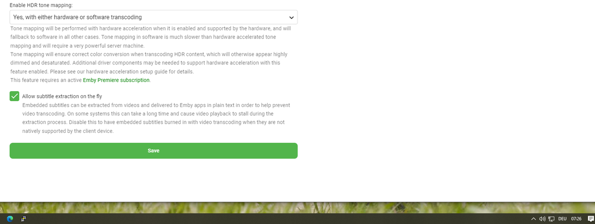

Luke 42246 Posted December 16, 2021 Posted December 16, 2021 13 hours ago, horfic said: Done. tested again at 10:37:19 and 10:37:57 with tone mapping on and off. same result. emby-log.zip 129.18 kB · 0 downloads Hi, it doesn't look like you have tone mapping enabled. Can you please try again?
horfic 0 Posted December 17, 2021 Author Posted December 17, 2021 (edited) hi, yes it was, at least the settings told me the change was saved for the second timestamp but ok. here again, only with tone mapping tried at 07:26:25 no change emby-log.zip Edited December 17, 2021 by horfic
softworkz 5133 Posted December 28, 2021 Posted December 28, 2021 I'm afraid, but there's neither a fix nor a solution for that. There are various flavors (profiles) of Dolby Vision and with Emby, we can only support those with tonemapping which are backward-compatible to HDR10. Whenever you see DVHE, like here: you'll know that Emby cannot handle this in transcoding, only when playing directly.
