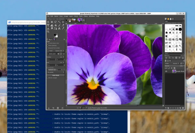

Carlo 4561 Posted December 16, 2021 Posted December 16, 2021 OK I was going to say this is pretty easy to do with PIA. Glad you got it working! Depending on your computer, I would think about or try setting up a VM. A headless Linux server install running in a VM in hyper-v on windows would make this a lot easier to use and would only need 1 GB of memory. You could also do this another way but similar on Windows 10+ by installing WSL 2 backend. It's made to allow you to run docker and Linux based docker instances on windows but even if you have no interest in the docker part it integrate Linux right into Windows. https://docs.docker.com/desktop/windows/install/#system-requirements Check out the Windows app store "linux developer tools" and you will see free Linux distros meant for installing right into Windows. GIMP running on Windows Desktop Audacity minutes after doing a "sudo apt-get install" from a PowerShell prompt. Yep from PowerShell. It's so cool to be able to use Linux command in windows now! The cool part about this is that even though I now have use of these programs on the Windows desktop they run in their own VM like container where a VPN could run affecting only those programs. Pretty close to being an ultimate desktop this way as you get the best of both worlds blended together. It's only going to get better as well. WSL2 was a major improvement and the next version will likely blur the lines even more. Memory foot print is pretty small as well. Just thought I'd mention that in case you've never seen or heard of WSL before. 1
