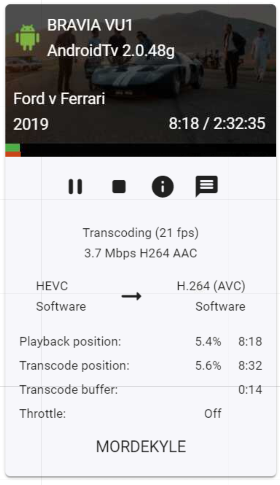

MordeKyle 3 Posted December 16, 2021 Posted December 16, 2021 I have a Sony Bravia android TV that has been excellent. I used to watch 4K on it all the time, and now I can't. I'm not sure why that would change. I don't have a good enough graphics card to transcode 4K, never have, yet I used to watch 4K episodes of show and movies all the time. Now, when I try to watch those same exact shows or movies, it's transcoding and stutters really bad and only plays at around 8fps. The Stats for Nerds indicates it's transcoding. I never looked before to see what was going on, because it played the 4K files flawlessly.

MordeKyle 3 Posted December 16, 2021 Author Posted December 16, 2021 (edited) 48 minutes ago, Luke said: Hi there, what does stats for nerds list as the transcoding reason? Conversion Reason <Unknown> ETA: Info from Active Devices Edited December 16, 2021 by MordeKyle

Luke 42245 Posted December 16, 2021 Posted December 16, 2021 OK our Android TV app thinks the video resolution is not supported. @ebr can look into this. Thanks.,

Solution ebr 16337 Posted December 17, 2021 Solution Posted December 17, 2021 Hi. Can you please test this with the beta version of the app? I think we may have already addressed this. Thanks.
MordeKyle 3 Posted December 17, 2021 Author Posted December 17, 2021 2 hours ago, ebr said: Hi. Can you please test this with the beta version of the app? I think we may have already addressed this. Thanks. On the Beta version and it's playing direct. Awesome. Thanks. 1 1
