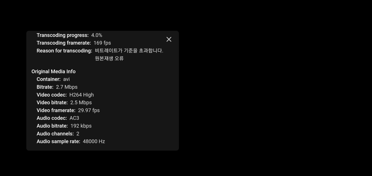

tinywait 3 Posted December 16, 2021 Author Posted December 16, 2021 - another error Infinite loading without starting video (Quality 2Mb/s Over) Fail to play -> SendLog ID : mi / 2021.12.16 17:59(UTC+9) same video file (Quality 2Mb/s) play success -> SendLog ID : mi / 2021.12.16 18:06(UTC+9)

tinywait 3 Posted December 16, 2021 Author Posted December 16, 2021 (edited) These are different errors. (I can't speak English, so I translated it with a translator, so please understand.) 1. Too many errors. Give up. Error message play stop : SendLog ID : mi / 2021.12.17 04:47(UTC+9) (Posting again with incorrect log time) 2. Video not playable(but playing is successful at Quality 2Mb/s or less) : SendLog ID : mi / 2021.12.16 17:59(UTC+9) (What is the source of the file? -> http://gofile.me/6xnVU/HGrSTQ2Xs ) Edited December 16, 2021 by tinywait

tinywait 3 Posted December 22, 2021 Author Posted December 22, 2021 2. Video not playable(but playing is successful at Quality 2Mb/s or less) : SendLog ID : mi / 2021.12.16 17:59(UTC+9) (What is the source of the file? -> http://gofile.me/6xnVU/HGrSTQ2Xs ) ---> This file is an old entertainment TV show file, and it was downloaded from the Internet. And this file is different from Too many errors. Give up Error Message. This file error also occurred in the external player MX Player (H/W codec). MX Player(S/W codec) was played. With the Emby ATV app (Beta) built-in player, if play with Quality 2Mb/s or less, it will be played. Anything more than that will fail. ----- 1. Too many errors. Give up. Error message play stop : SendLog ID : mi / 2021.12.17 04:47(UTC+9) (Posting again with incorrect log time) ---> Was the error log sent successfully?

ebr 16337 Posted December 22, 2021 Posted December 22, 2021 12 hours ago, tinywait said: 2. Video not playable(but playing is successful at Quality 2Mb/s or less) : SendLog ID : mi / 2021.12.16 17:59(UTC+9) (What is the source of the file? -> http://gofile.me/6xnVU/HGrSTQ2Xs ) ---> This file is an old entertainment TV show file, and it was downloaded from the Internet. And this file is different from Too many errors. Give up Error Message. This file error also occurred in the external player MX Player (H/W codec). MX Player(S/W codec) was played. With the Emby ATV app (Beta) built-in player, if play with Quality 2Mb/s or less, it will be played. Anything more than that will fail. ----- 1. Too many errors. Give up. Error message play stop : SendLog ID : mi / 2021.12.17 04:47(UTC+9) (Posting again with incorrect log time) ---> Was the error log sent successfully? Hi. Yes, that would confirm that the video is created in such a way that the internal decoders on the device cannot play it. If you can remux or reencode the file, it may fix it. Or you can force a transcode on the server as you did with the bitrate.
