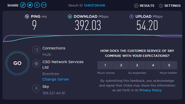

mattykellyuk 18 Posted December 14, 2021 Posted December 14, 2021 (edited) I am seeing a lot of of direct play errors that I didn't used to see and have an example to share. This happened last night. The server was busy encoding so using 100% of cpu, could this be a factor? A remote connection attempted to play a small file on a modern fire stick (that I know can direct play this file). It errored, saying bitrate was too high, then transcoded the file to double or more the bitrate of the file. See files attached for the mediainfo of the file, the log and a speed test I ran on the server while this error happened. I am also seeing errors where the server just says direct playback error without the explanation here that the bitrate was too high. As well as users reporting that is sometimes it takes a long time for emby to start playing a file even though the server reports it playing. The video will start but takes about 30 seconds even on small files with both the server and user on full fibre bb. I run the server on a win10 machine, to my domain using cloudfare. Any other info you need please let me know and I will keep an eye out to try and get more examples. Thanks for your time. ffmpeg-transcode-217d0aba-0b20-4dd1-ab06-0f170e6ce076_1.txt mediainfo.txt Edited December 14, 2021 by mattykellyuk

mattykellyuk 18 Posted December 14, 2021 Author Posted December 14, 2021 Hi @cayars. Thanks for the suggestion. I can confirm the user does have a limit but 7mbps where this file is about 2. There is also no restriction on the general network limit. Luckily I had a similar situation just now and a compliant user. This time on a samsung TV. I asked them to move the quality setting from auto to 60mbps. It didn't help. Any other ideas? Thanks again.

mattykellyuk 18 Posted December 15, 2021 Author Posted December 15, 2021 6 hours ago, RanmaCanada said: Even if they manually set the bitrate to something higher, it's possible the connection would be so bad that the server will over ride it after it determines that the connection setting is invalid. Though I can not see the usual "media exceeds bitrate" reason in your log. I didn't think this was an option with my upload speed (above) and the knowledge of the users download speed being at least 30meg.

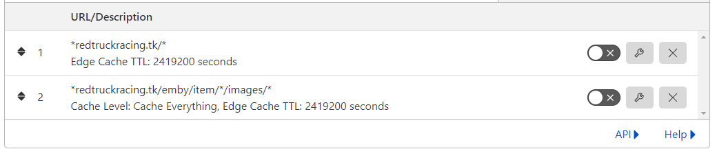

mattykellyuk 18 Posted December 15, 2021 Author Posted December 15, 2021 Sorry. These are the settings I can see around caching. I have turned them off and will see what happens.
Carlo 4561 Posted December 15, 2021 Posted December 15, 2021 (edited) Those rules are not correct and can get you booted. Do not let them cache your videos as it's strictly against their TOS. You need to have a bypass for video. These are setting I use and set people up with and have been working well. They need to be in this order so when entering them work bottom up or re-arrange the order once all 3 are entered. Fix/change the rules and turn them back on ASAP. domain.ext/*videos/*/* Cache Level: Bypass Enabled domain.ext/*/ Cache Level: Cache Everything, Edge Cache TTL: a month Enabled domain.ext/* Edge Cache TTL: a month If you ever need to check to see if CF is causing a problem don't touch your rules but instead turn on debug mode which bypasses their processing. Edited December 15, 2021 by cayars

mattykellyuk 18 Posted December 15, 2021 Author Posted December 15, 2021 2 hours ago, mattykellyuk said: Thanks very much. Is the below check? I couldn't see the 'Enabled' bit. Could this be causing my problems? These are the settings I have in CF as advised by @cayars. Anyone know if there are further cache options in CF?
Carlo 4561 Posted December 15, 2021 Posted December 15, 2021 That just means it works for me, but no guarantee it will work for you. I'm not using Cloudflare through nginx if that makes a difference to your setups. Log into CloudFlare and turn on Debug mode. Then try playing back the same media and see what happens. It's quite possible CF changed something globally or regionally that could give different results. If you get better results try test #2 by clearing/purging the cache on Cloudflare and then turning debug mode back off. Wait 5 minutes and try playing back the media again. One thing to keep in mind with any type of proxy be it software you update running in your LAN or using a service like Cloudflare. Things change that you don't know about and have to play catch up to figure it out and remedy it. Over the years we have had to update/change Cloudflare configs a number of times. Once was only a month or two ago.
mattykellyuk 18 Posted December 15, 2021 Author Posted December 15, 2021 (edited) 12 minutes ago, cayars said: That just means it works for me, but no guarantee it will work for you. I'm not using Cloudflare through nginx if that makes a difference to your setups. Log into CloudFlare and turn on Debug mode. Then try playing back the same media and see what happens. It's quite possible CF changed something globally or regionally that could give different results. If you get better results try test #2 by clearing/purging the cache on Cloudflare and then turning debug mode back off. Wait 5 minutes and try playing back the media again. One thing to keep in mind with any type of proxy be it software you update running in your LAN or using a service like Cloudflare. Things change that you don't know about and have to play catch up to figure it out and remedy it. Over the years we have had to update/change Cloudflare configs a number of times. Once was only a month or two ago. of course. I hope I didn't sound ungrateful. I appreciate your help. I can't seem to find the debug options, whereabouts is it in CF? Edit: I enabled development mode and seems better! Edited December 15, 2021 by mattykellyuk
Carlo 4561 Posted December 15, 2021 Posted December 15, 2021 OK that's good as it seems you've found the issue. Of course it may not be Cloudflare but a reverse proxy issue if you're running nginx. Running any reverse proxy? I would say the next step you want to do is compare your settings to these: If running nginx compare to these as well: Let us know if you found any differences and if so how retesting goes when you turn off debug mode. 1
