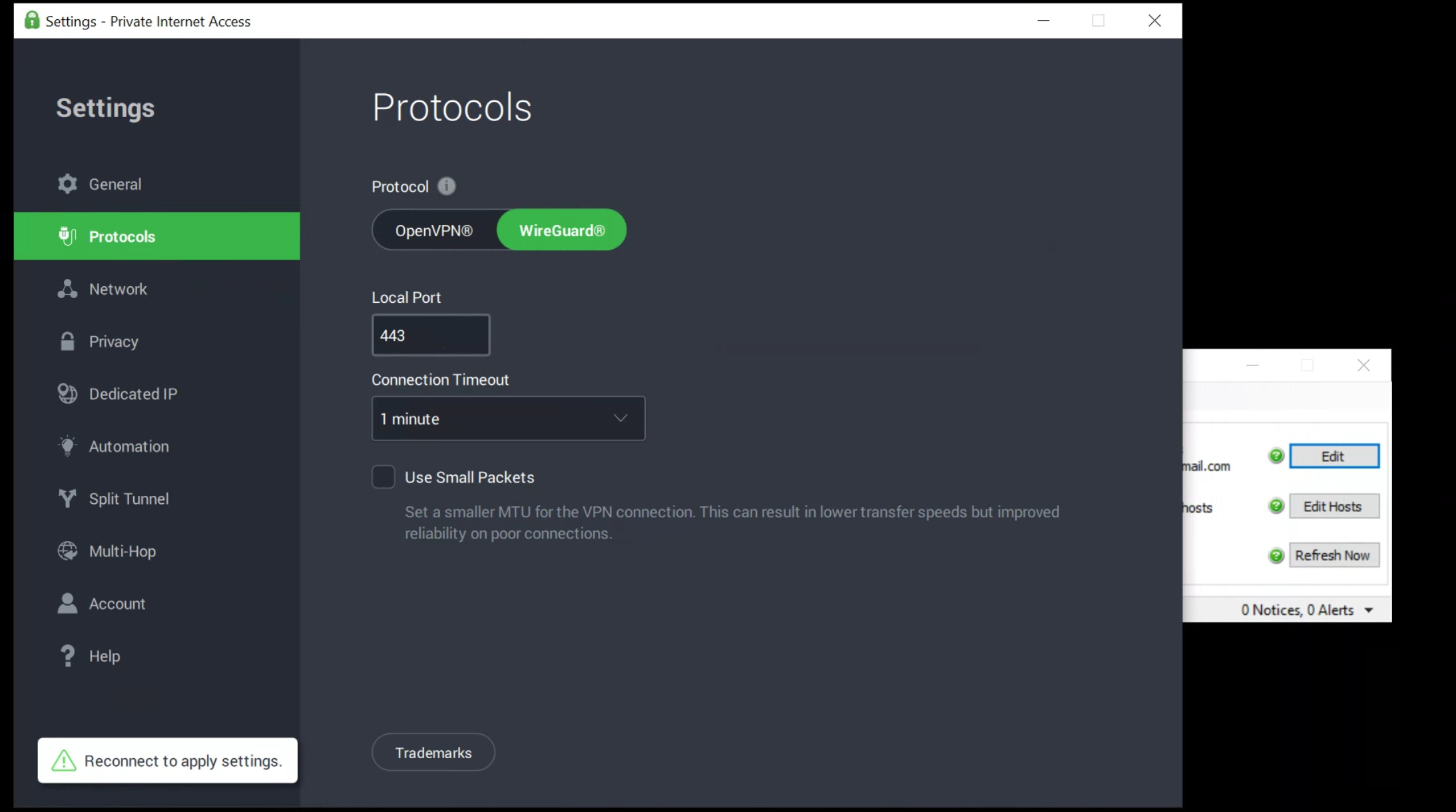

TurnerJo 0 Posted December 13, 2021 Posted December 13, 2021 Hello all, I have been trying to get Emby running behind a VPN (Private internet access) however every set up i have tried doesnt seem to work. Iam running emby version 4.6.7.0 and PIA version 3.1.2 running on windows 10. I have remote connections routed as a url to a ddns service (no-ip) which then points to the ip address given by the pc, this set up works fine with original ISP given IP address. I have: 1. Diabled auto port mapping 2. PiA gave me a forwarded port of 41104. using their settings, i set 41104 to map to local 443 port (which emby uses, have tried both http and https) 3. Can ping the port using ncat using http and gives a response 4. Trying to connect to emby via app / url or manual IP doesnt do anything. Please can you advise or let me know if you require further information

Carlo 4561 Posted December 15, 2021 Posted December 15, 2021 No that doesn't apply. To use any VPN with Emby Server you will however have to do one of two things. First is using split tunneling which allow Emby Server to bypass the VPN and run as usual. The second way using the VPN would be to get port forwarding from the provider. When you think about it this makes sense because if 100 people are sharing an IP and traffic comes in where do they route it? They would have no idea. PIA does both split tunneling and port forwarding using OpenVPN or Wireguard included. They also have static IPs but that will cost about $10 a month and not worth it.
Carlo 4561 Posted December 15, 2021 Posted December 15, 2021 On 12/13/2021 at 4:39 PM, TurnerJo said: 2. PiA gave me a forwarded port of 41104. using their settings, i set 41104 to map to local 443 port (which emby uses, have tried both http and https) Don't try and forward the port they gave you. Instead set your port to 41104. If you have a cert then this will be the https and if not it will be the http port (guess you use this).

TurnerJo 0 Posted December 18, 2021 Author Posted December 18, 2021 @cayars I have tried using the 41104 port and no avail. when using canyouseeme it detects the port but no external connections can connect. Also i dont want to use split tunneling for the server. Any other suggestions?
