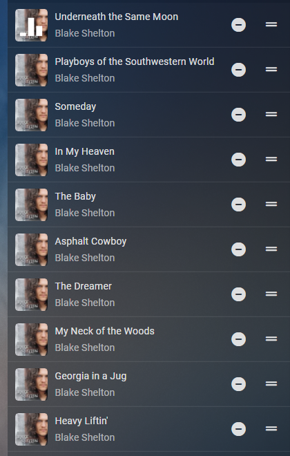

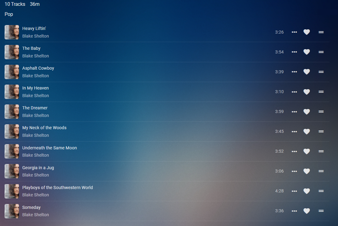

Happy2Play 9812 Posted December 13, 2021 Posted December 13, 2021 (edited) 10 minutes ago, instrumentally said: 2. Windows desktop, Edge web browser connecting to server via 1.2.3.4:8096, choose a playlist, and you will find the SHUFFLE button inactive. Just tested this and it shuffle plays the playlist. Default order Shuffle order Tested album m3u and Emby created playlist with same results in Edge on desktop. Edited December 13, 2021 by Happy2Play added update for m3u and Emby playlist
