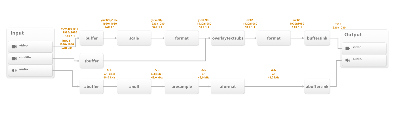

softworkz 5129 Posted December 11, 2021 Posted December 11, 2021 Thanks. The diagnostic options are not preserved on reboot. What's the difference between these log files now? One with green/pink and the other one OK? The are technically doing exactly the same, so there shouldn't be a difference.
NeverExists 21 Posted December 11, 2021 Author Posted December 11, 2021 (edited) 6 minutes ago, softworkz said: Thanks. The diagnostic options are not preserved on reboot. What's the difference between these log files now? One with green/pink and the other one OK? The are technically doing exactly the same, so there shouldn't be a difference. they were both there so I'm not sure but the latest one is for sure the one one that had the pink and green on the screen. Just so you know I have burn in ASS Subtitles checked in the nvidia shield app. Edited December 11, 2021 by NeverExists
softworkz 5129 Posted December 11, 2021 Posted December 11, 2021 Actually it's all pretty good now (besides the colors). It runs at 4.0x speed and the setup looks all good Lessons learned from this: when burning-in subtitles and the video is decoded in software, we shouldn't do the burn-in in hardware (after uploading both, video and rendered (transparent) subtitle frames). In my tests for this situation, I remember that I always had scaling involved, so the subtitle overlay frames were much smaller (generated and less data to upload). I'll change that for the next beta. The colors issue is something that I need to try to reproduce. Meanwhile, you could try two things: Disable hw acceleration Only the encoder is hw accelerated here Select the Nvidia H.264 instead of the QuickSync one (select "Advanced" for the hw acceleration, then you'll see the details)
