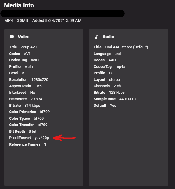

softworkz 5129 Posted December 11, 2021 Posted December 11, 2021 OK, thanks, that changes theories of course.. In both of the log files you have posted, you are playing H.264 files with High10 profile and a color format of yuv420p10. This is rarely used and not supported by most hardware decoders, so the decoding is happening in software and the decoded frames are then uploaded to hardware for burning-in the subtitles. Could you try an H.264 video with normal (8bit) color format (but ASS subs of course) and see how that compares?
softworkz 5129 Posted December 11, 2021 Posted December 11, 2021 You can see the color format in the media info at the bottom of the page:
